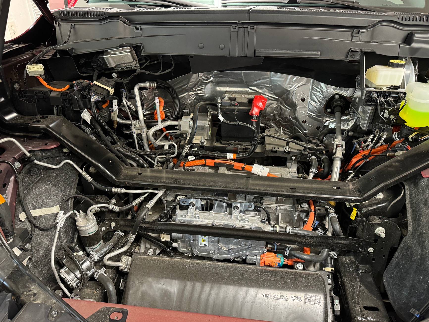

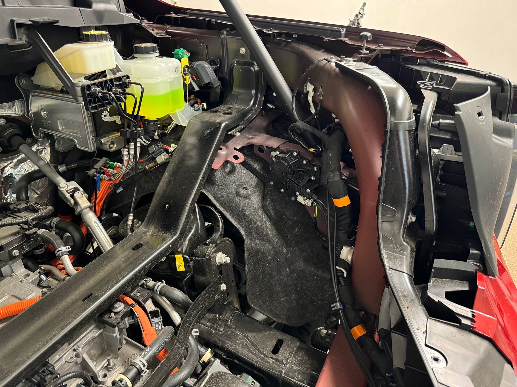

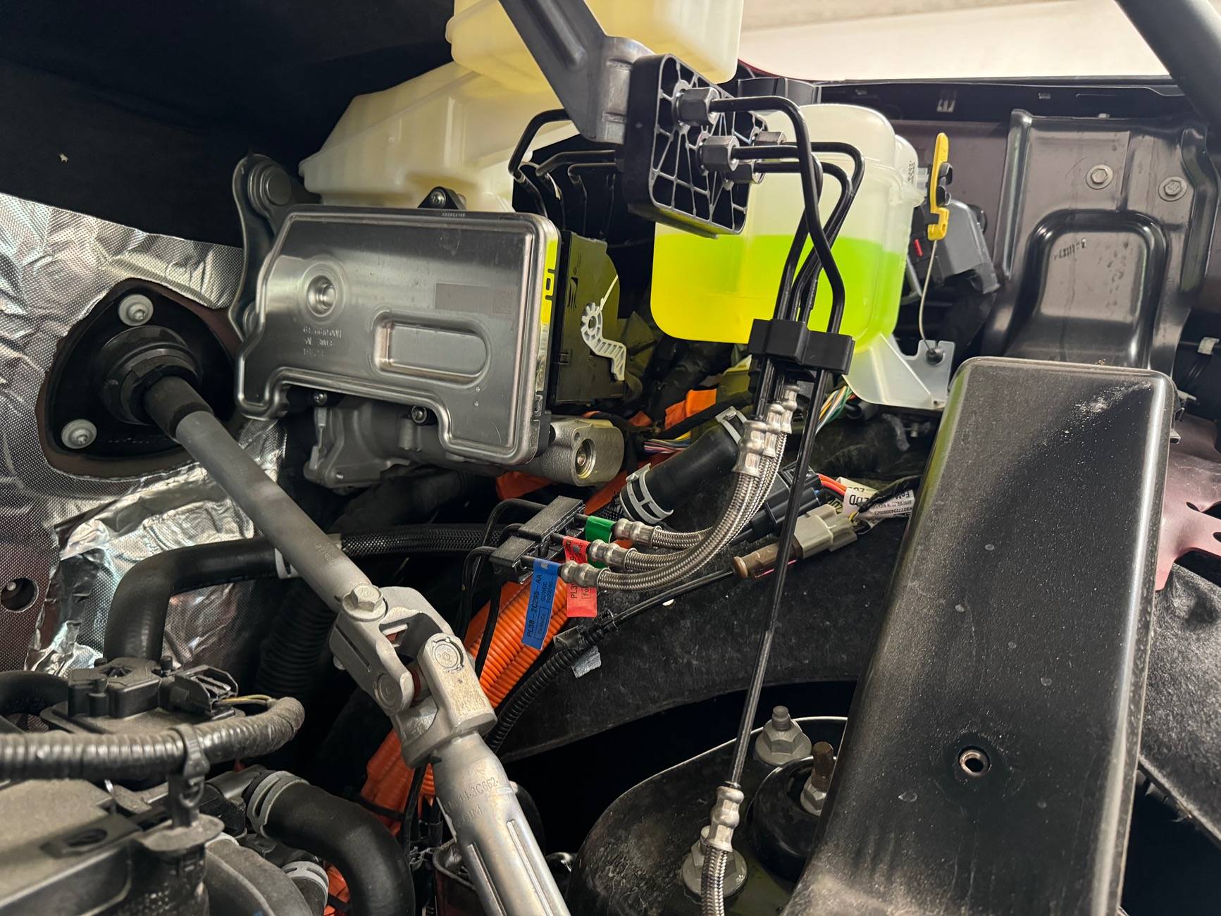

The frunk tub is fairly easy to remove. Only one electrical connection on passenger side. Easier with two people to pull it out just because it is so wide, but one person can do it.
On mine ('23 Lariat) the big metal crossmember bar was not attached to the tub. Even though I removed the two bolts on each side of crossmember bar, there was no need to. That made it a bit lighter and easier.
There are some good videos that show how to remove.
Here is what it looks like with the frunk tub out. Rat's nest is good description.
