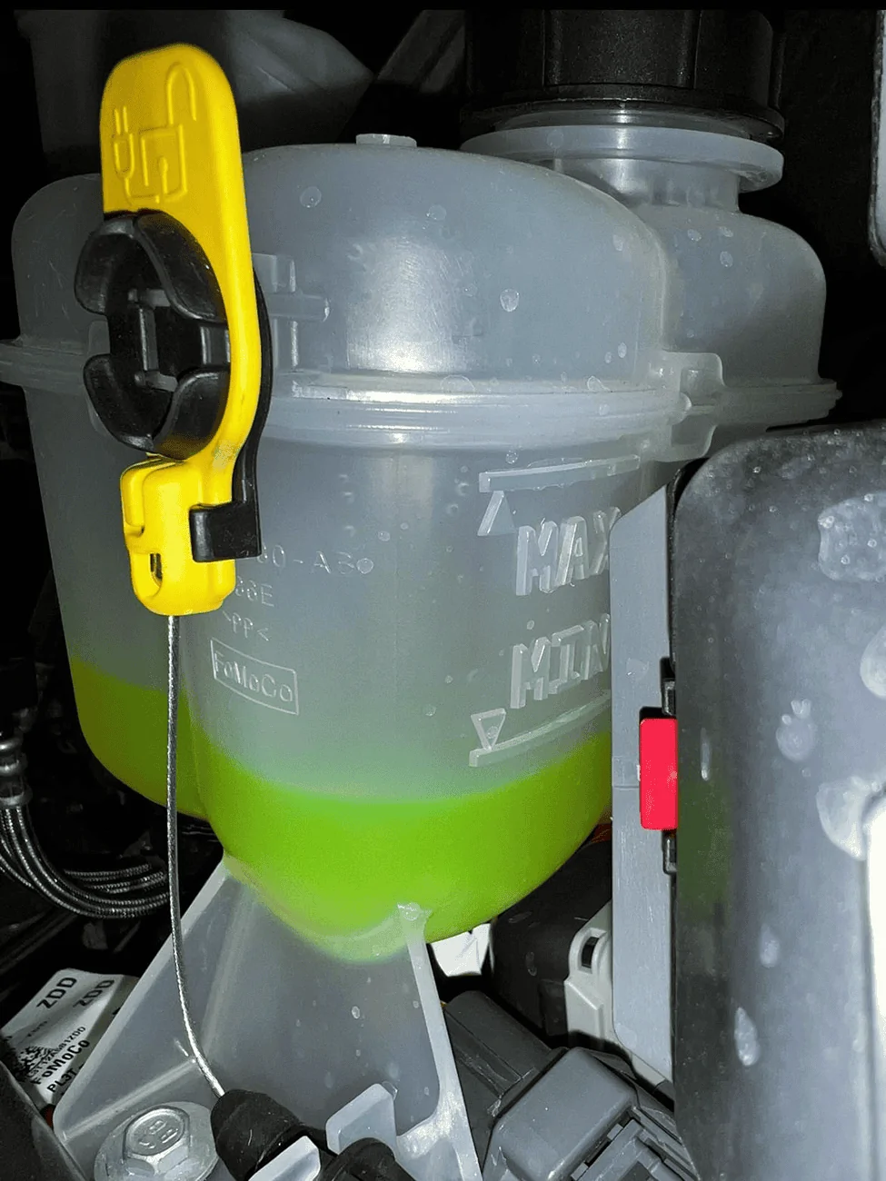

Well - I checked the coolant level and it was fine (a little above the minimum mark after sitting all night). If I hit the same issues going home tomorrow I will call my dealer and ask them to check this!
