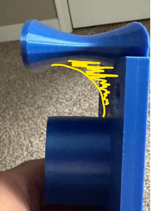

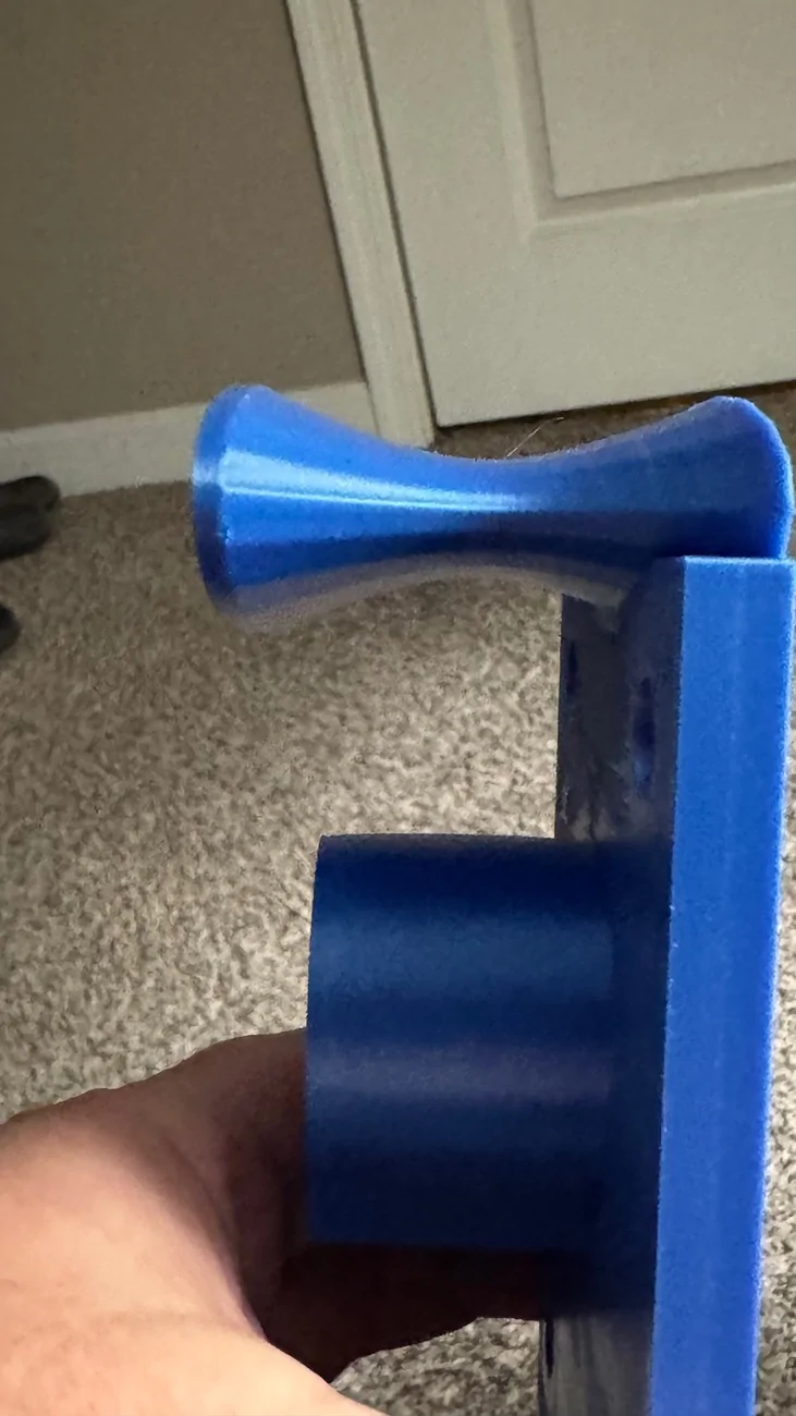

I suspect the "holder" will snap off in 2s, especially if it's printed flat, so you definitely want to look into reinforcing that part.

Possibly. It’s not flat though. I have been pulling on it to see how strong it is. Plus where I want to mount it I won’t be winding all the cord on it​

I think @mr.Magoo mean printing it flat on its back, resulting in the layer lines being in the same direction as the stressors from the cord. Maybe a curved support on the bottom of the holder would help strengthen it.

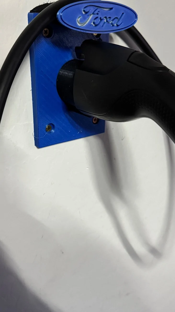

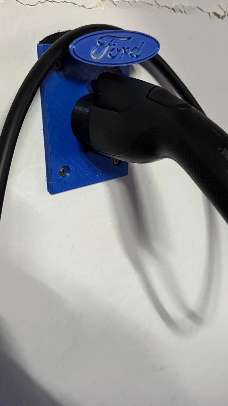

Excuse the crack in the drywall. Holder doesn’t weigh that much

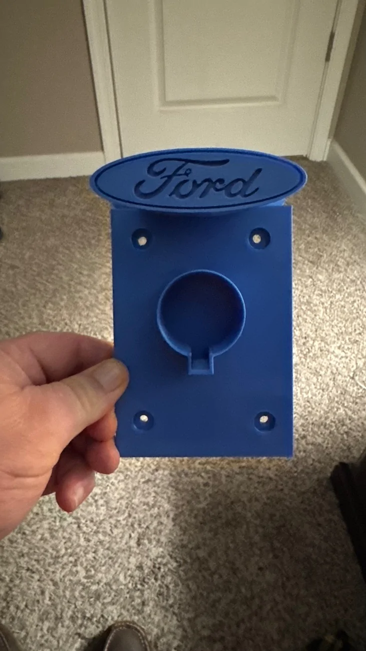

Not print one. First try. Not big enough. So back to the cad program but not too bad for first try

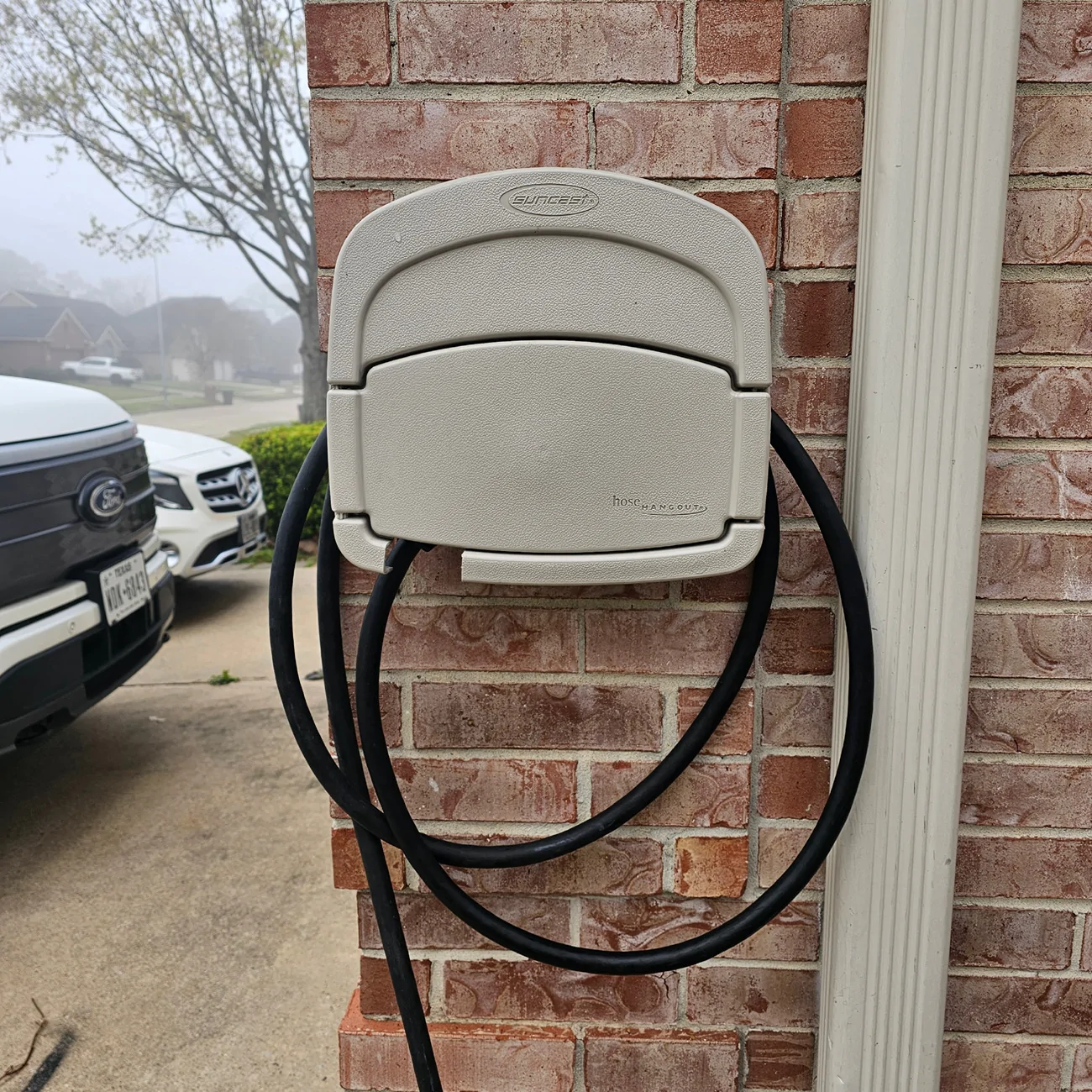

I do not have the luxury of parking in the garage where my FCSP is located, but i have enough cable to reach my truck out side , to remedy not having my cable lay around i bought this cheap water hose thingy with a center door which i cut out the bottom so i could put the handle inside when not in use or raining snowing etc
