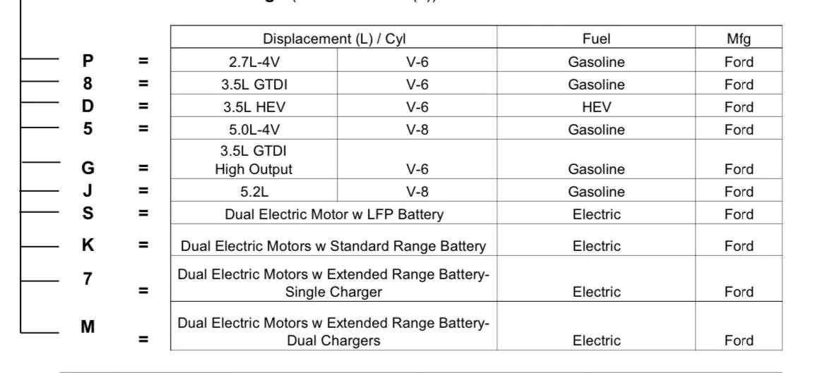

K is the 8th character, so your truck is a SR with NCM

Just to be clear you folks are correct my battery size or chemistry should have nothing to do with a trailer brake controller!
Here is my VIN 1FTVW1BK4RWG22510 and my sticker
https://fordauthority.com/2024/08/heres-how-to-tell-if-your-ford-ev-has-an-lfp-battery-video/
I n have asked the Dealer General Manager and the Service for the documentay8on
Ford did add the option to the VIN but as you say I haven’t heard of them actually building any trucks with LFP. A 5 in position 8 actually indicates a 5.0 liter V-8.
my VIN is this 1FTVW1BK4RWG22510

i do have a NCM battery.
