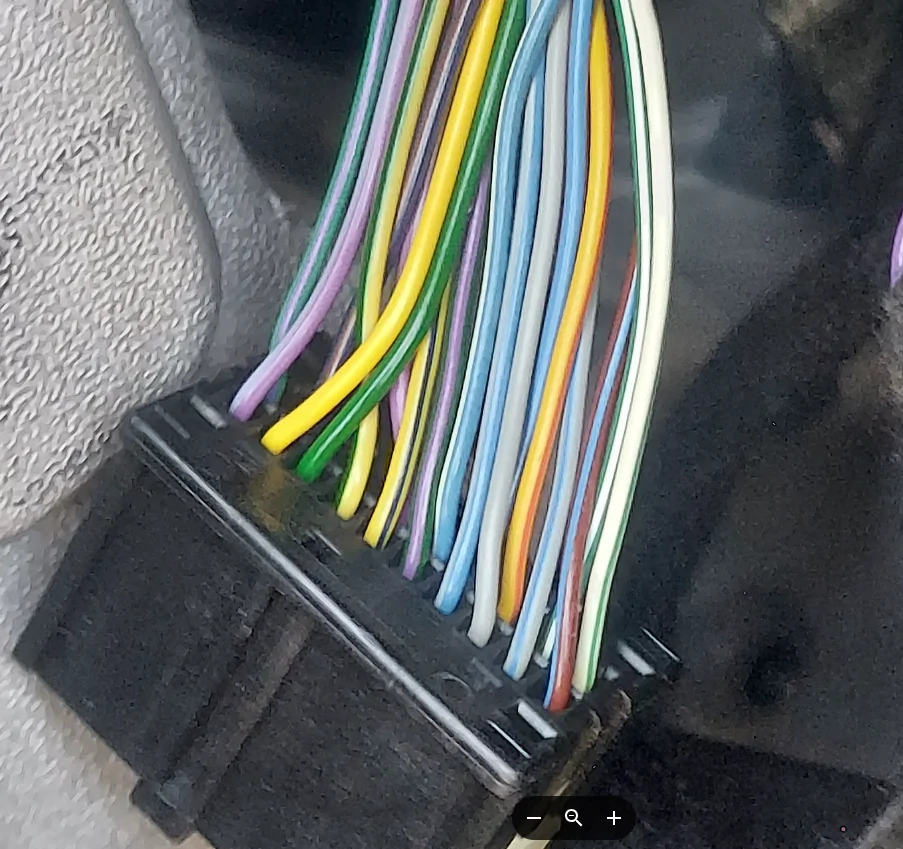

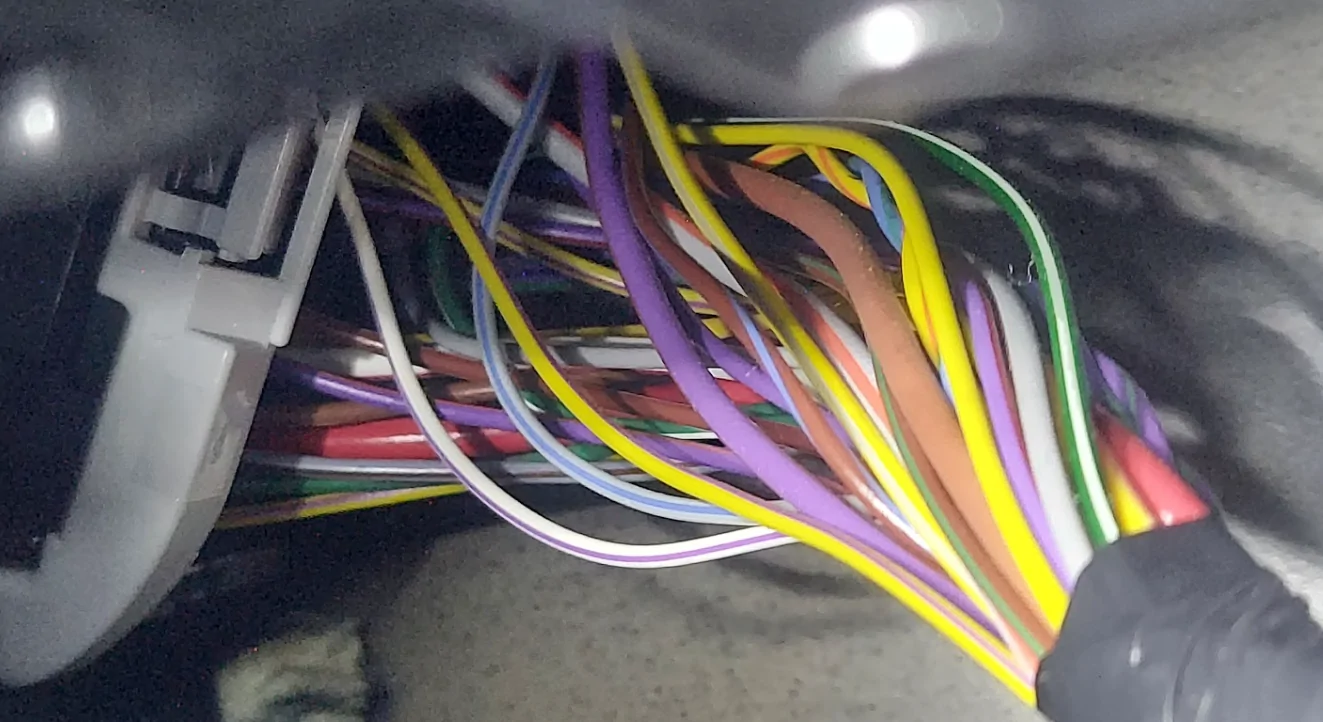

Hi Good Evening,
I did some research today and checked for required wires on Driver and Passenger side .. Here are the photos -
Driver Side -
Ford F-150 Lightning DIY: Installing ACC (Adaptive Cruise Control) and LKA (Lane Keep Alert) to 2022 F-150 Lightning XLT 1757992025191-a4
Passenger Side -
Ford F-150 Lightning DIY: Installing ACC (Adaptive Cruise Control) and LKA (Lane Keep Alert) to 2022 F-150 Lightning XLT 1757991994553-z4
It seems like I do have the required wires at both sides. Does this mean .. I just need to replace the bumper harness and do the FORSCAN Updates ?

Hi Good Evening,
Driver Side -
Passenger Side -
I used to think differently about all this, OEM all the way, but I've changed my opinion. You should totally go least path of resistance. Get 4 lever nut splices and snip the wires a few inches from the IPMA and run your own 4 wire harness out to the CCM at the bumper. You won't need to remove the bumper, just poke the wires through where they go and splice on the CCM pigtail. I could literally install it like this in 30min.
Yes, all you need is the CCM hooked up to the IPMA and the FORScan changes.
This work as I've explained it has been so proven by now it has zero chance of affecting anything related to warranty on a truck, if that's even a worry.
If you are good with splicing and running wire, do it this way and don't look back.

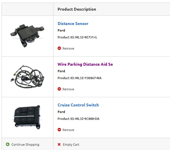

Good Morning, This is what Im planning to order -
Distance Sensor
Ford
Product ID: ML3Z-9E731-G
Wire Parking Distance Aid Se
Ford
Product ID: ML3Z-15K867-NA
Cruise Control Switch
Ford
Product ID: ML3Z-9C888-DA
Ford F-150 Lightning DIY: Installing ACC (Adaptive Cruise Control) and LKA (Lane Keep Alert) to 2022 F-150 Lightning XLT 1758032298243-hj
Can someone take a look ? Just want to make sure im ordering the right parts for 2023 Lightning XLT 311A trim.
Thank you.
Ford F-150 Lightning DIY: Installing ACC (Adaptive Cruise Control) and LKA (Lane Keep Alert) to 2022 F-150 Lightning XLT 1758032285818-y7
watts/up
Apr 2, 2024
271
256
23 Pro SR
Definitely need the distance sensor. The switch is optional. If you’re able to, I’d recommend what @ZSC100 said and make your own harness rather than buying the OEM one.
