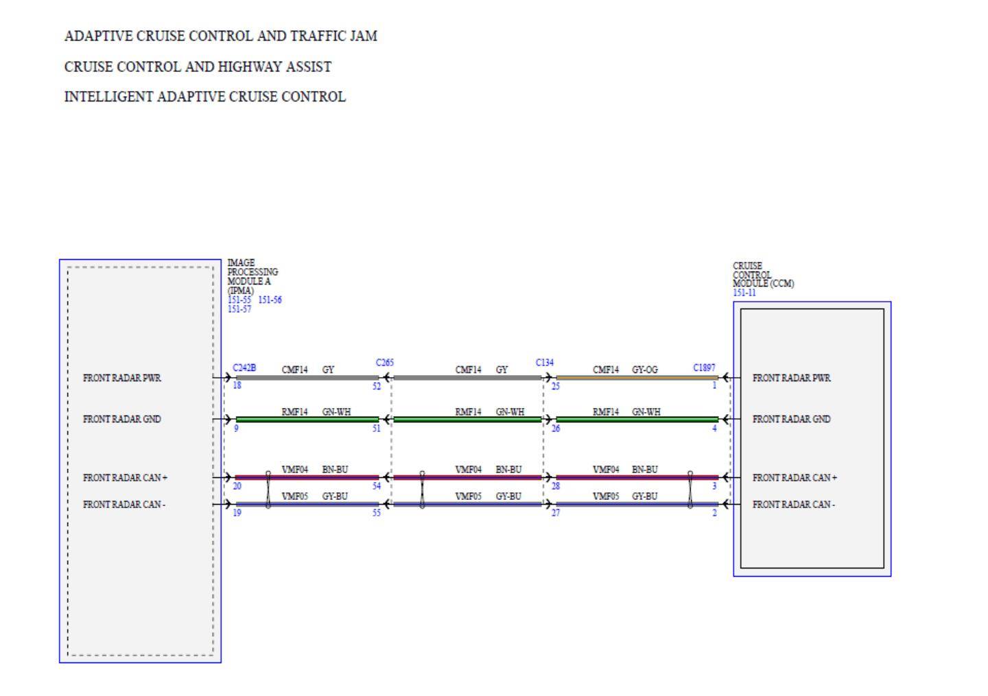

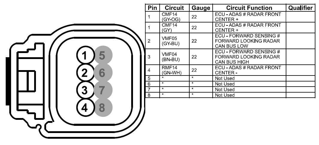

Module connected!
I reversed all of the wires at the CCM ?‍♂
Now on to the rest of the programming!
@B177y I don't seem to have 12v between pins 1 and 4 at the CCM but I have not made any FORScan changes to activate it yet. Do you happen to recall if you had power before programming?
I didn't have power. That's when I figured out the hard way that I reversed the 4 wires in the CCM connection.
I wired my plug as 4, 3, 2, 1 instead of 1, 2, 3, 4. For me it was easier to cut the wires at the IPMA and re-connect to the pin pigtails in the correct order if that makes sense.
