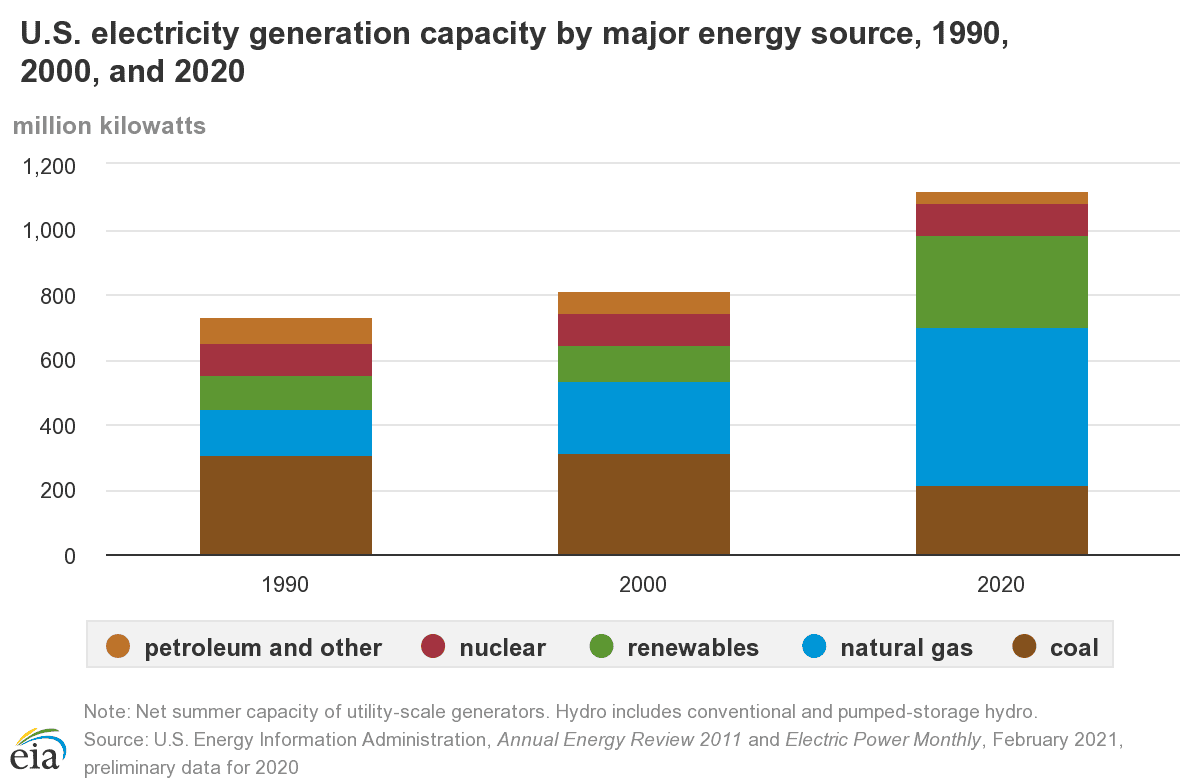

Yes the grid can handle one or two electric vehicles per street, but that is a far cry from an electric vehicle in every household, let alone replacing all vehicles with electric vehicles. Several cities in the USA are already suffering from brown outs, and this will only get worse as more people switch to electric vehicles. And then there were the massive power outages in Texas last winter, if everyone had only electric vehicles, the situation would have far worse, as traffic would have virtually stopped in a day or two.
No need to keep bringing this tired boogeyman back out. EV adoption will not happen overnight, it’ll take 20 years. Plenty of time for us to build out renewables and a resilient grid. We’ll all get to watch it happen, live, I think that’s going to be awesome to see us changing our society for the better.

I bet people were making this same point when electric ranges and electric dryers were popularized.
As any electrician knows, these loads, and electric heating are taken into account when you calculate the service requirements for a home, and for subdivisions. They have been taken into account for decades, whereas electric vehicles were not taken into account when the vast majority of subdivisions were built.

This is a great video on the subject:
In short, it isn't a bigger problem than any other period of increased demand in our history, and it is easily addressed. It's a tired argument, and I doubt it's made in good faith. The people making it never seem to worry about what will happen to our poor Internet grid if everyone watches too much Netflix!
The guy in the video is looking at this totally from the theoretical side, he isn't looking at it from the practical side. His theory is that of course the power companies will sell you more power, but he doesn't address the issue of where all of that extra electricity will come from. It's not like the current plants can just increase production by 30% or more, and you don't just build an electrical plant these days, especially with today's environmental concerns. The same people pushing for electric vehicles are opposing the construction of more plants because of environmental concerns. He looks at the numbers as to what the percentage of actual electricity will be, but he doesn't address how to coordinate all electrical loads, to balance the transmission, to avoid any peak increases. If everyone come home from work and plugs in their vehicles, you create another huge spike in the demand. As for using Norway as an example, they don't have anywhere near the amount of vehicles per capita that we do, and they don't drive the distances that we do. If you look at the numbers, the average Scandinavian drives between 50-60% as ,many miles per year as the average American.
Brian Head Yankee
274
332
Brian Head, UT
Really? What a doofus! By all means cancel your reservations, its hopeless.
1. Not everyone plugs in at full DC fast charge rate at 5:30 PM like he suggests
2. Not every EV plugs in everyday at exactly the same time
3. If we all got up at 5 AM, took a dump, and flushed at the same time, shit would be flowing in the streets.

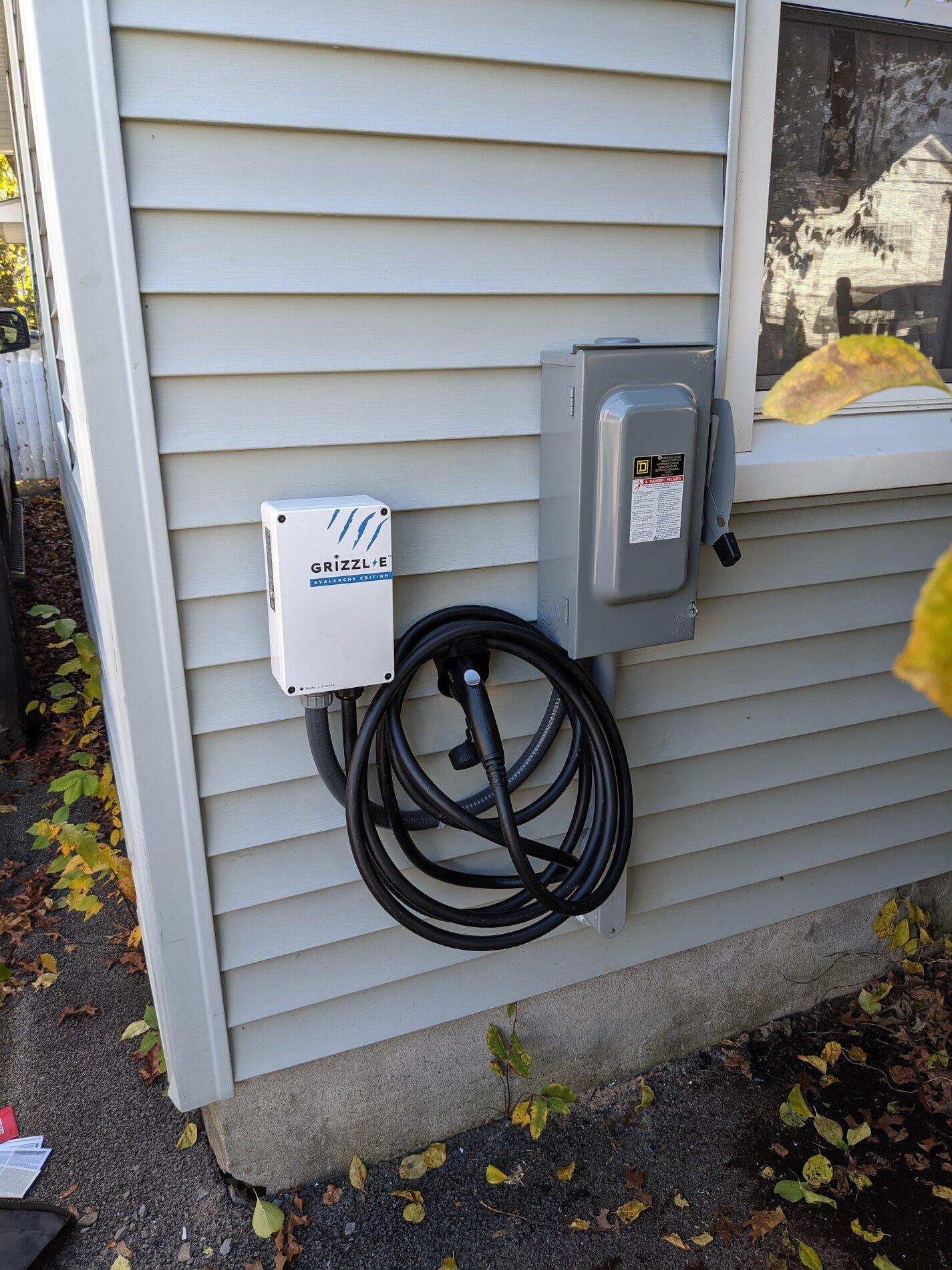

I need the ER battery and will go with the 80A charger. My panel is in the basement and I'll need to get the power to the front of my garage, which is a 40-50 foot run. I've heard the 100A wiring is pretty expensive. Could two 50A wires be run instead of the expensive 100A wire? Would that be more cost effective and/or more safe? Are both copper and aluminum wires an option?
And yes, I will get a qualified electrician to do the work, I'd just like to know if there might be cheaper and safer options available that they might not bring up if I don't ask.

Partial setup complete. Needed to get something installed for my Wife's Mach-e so had had a 100A circuit run to a disconnect and then the 40A charger connected to that. When it comes time to upgrade, I just need to put in a bigger breaker and swap the wiring from the disconnect (plus whatever other hardware is needed).

Ford's 80A charger is really two 40A chargers and as I read it, you'd need two 50A circuits. Guess it might be possible to use only one for limited situations. So, no you don't need 100A circuit as such.
I think you're reading it wrong. There are 2 chargers but they are inside the truck with ER battery. The 80A EVSE that is included with that truck is 80A, and it does need 100A circuit.
