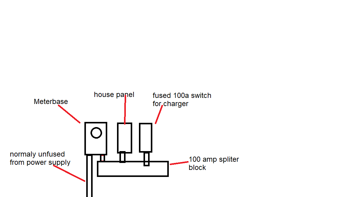

As an electrician, I think you would be ok, your Ford charger will draw a lot of power when only used. I would even hook it up at my house that is only 100amp. the way power is distributed in most houses is that its only fused at panel with main breaker, I would add a wire splitter before the 100amp house panel and add a seconded 100amp panel for the charger. This way power is still measured by the meter base and also there are no fuses on the city side before your meter base to the transformer its hooked up to on city side. As long as you not charging a fleet of vehicles at same time this should work.
This by no means would meet electrical code. This would have you potentially pulling close to 200 amps through a meter base and service wire only rated to 100 amps.
The diagram is very crewed but I don't think you can justify the statement that the intent of the diagram doesn't meet the electrical code. It's very likely that the meter is already rated for 200 amps but of course you would have to do your homework to be sure. And as far as the feeders from the meter go, you are going to have to replace those anyway to get the transfer switch/EVSE in there.

that diagram doesn't seem to address the fact that the wire back to pole was installed based on 100 amp service. by installing two 100 amp services you can run 200 amps so you need to upgrade wiring to the point you might as well just do 200 amp service
