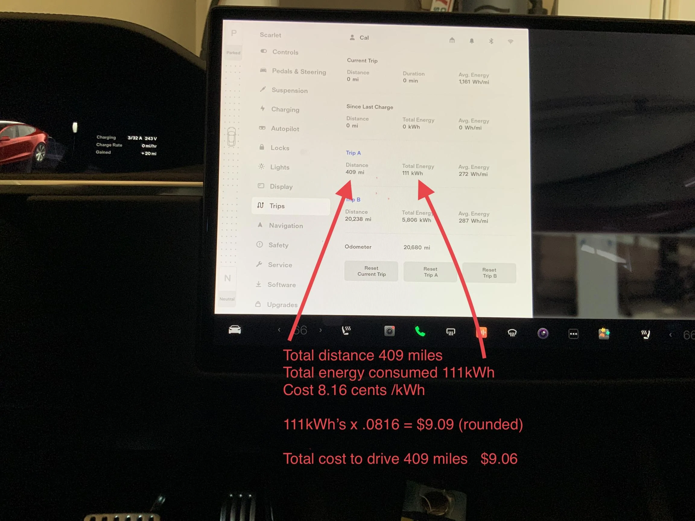

Back in 2014 my wife was visiting a skin cancer clinic in Portland OR. It was 62 miles round trip. It took 21kWh’s to make the trip. I pay 8.16 cents per kWh. All you do is multiply the number of kWh consumed by the cost per kWh. .0816 x 21 = $1.71. This realization changed my life. I would take the Tesla on every trip into town. Something that would cost me $5 in gas on my Tundra would literally be pennies on my EV. Truck annual milage dropped and we started racking up miles on the Tesla. When we took trips hotels would let us charge for free. It’s just another way to get us to stay there. A couple of bucks to let this guy charge was nothing.
Here is a snapshot of our current Tesla charge log. Pretty easy to calculate energy usage and cost.

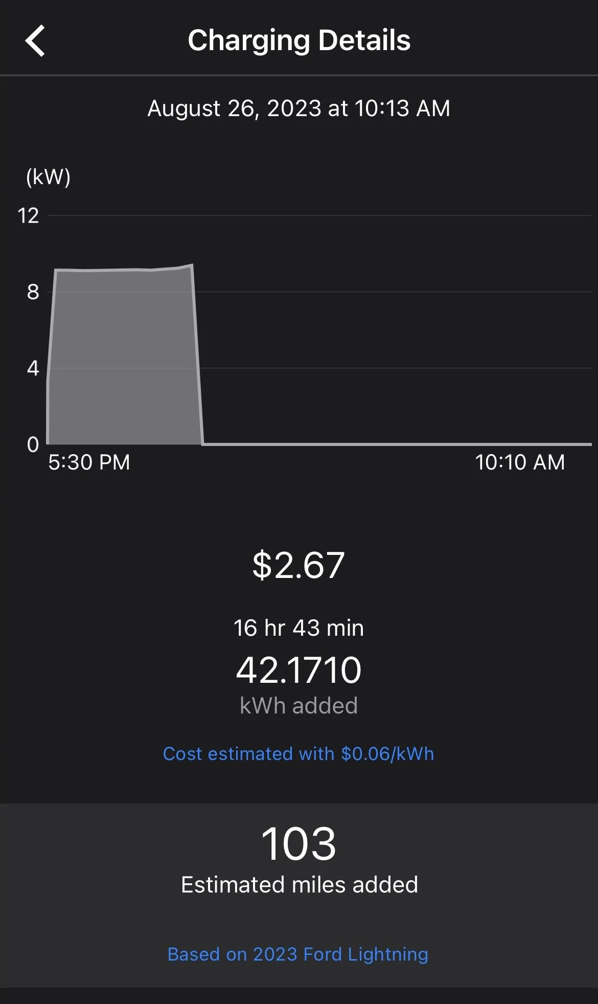

This is what my ChargePoint Home Flex says. KWh and miles. Knowing miles to tenths would help. Then cross checking with the LTs estimated miles/KWh. The best way is the PUD meter. In our case I can turn off all garage power and read the meter as it is separate from the house meter. However when I told my SO two years ago that our MME would use $30/month... two months later she said.. ”The utility said our garage meter went up $30 a month“. My daily use is very consistent: 88-92 miles. And the miles/KWh very consistent at 2.6 Mi/KWh. The Mache was consistent at 4.1 spring and summer, 3..5-3.7 fall-winter.

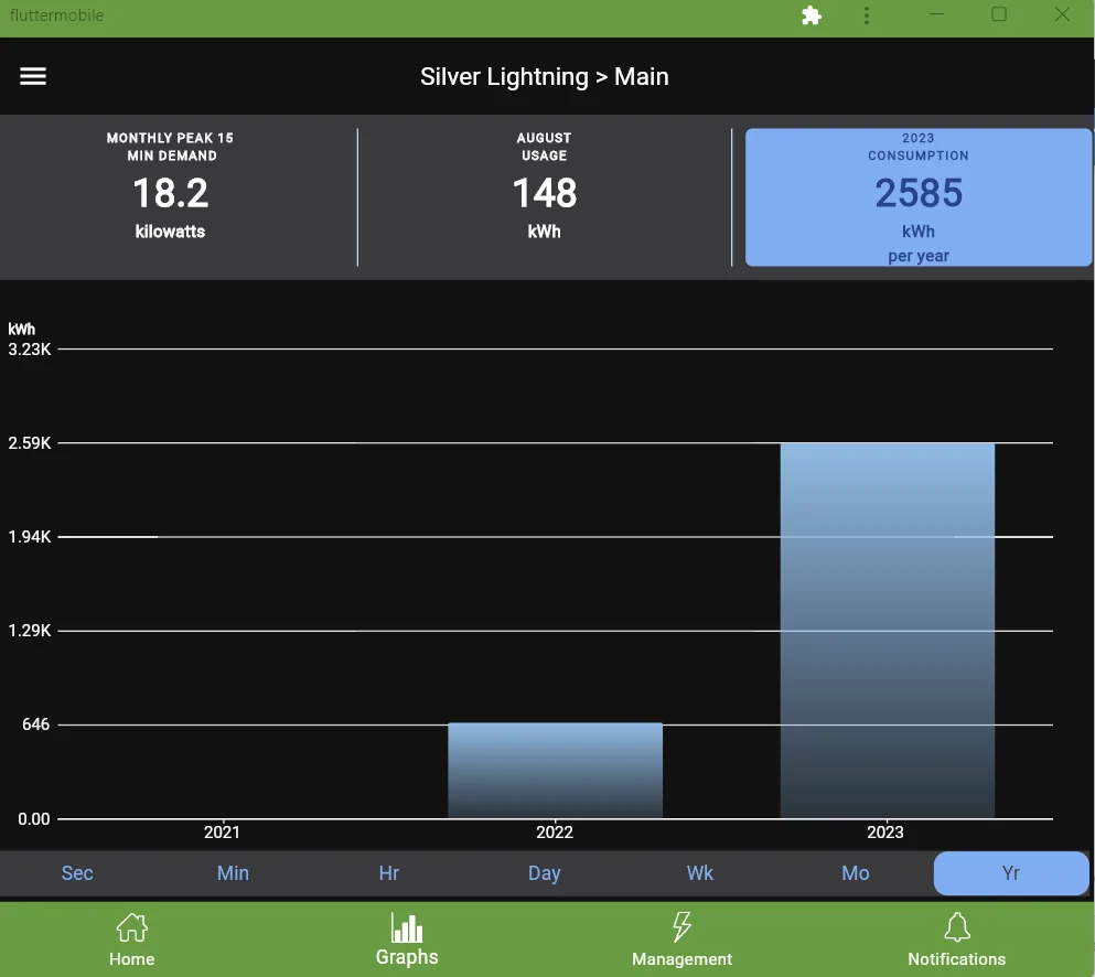

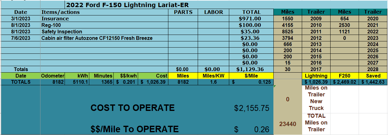

No comprehensive data reports are available from the Sync system, it would be awesome if Ford developed an all encompassing analytic for us to read the total KWH consumed, not just the traction energy stored in the battery.
In lieu of that I have a cumbersome spreadsheets to log my weekly miles, KWH fed to the Lightning via the FCSP using a very reliable Emporia Vue2 circuit monitor, being the data and statistics nerd that I am, it works for me.
I add my DCFC sessions with KWH & net costs (in Mass we pay sales tax on energy purchases at for-fee public charging stations)
I also log minutes sitting at DCFC stations for the time wasted factor.
Overall 12.5 cents a mile mean energy costs between home and away charging 20.1 cents a kWh, this will be increasing from August onward as we lost the cost advantage of paying by the minute in Massachusetts, home charging is currently 25.8 cents a kWh.
So far this year I've saved $1,442.63 in energy costs as compared the my former F250 Powerstroke Diesel.
I have not towed much this year, I recall one long haul event last spring but forgot to log the trailer miles, during those events my MPK drops to around 1.1
Ford F-150 Lightning Does anyone know how to calculate the actual cost of a Lightning’s energy consumption? 1693099827780

If charge companies can figure out how much to charge you for a session, why can't I do this at home?

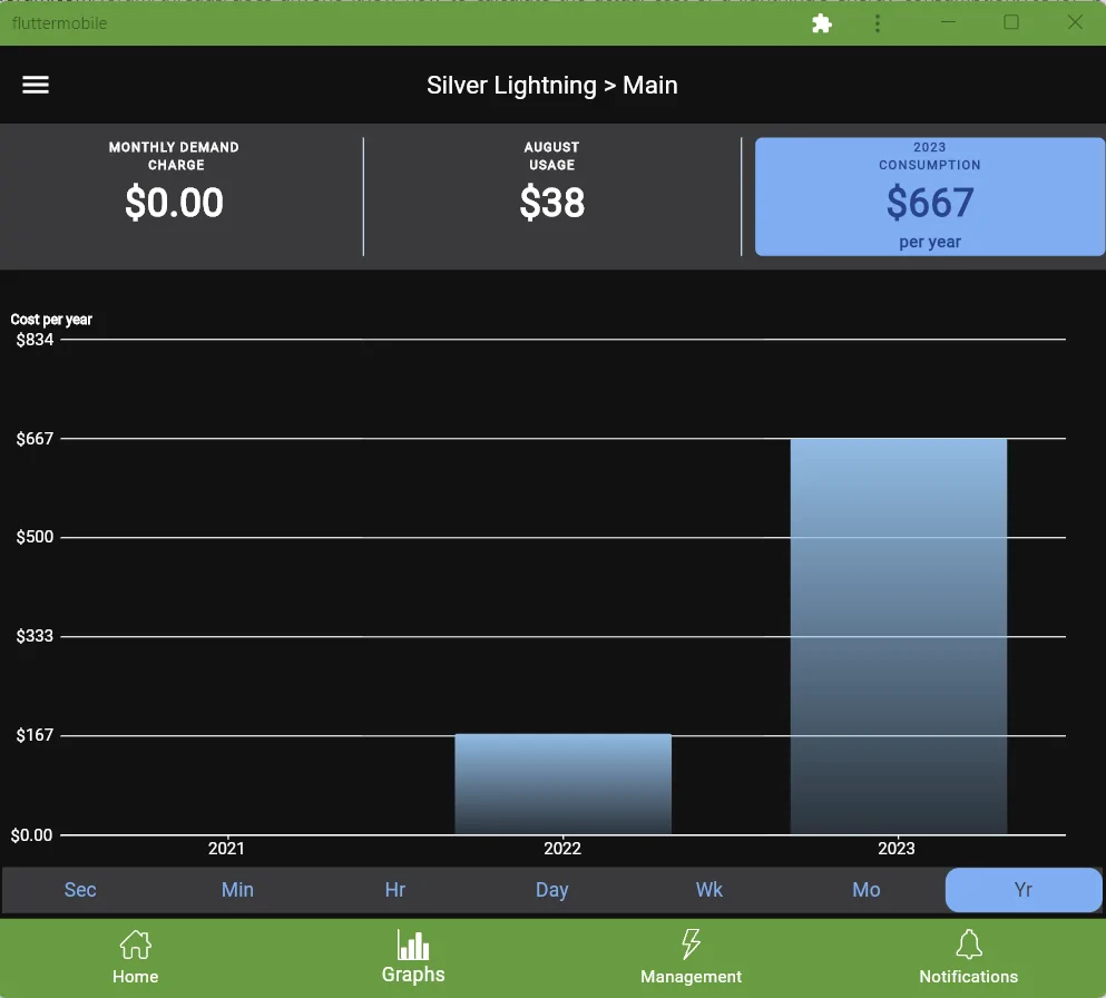

With the right tools you can, Emporia Vue2 energy monitor, this is only my home charging, no account for the DCFC or free public charging
Ford F-150 Lightning Does anyone know how to calculate the actual cost of a Lightning’s energy consumption? 1693101046050

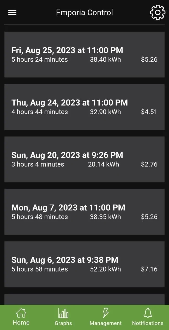

For comparison, this is how the Emporia EVSE can report usage in the app. Gives the exact information the OP wants.
Ford F-150 Lightning Does anyone know how to calculate the actual cost of a Lightning’s energy consumption? Screenshot_20230826_215723_Emporia Energy

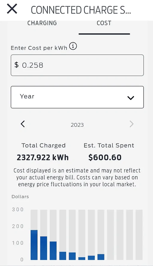

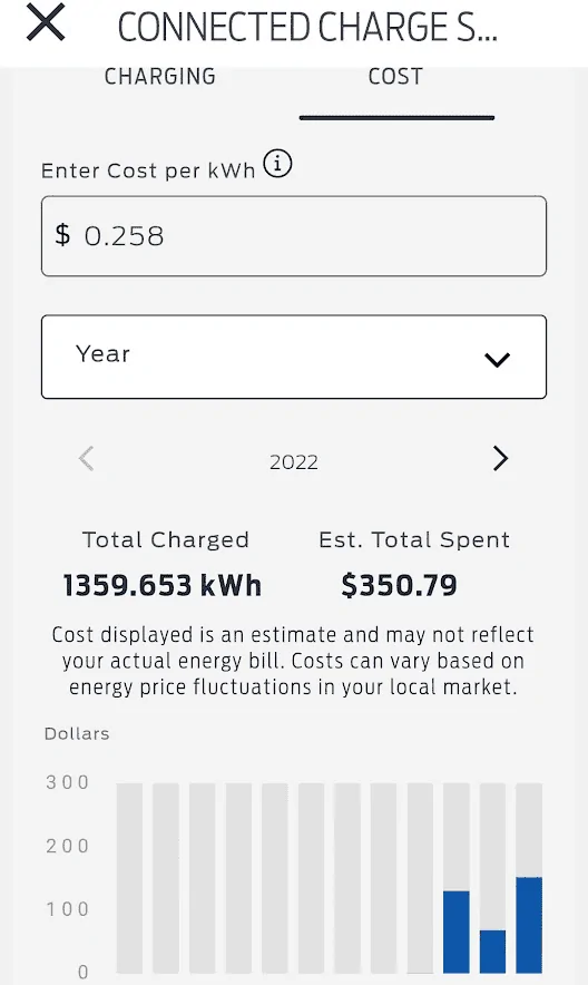

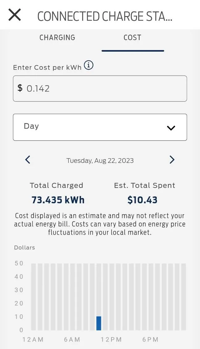

And this is what he would see if he installed the Pro Charger.
Ford F-150 Lightning Does anyone know how to calculate the actual cost of a Lightning’s energy consumption? Screenshot_20230826_220135_FordPass
213
15,734
17,646
The Pro charger data logs are not 100%
I have several missing log days due to data brownouts at the FoMoCO mother ship's data center or the FCSP wifi comm's failures, my emporia is 100% reliable never missed a charge session.
We can show the dollar costs, but it does not handle seasonal energy rate changes, just one value, 25.8 is the current cost but it's been higher and lower.

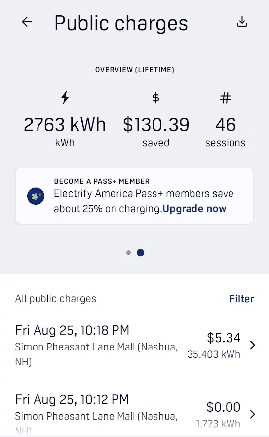

* 2022 data is not close because the FCSP went into service last day of September, the Emporia Vue2 went online late November 2022
EA Life time report
Ford F-150 Lightning Does anyone know how to calculate the actual cost of a Lightning’s energy consumption? 1693102773772

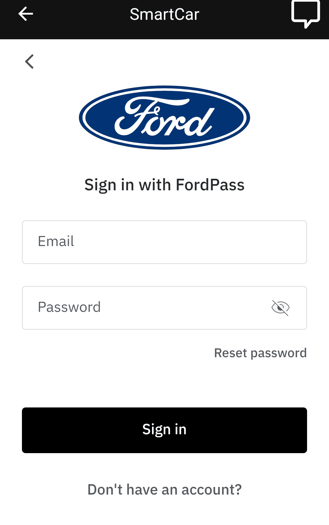

Has anyone using the Emporia service tried this?
I'm afraid to use it if Ford gets upset and locks my FP account again, I do not want to go through this again like I did last year.
Ford F-150 Lightning Does anyone know how to calculate the actual cost of a Lightning’s energy consumption? 1693103255502
Ford F-150 Lightning Does anyone know how to calculate the actual cost of a Lightning’s energy consumption? 1693103175292
I'm taking a chance testing this, letting Emporia connect, it's only showing the Lightnings SOC and projected range at the moment and that it's not connected at this time to an EVSE. If this locks me out of FP, I'll be pissed
Ford F-150 Lightning Does anyone know how to calculate the actual cost of a Lightning’s energy consumption? 1693104187524
Ford F-150 Lightning Does anyone know how to calculate the actual cost of a Lightning’s energy consumption? 1693104201978
That will get your account locked again.
