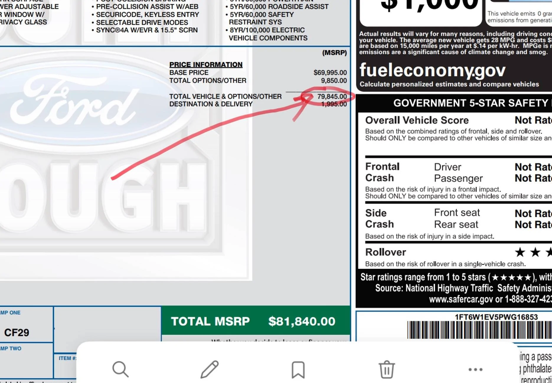

It doesn’t matter what you paid for the EV or which plan you used to buy it. The ONLY number for a Lightning that matters to qualify for the EV tax credit is the one circled in my Window Sticker attached.
As you can see the bottom line MSRP was $81,840 and price before Desination and Delivery was the $79,845. My truck qualified for tax credit by only $155.
There were quite a few that were a few hundred OVER $80k when I searched. I'll bet they end up sitting on the dealer lots for a year. Whoever included the $500 mobile charger on those Lightnings should probably be in a different job :)
