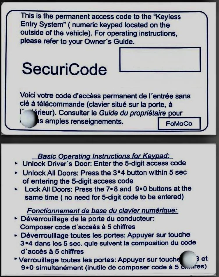

No door card and only one fob? I would contact whatever company is handling your lease. At least with the fob. If they expect 2, which the truck should have come with, when you turn it back in, your looking at hundreds to replace it.

It is, or st least was on my 22

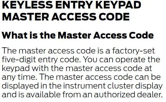

Ford stopped providing keypad code cards for 2024. You have to use the method above with two fobs:
SSM 52310 2024 Nautilus/F-150 - Keyless Entry Keypad Code Card Missing
Some 2024 Nautilus and F-150 vehicles may incorrectly list the keyless entry keypad code card on
the loose item checklist. 2024 Nautilus and F-150 vehicles in North America do not include keyless entry keypad code cards. Clients are now able to retrieve the vehicle's keyless entry keypad master access code in vehicle by following the instructions in the master access code card (available only on F-150) or in the Owner’s Manual > Keyless Entry Master Access Code. This process requires the use of two programmed intelligent access keys.

Yeah, this was to address the multiple folks who keep saying their 2022 came with a card.
