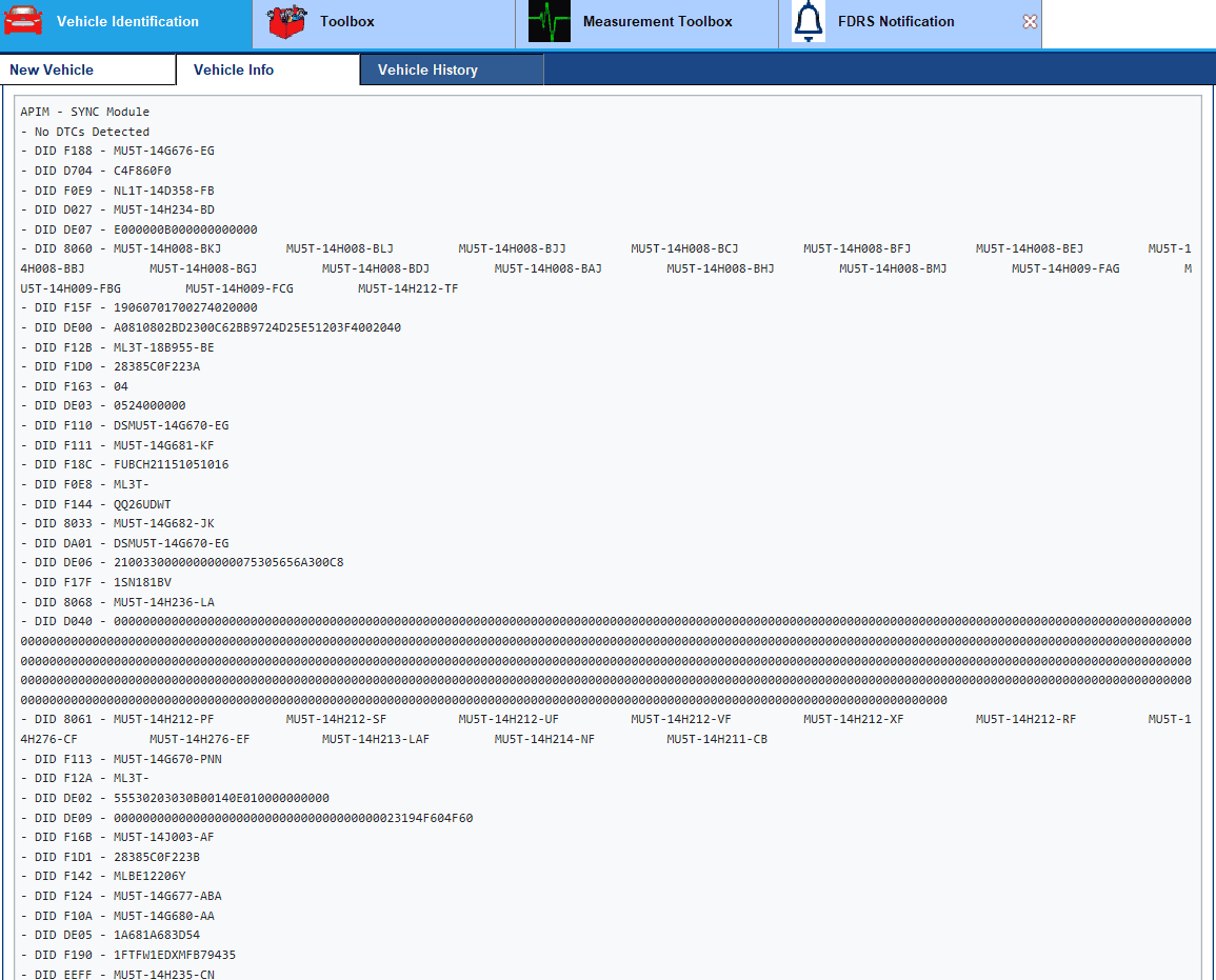

Are the APIM updates just showing up for people? I have not been able to get any updates since this past weekend. I have the GSM update that is stuck, but no other updates. I do not have any DTCs either, so not sure why I no updates are shown as available.

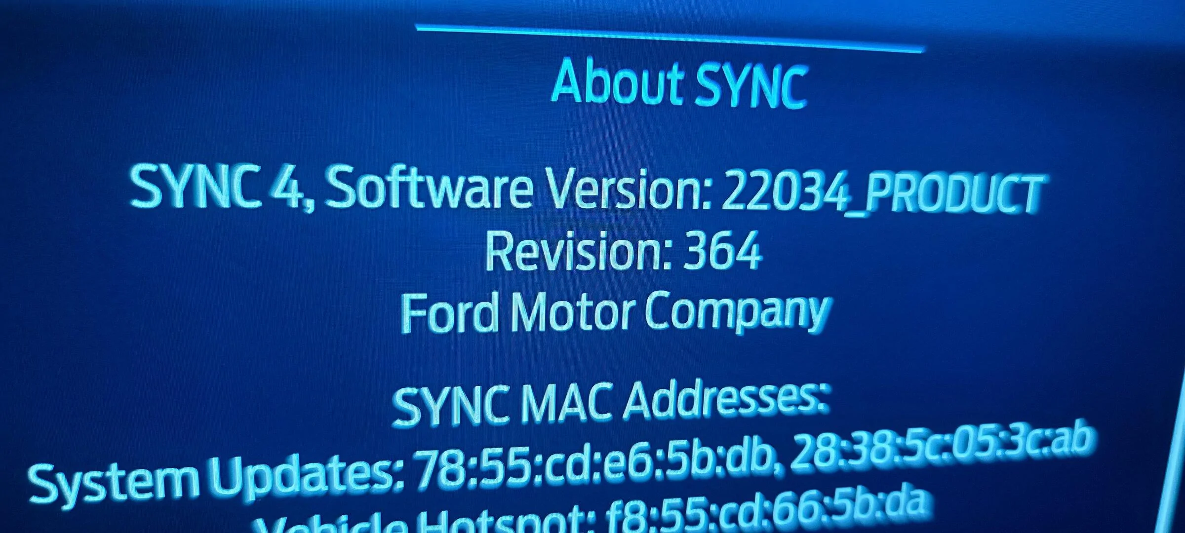

I think 364 is up to date. What feature are you not getting?
I haven’t tried blue cruise yet. My bed camera at speed works, I don’t get hitch view though or side IOD view. Wondering if more updates are necessary or if Forscan changes are needed.
i would undo any forscan changes you have.
jtake
Jan 29, 2022
2021 F150 King Ranch
The only Forscan change I have ever made was the running board activation one to the DSM. And even before that, I was not seeing any updates. That one change is something I know Platinum Peasant has done, and I see he has updated.
Strange that you would have different cameras at speed functionality than others unless you had Forscan edited values before the updates?
The sidebar camera is the bed camera for me.
Full screen camera is either bed or hitch.
