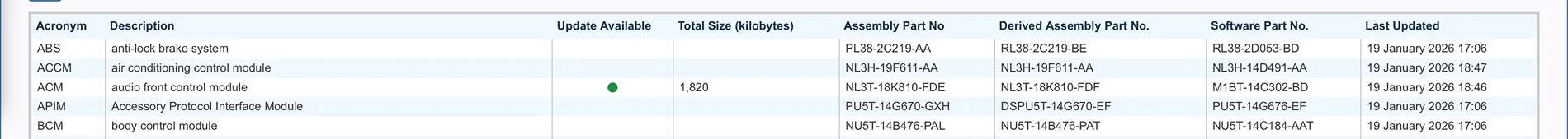

.....did a selftest and everything was still reporting green.....and had another go...same thing. Rinse and repeat. Still the same.
So I've got the ACM update that never goes away along with an OBCC update that won't proceed because there's a communications error of some sort.....

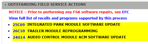

My ACM Update disappeared yesterday when I had Mobile Service perform the 25C69 Recall on the Integrated Park Module; it included SOBDMC, PCM, and ABS (maybe a couple more, I lost my screen capture). He also took care of the 26C10 Trailer Module update; same update is/was available on both my Lightning and my '23 5.0. I don't know if he just went ahead and cleared the ACM because it had an Outstanding Field Service Action. He said he had to enter a PIN to make those disappear from the list. Oddly, the paperwork shows he address 25C69 and 24U14 but makes no mention of 26C10.
Ford F-150 Lightning Lightning Software Updates using FDRS 1773951691496-re
I guess I'll find out Monday. Mobile Service is coming back out to address 26C10 on my 23 5.0. It does not show 24U14 ACM Update like my Lightning did.
He had to enter a pin....? I wonder what that was about? I still have that ACM update in my list. I just ignore it now. But on the other hand my truck does not have an outstanding recall for the ACM module anyway (24U14). Just a ACM module in my list of available software that won't go away.

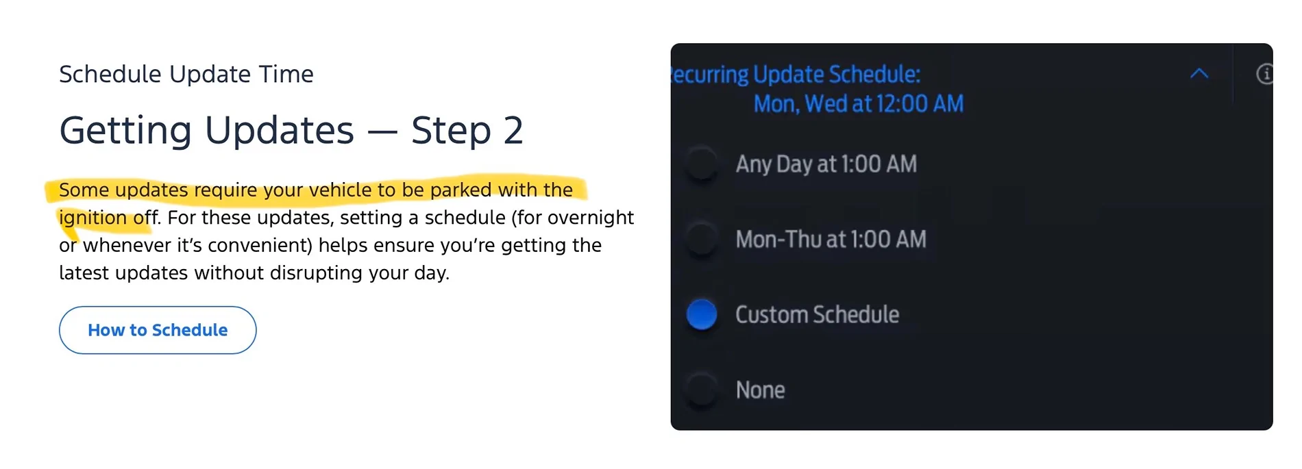

Yeah that was the idea. But I had to actually go out there and tell it to "Update Now" to get things started. I thought it might connect to the mothership while it was in climate mode...but I guess not.
3,183
4,595
I think the whole idea with Update Schedule is the truck has to be off for certain updates. That’s why the default is 1:00 am.
Ford explains it here (see Step 2).
Ford F-150 Lightning Lightning Software Updates using FDRS IMG_0641
Other OTAs can install anytime and don’t observe the Update Schedule. See Step 1 above. I’ve had many of these download and install while driving.
