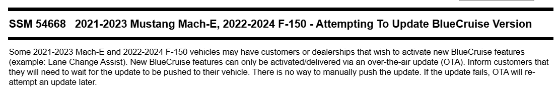

Came across this today:
Ford F-150 Lightning Lightning Software Updates using FDRS SSM_54668_BC_OTA

Similar to the message I got when I asked about getting the update to activate Walk Away Locks.
Well that's not actually the problem with WAL programming right now....the actual problem (aside from the fact that your dealership doesn't want to do the update for free) is the fact that the ability to perform a BCM software update (or PMI) has been removed from the FDRS tool the techs use because of concerns that it could end up bricking the BCM module. They are doing testing and will turn the ability back on in FDRS (by model year) when it's once again safe to perform updates or PMIs. And if they can't do an update using the FDRS tool, they won't even attempt to send your truck an update via OTA, since that's even riskier.
