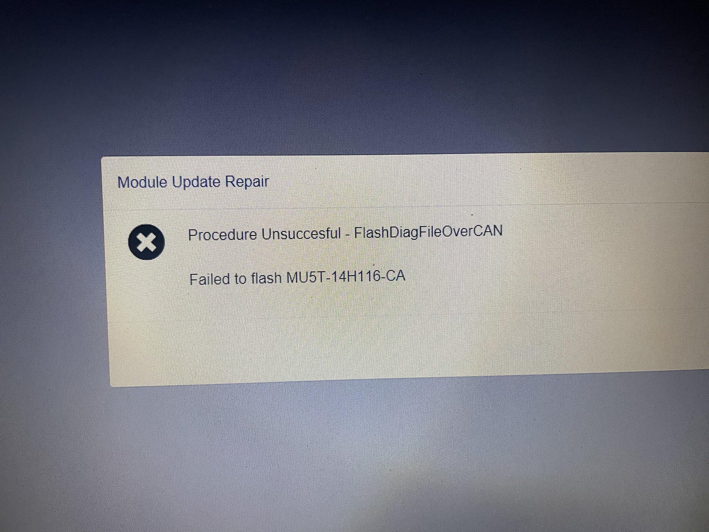

This truck and this process has been fighting me every inch of the way ?. Ill try the reinstall, in a few days when my Mongoose gets here. Amazon updated my delivery date from April 14th to April 6th! My FDRS 2 day license already expired. I’ll probably spring for the 1 month again. At this rate it probably would have been more cost effective to just buy the whole year, ill already be about $450 into license fees. ??? Ford should reimburse us all for this.

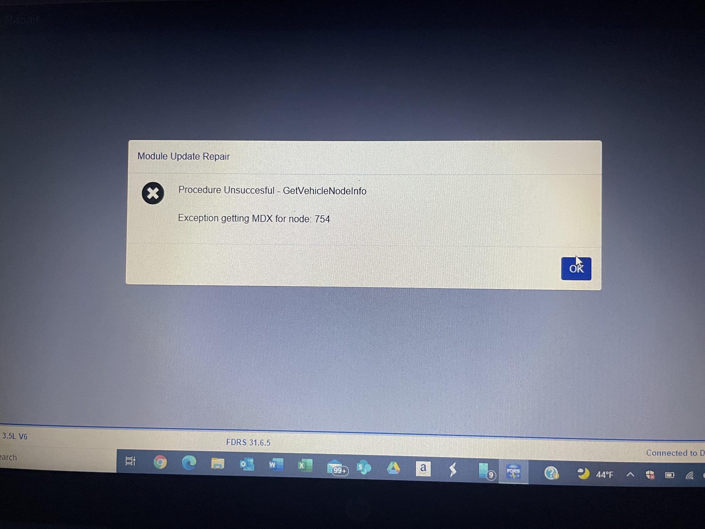

@Ruffiano99 , @Shoebox72069
Those odd errors have been fixed in the past by reinstalling FDRS. If you go that route, be sure to release your license before you uninstall so that it is is available again after you get done.
This was a good suggestion!
I released the license, removed the software and reinstalled. Reboots between everything....
No change unfortunately.
RapidRedRick
Rick
Northern Virginia
Ford F150 Platinum Powerboost
Got it figured out. There was a DSM SW update today so I did that and it fixed everything. So with the DSM update it put the boards back to factory original settings but instead of the annoying locking the truck from the door outside button the steps going up and not even 2 seconds later they come back down, it appears Ford fixed the bars and they stay up when pressing the outside door button, door outside keypad lock, or fob lock button is pushed and you around the vehicle walking away. This is nice that's finally fixed as that was annoying.

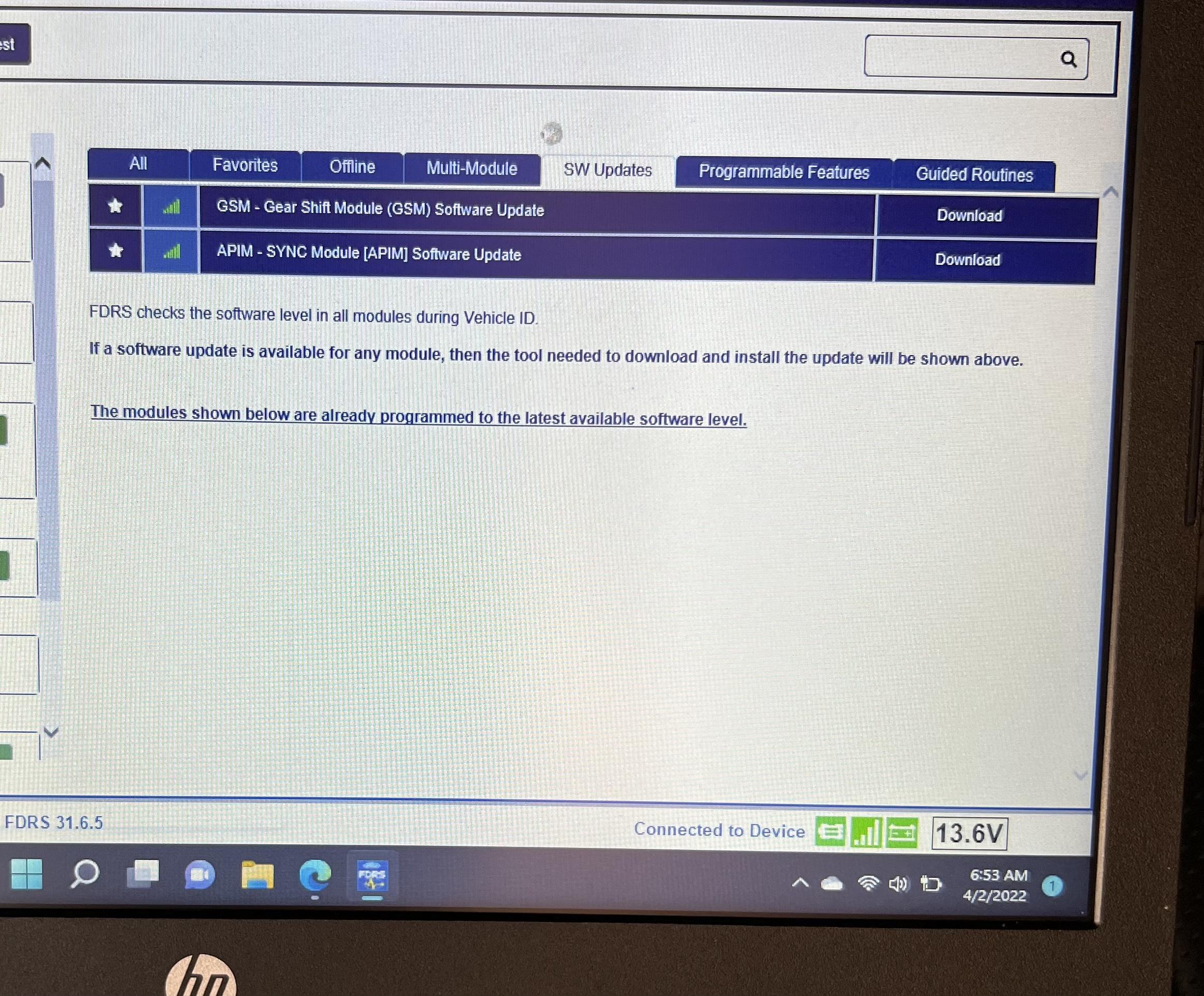

Anyone see anything out of the ordinary with this? The FDRS logs from the run are super chewy... and this is Java :sick:
BECM - Battery Energy Control Module
- No DTCs Detected
- DID F166 - 19092510
- DID F15F - 08080001500444020000
- DID F163 - 04
- DID D03F - 40888D0148537F811B10ECF471FEEAA5167D615EEDDF4DC6F62A5AFDD7E8FBC5
- DID F188 - ML38-14C197-AD
- DID DA01 - ML38-10B687-AD
- DID F110 - DSML38-10B687-AD
- DID F162 - 06
- DID F111 - ML38-14F092-AA
- DID F113 - ML38-10B687-AD
- DID F18C - H388E21008000784

at com.ford.etis.runtime.apps.otx.utils.types.ford.VehicleDidWrapper.getGivisVehicleDidResponse(VehicleDidWrapper.java:79) ~[com.ford.otx.common.apps.utils-40.8.21.jar:?]
at com.ford.etis.runtime.apps.otx.utils.types.ford.VehicleDidVariable.getGivisVehicleDidResponse(VehicleDidVariable.java:54) ~[com.ford.otx.common.apps.utils-40.8.21.jar:?]
at otxcontainer.G2232623.GetVehicleNodeInfo(G2232623.java:7321) [G2232623:?]
at otxcontainer.G2232623.access$1600(G2232623.java:90) [G2232623:?]
at otxcontainer.G2232623$10.run(G2232623.java:17770) [G2232623:?]
at java.util.concurrent.ThreadPoolExecutor.runWorker(ThreadPoolExecutor.java:1149) [?:1.8.0_171]
at java.util.concurrent.ThreadPoolExecutor$Worker.run(ThreadPoolExecutor.java:624) [?:1.8.0_171]
at java.lang.Thread.run(Thread.java:748) [?:1.8.0_171]
2022-04-02T07:24:17,140 INFO class otxcontainer.G2232623.authorLogs - No GIVIS response for: DE00
2022-04-02T07:24:17,141 INFO class otxcontainer.G2232623.authorLogs - Missing backup config data!! -- DE00
2022-04-02T07:24:17,141 INFO class otxcontainer.G2232623.authorLogs - GIVIS CDL DID F18C = H388E21008000784
2022-04-02T07:24:17,141 INFO class otxcontainer.G2232623.authorLogs - GIVIS CDL DID F113 = ML38-10B687-AD
2022-04-02T07:24:17,141 INFO class otxcontainer.G2232623.authorLogs - GIVIS CDL DID F111 = ML38-14F092-AA
2022-04-02T07:24:17,141 INFO class otxcontainer.G2232623.authorLogs - GIVIS CDL DID F163 = 04
2022-04-02T07:24:17,157 INFO class otxcontainer.G2232623.authorLogs - GIVIS CDL DID F15F = 08080001500444020000
2022-04-02T07:24:17,158 INFO class otxcontainer.G2232623.authorLogs - Number of config DIDs = 0
2022-04-02T07:24:17,158 ERROR otxcontainer.G2232623 - Error in application, message was: Index: 0, Size: 0
java.lang.IndexOutOfBoundsException: Index: 0, Size: 0
at java.util.ArrayList.rangeCheck(ArrayList.java:657) ~[?:1.8.0_171]
at java.util.ArrayList.get(ArrayList.java:433) ~[?:1.8.0_171]
at com.ford.etis.runtime.apps.otx.utils.types.core.ListWrapper.get(ListWrapper.java:146) ~[com.ford.otx.common.apps.utils-40.8.21.jar:?]
at com.ford.etis.runtime.apps.otx.utils.types.core.ListVariable.getListItem(ListVariable.java:136) ~[com.ford.otx.common.apps.utils-40.8.21.jar:?]
at otxcontainer.G2232623.GetVehicleNodeInfo(G2232623.java:7838) [G2232623:?]
2022-04-02T07:24:17,175 INFO class otxcontainer.G2232623.authorLogs - ****EXCEPTIONHANDLER****
2022-04-02T07:24:17,175 WARN types.core.GuardedFordEtisRuntimeException - GetExceptionQualifier on for Exception class that is not child of OTXExceptionTerm. Returning empty string.
2022-04-02T07:24:17,190 WARN types.core.GuardedFordEtisRuntimeException - GetExceptionText called on Exception class that is not child of OTXExceptionTerm. Returning empty string.
2022-04-02T07:24:17,191 INFO class otxcontainer.G2232623.authorLogs - Procedure name = GetVehicleNodeInfo - Exception qualifier = GetVehicleNodeInfo - Exception text = Unknown Error
2022-04-02T07:24:17,233 ERROR otxcontainer.G2232623 - Error in application, message was: java.lang.RuntimeException: java.lang.IllegalStateException: Unknown protocol: fordetis
com.ford.otx.command.exception.FdrsRuntimeException: java.lang.RuntimeException: java.lang.IllegalStateException: Unknown protocol: fordetis
at com.ford.etis.runtime.apps.otx.utils.ParallelExecutor.waitForAllToComplete(ParallelExecutor.java:119) ~[com.ford.otx.common.apps.utils-40.8.21.jar:?]
at com.ford.etis.runtime.apps.otx.utils.ParallelExecutor.waitForAllToComplete(ParallelExecutor.java:85) ~[com.ford.otx.common.apps.utils-40.8.21.jar:?]
at otxcontainer.G2232623.GetVehicleNodeInfoProcess(G2232623.java:17823) [G2232623:?]
at otxcontainer.G2232623.OTXAppFlowControl(G2232623.java:25235) [G2232623:?]
at otxcontainer.G2232623.main(G2232623.java:881) [G2232623:?]
at com.ford.etis.runtime.apps.otx.core.BaseApplication.startApp(BaseApplication.java:319) [com.ford.otx.apps.otx-72.16.33.jar:?]
at com.ford.etis.runtime.apps.otx.core.BaseApplication.access$000(BaseApplication.java:106) [com.ford.otx.apps.otx-72.16.33.jar:?]
at com.ford.etis.runtime.apps.otx.core.BaseApplication$1.run(BaseApplication.java:254) [com.ford.otx.apps.otx-72.16.33.jar:?]
Caused by: java.lang.RuntimeException: java.lang.IllegalStateException: Unknown protocol: fordetis
at otxcontainer.G2232623$9.run(G2232623.java:17723) ~[?:?]
at java.util.concurrent.ThreadPoolExecutor.runWorker(ThreadPoolExecutor.java:1149) ~[?:1.8.0_171]
at java.util.concurrent.ThreadPoolExecutor$Worker.run(ThreadPoolExecutor.java:624) ~[?:1.8.0_171]
... 1 more
Caused by: java.lang.IllegalStateException: Unknown protocol: fordetis
at org.apache.felix.framework.URLHandlersStreamHandlerProxy.toExternalForm(URLHandlersStreamHandlerProxy.java:482) ~[?:?]
at org.apache.felix.framework.URLHandlersStreamHandlerProxy.toExternalForm(URLHandlersStreamHandlerProxy.java:474) ~[?:?]
at java.net.URL.toExternalForm(URL.java:929) ~[?:1.8.0_171]
at java.net.URL.toString(URL.java:915) ~[?:1.8.0_171]
at java.lang.ClassLoader.defineClassSourceLocation(ClassLoader.java:678) ~[?:1.8.0_171]
at java.lang.ClassLoader.defineClass(ClassLoader.java:762) ~[?:1.8.0_171]
at org.apache.felix.framework.BundleWiringImpl$BundleClassLoader.defineClass(BundleWiringImpl.java:2370) ~[?:?]
at org.apache.felix.framework.BundleWiringImpl$BundleClassLoader.findClass(BundleWiringImpl.java:2154) ~[?:?]
at org.apache.felix.framework.BundleWiringImpl.findClassOrResourceByDelegation(BundleWiringImpl.java:1542) ~[?:?]
at org.apache.felix.framework.BundleWiringImpl.access$400(BundleWiringImpl.java:79) ~[?:?]
at org.apache.felix.framework.BundleWiringImpl$BundleClassLoader.loadClass(BundleWiringImpl.java:2018) ~[?:?]
at java.lang.ClassLoader.loadClass(ClassLoader.java:357) ~[?:1.8.0_171]
at otxcontainer.G2232623.BargraphDisplay(G2232623.java:12252) ~[?:?]
at otxcontainer.G2232623.access$400(G2232623.java:90) ~[?:?]
at otxcontainer.G2232623$9.run(G2232623.java:17695) ~[?:?]
... 1 more
2022-04-02T07:24:17,243 INFO class otxcontainer.G2232623.authorLogs - ****EXCEPTIONHANDLER****
2022-04-02T07:24:17,243 WARN types.core.GuardedFordEtisRuntimeException - GetExceptionQualifier on for Exception class that is not child of OTXExceptionTerm. Returning empty string.
2022-04-02T07:24:17,257 WARN types.core.GuardedFordEtisRuntimeException - GetExceptionText called on Exception class that is not child of OTXExceptionTerm. Returning empty string.
2022-04-02T07:24:17,259 INFO class otxcontainer.G2232623.authorLogs - Procedure name = GetVehicleNodeInfoProcess - Exception qualifier = GetVehicleNodeInfoProcess - Exception text = Unknown Error
2022-04-02T07:24:17,259 ERROR otxcontainer.G2232623 - Error in application, message was: Qualifier: GetVehicleNodeInfoProcess text: Unknown Error
com.ford.etis.runtime.apps.otx.utils.exceptions.UserExceptionLiteral: Qualifier: GetVehicleNodeInfoProcess text: Unknown Error
at otxcontainer.G2232623.ExceptionHandler(G2232623.java:25716) ~[G2232623:?]
at otxcontainer.G2232623.GetVehicleNodeInfoProcess(G2232623.java:17845) ~[G2232623:?]
2022-04-02T07:24:17,276 INFO class otxcontainer.G2232623.authorLogs - ****EXCEPTIONHANDLER****
2022-04-02T07:24:17,276 INFO class otxcontainer.G2232623.authorLogs - Procedure name = OTXAppFlowControl - Exception qualifier = GetVehicleNodeInfoProcess - Exception text = Unknown Error
2022-04-02T07:24:17,276 ERROR otxcontainer.G2232623 - Error in application, message was: Qualifier: GetVehicleNodeInfoProcess text: Unknown Error
at otxcontainer.G2232623.ExceptionHandler(G2232623.java:25627) ~[G2232623:?]
at otxcontainer.G2232623.OTXAppFlowControl(G2232623.java:25366) ~[G2232623:?]
2022-04-02T07:24:17,292 INFO class otxcontainer.G2232623.authorLogs - ****EXCEPTIONHANDLER****
2022-04-02T07:24:17,292 INFO class otxcontainer.G2232623.authorLogs - Procedure name = main - Exception qualifier = GetVehicleNodeInfoProcess - Exception text = Unknown Error
2022-04-02T07:24:17,308 INFO class otxcontainer.G2232623.authorLogs -
BEGIN ~~ ApplicationExitAndCleanUp
2022-04-02T07:24:19,644 INFO class otxcontainer.G2232623.authorLogs -
DSP DEBUG > Exit - Fail
2022-04-02T07:24:19,647 ERROR otxcontainer.G2232623 - Error in application, message was: null
java.lang.NullPointerException: null
at otxcontainer.G2232623.ApplicationExitAndCleanUp(G2232623.java:16851) [G2232623:?]
at otxcontainer.G2232623.ExceptionHandler(G2232623.java:25547) [G2232623:?]
at otxcontainer.G2232623.main(G2232623.java:957) [G2232623:?]
2022-04-02T07:24:19,677 INFO class otxcontainer.G2232623.authorLogs - Closing comms exception in procedure
2022-04-02T07:24:19,681 INFO class otxcontainer.G2232623.authorLogs -
***** DEBUG LOG RESULTS *****
BECM software update
Based on template version: 26
Exit - Fail

got past this, figured out i needed to click the little redownload button in FDRS.
… but then kept getting stopped at this…any ideas? Looks the the APIM. Tried resetting the module a bunch of times already.
When did you get this? Before you had to plug in USB to the APIM connector?
nicholsbradley
Bradley
Jan 1, 2021
110
Louisiana
2021 Ford F150 Platinum
Analyst
@Ford Motor Company
You can always take to a dealership now and save some money.
travbz24
Travis
Mar 2, 2021
Iowa
21 F150 Platinum Powerboost
Did the driver side module this morning. This APIM update was available but haven’t started. Maybe later today or this afternoon. I was updated all the way through BC and this is the first day this has popped up.
What sync version/revision are you on?
