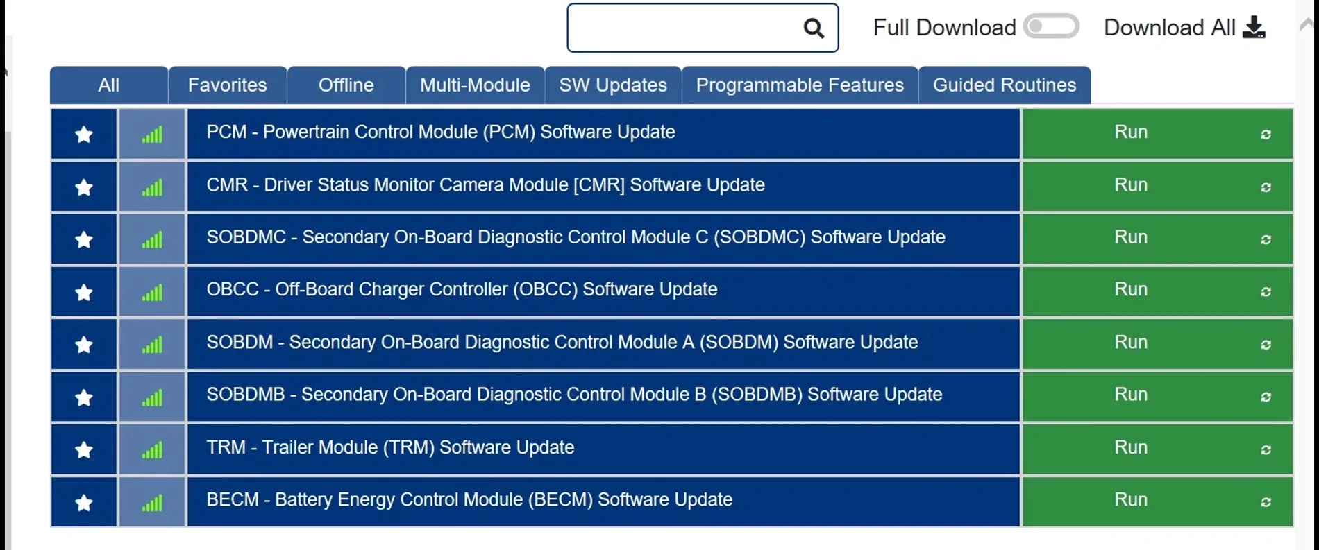

My ACM Update disappeared yesterday when I had Mobile Service perform the 25C69 Recall on the Integrated Park Module; it included SOBDMC, PCM, and ABS (maybe a couple more, I lost my screen capture). He also took care of the 26C10 Trailer Module update; same update is/was available on both my Lightning and my '23 5.0. I don't know if he just went ahead and cleared the ACM because it had an Outstanding Field Service Action. He said he had to enter a PIN to make those disappear from the list. Oddly, the paperwork shows he address 25C69 and 24U14 but makes no mention of 26C10.
Ford F-150 Lightning Lightning Software Updates using FDRS 1773951691496-re
I guess I'll find out Monday. Mobile Service is coming back out to address 26C10 on my 23 5.0. It does not show 24U14 ACM Update like my Lightning did.
