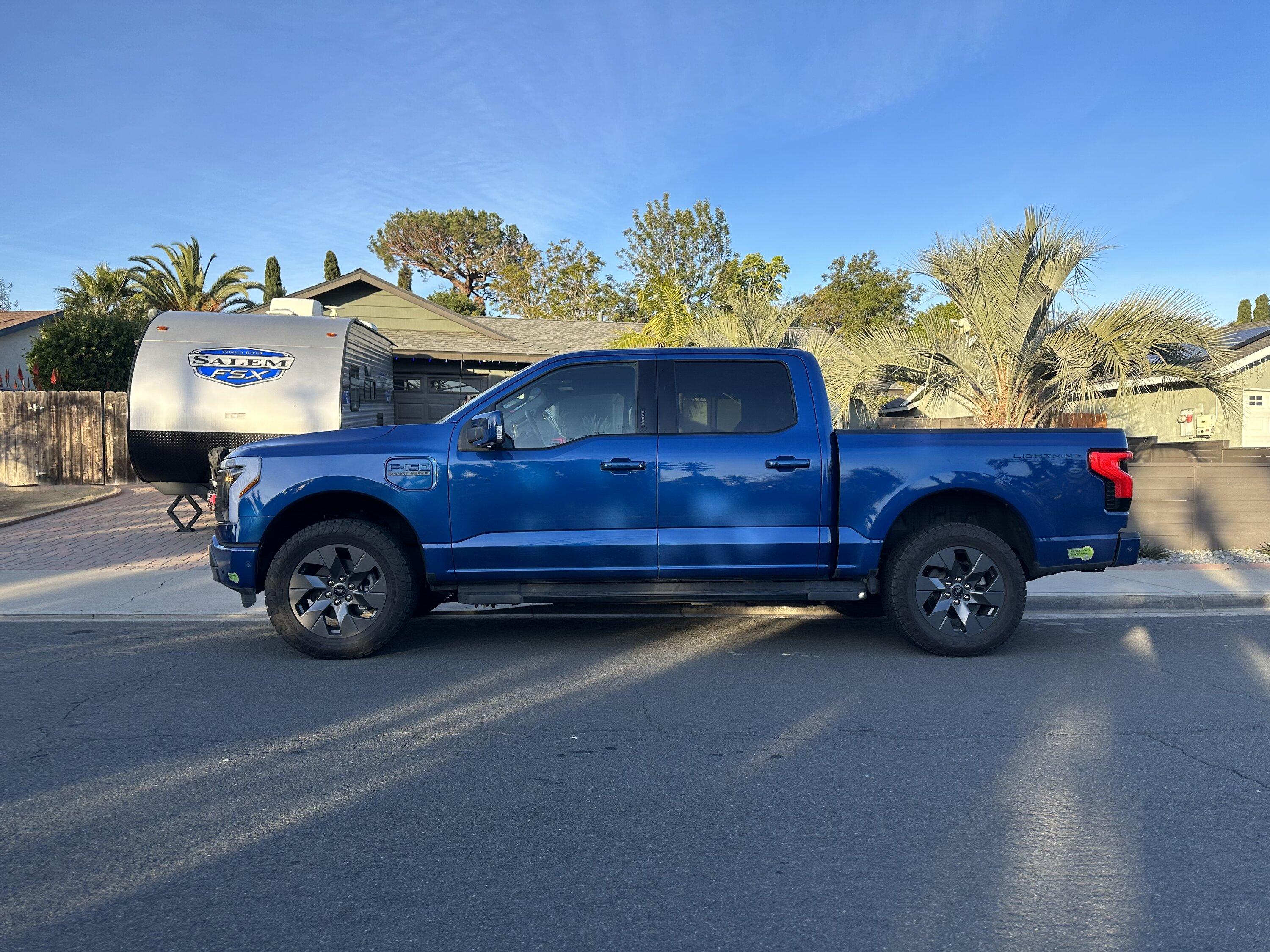

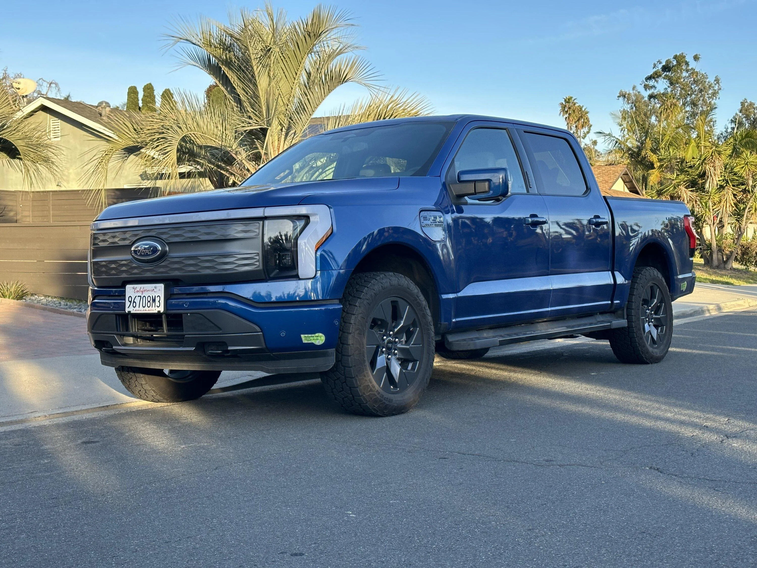

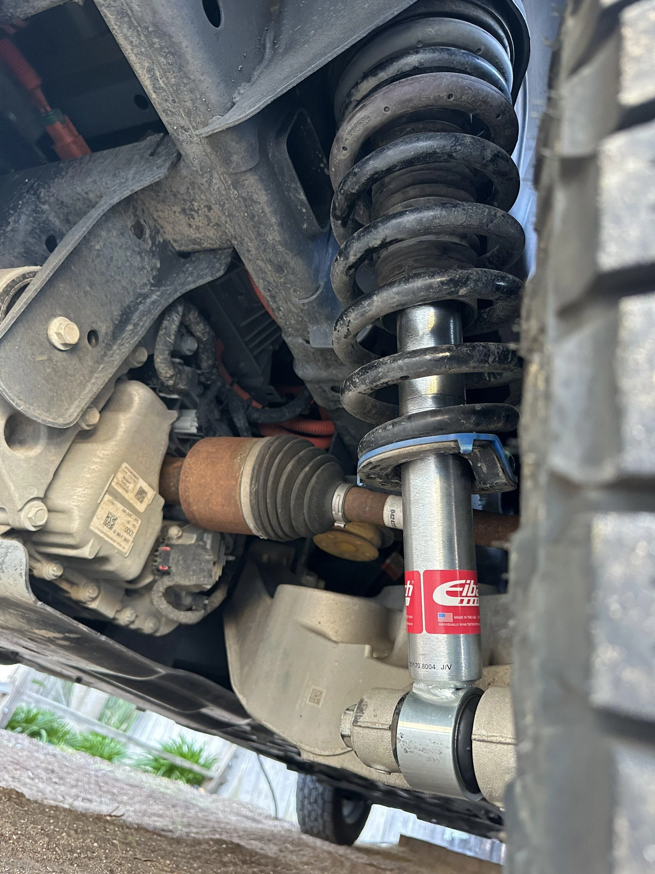

Ok I’ve had the shocks on a couple days now. They are fantastic and what I was hoping for. I went with a 1 inch lift in the front and kept the rear at stock height. However, it does appear the rear is a tad lower than before, maybe half inch lower in rear wheel well to tire distance. The dreaded old bed bounce is gone in the front. The only real con is you feel the small bumps on the road a bit more. But everything else feels better. Turning, off-roading, hitting curbs: all super plush now. There is a little whooped out trail near my house and I can go twice as fast now. Amazing. Just so much sportier and confidence inspiring now. Can’t wait to tow my trailer and rip around in the desert. Thank you Eibach!
