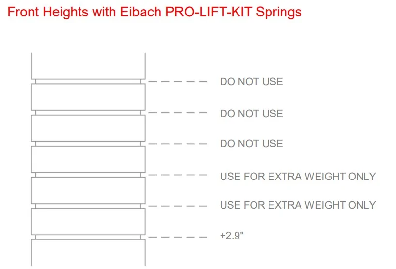

Did you verify clip placement with installers? There are additional clip settings on the front shocks/struts that say for "use for extra weight only".
I also read a post somewhere here or Gen14, where the installer placed the clip in the wrong orientation (top/bottom transposed). If that happened to your situation, it would be where the pic below shows "do not use".
Just throwing out some ideas.

We suspected the same thing. First I thought it was a marketing trick that they use the same part for both of them. Everything is installed according to the instructions. But the instructions are for ER and there is no such thing for SR. That made us wonder. We tried to contact Eibach to have an answer, nothing, yet. Because we used the bottom for all, which is 2.9 and 0.3.
Is it flat, yes. But it is a nightmare to drive it right now. I wanted to do everything according to the instructions in case I want to return them back.

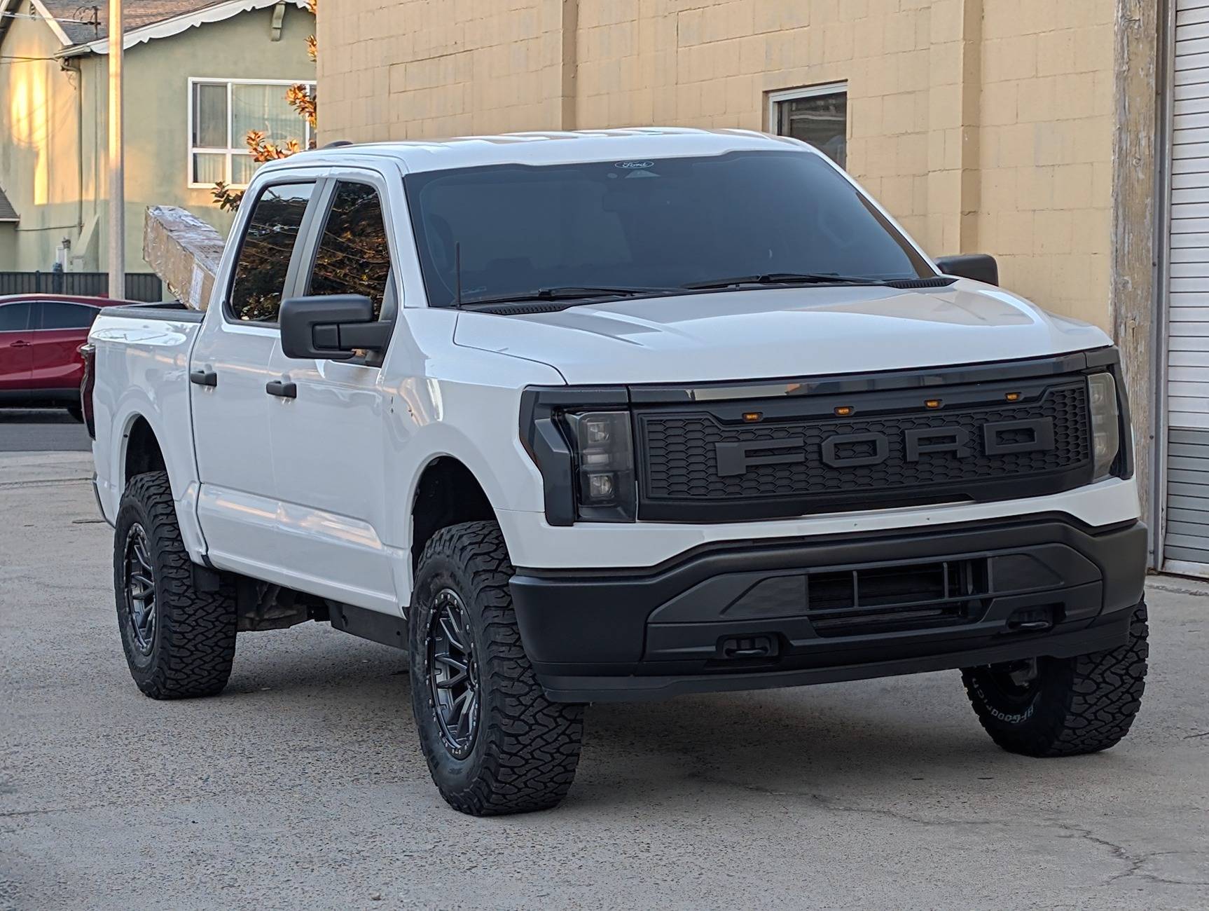

"No tire change" is not 100% correct actually. I have changed them as you can see in my profile picture.

Basically I'm using the one on the bottom level accroding to the instructions (let's say strongest). Since it's not heavy as an ER, I guess I'm not even using the shocks as I am supposed to, that's why it's not absorbing anything. That means I'm literally driving on the springs. Which is how I feel while I'm driving. Front side starts bouncing on a very little thing, even on a brand new asphalt. Maybe rear is the same as well but frankly speaking I'm not able to understand it since front does not allow you to understand anything else.
Again I'm not an expert, this is my first truck. I hope we can solve this. I hope Eibach says "oh that was a mistake, here is the instructions for SR, you should be using the top 2 rings" kind of thing and I can go back loving my truck.

I believe the bottom is "least strongest" if you will and the softest setting. If one chooses the "stronger" setting on a stock vehicle load, it would be stiffer/firmer.
