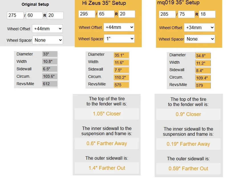

+34 will push the inside plane of the tire out 0.393 inches (great for tire rub issues). To look at it another way, with the same size tires you will have 0.393 inches more "poke" giving it about 3/4 of an inch wider stance.
I've gone back and reviewed some of my notes regarding other folk's rigs: glendawg619, and Oafy44 both had 285/65/20s (34.6x11.2) on the OEM 20s. I believe glendawg619 reported no rubbing, and Oafy44 said, "No rubbing except for reverse lock because I had mudflaps." (I assume this means they rubbed at the rear of the tire.) The 285/75/18s would be about 1/4 inch taller (diameter) and same width. So you'd be 1/8 inch closer to fenders etc. (radius). Based on what I wrote above, and what I've seen with my setup, I think you will likely not have any rubbing on the inside anywhere, but likely rub the front dam (would need to cut 1/4" off the edges, and MAYBE have some rubbing on the crash bars (I doubt it). I'd go for it!!
I too was reluctant to cut anything, but if the dam is the only thing you have to cut (my best guess), I'll bet you can pick those up used CHEAP (lots of people pulling them off) should you ever want to go back.

Setting aside the backspacing/offset topic for a bit, the first checkbox in wheel application (besides basic lug pattern and center bore) is its weight/load capacity.
I originally looked at the Tremor setup but never found the weight support of that wheel...but if it is not at least 2400 pounds, it's technically not safely supporting the weight of my lightning (at least under load and/or towing). Most aftermarket wheels I looked at were in the 2200-2500 range, and since my rear axle GAWR is 4800 (divided by 2 for 2400), the 2500 per wheel was the minimum I would apply. Of course we know the OEM wheels support that.
The puzzle of offset/rubbing on this truck increases (imho) when going with 35" diameter and 12.5" width tires. I think you can pretty much avoid both by going 34ish" and 11.5" tires (as you're looking at).
The stock wheel (and 35/12.5) as in @HI Zeus 's case, meant he needed to spacer it out to avoid rubbing inside the suspension area/bits & inner wheel wells (new tires were much wider than stock). The same application but going too far out (or with 0 offset wheels) means more rubbing at the lower bumper/lower valance. You have more play/flexibility going with 18 or 20 offset wheels but still not poking out as much for less drag/range.
Then, if still going 35" could be be rubbing the crash bar/tusks. As identified in other threads, some folks have all (tusks in front and behind front wheels), some either or (its kina nuts). Some folks remove them, some push/expand them.
After all this, it's about wheel/tire fitment after your exact suspension choices. The aftermarket or OEM springs/struts/UCA geometry then dictates the tire wheel/tire reality.
There is enough data posted from others on here to "match or copy" as much as possible to expect the same (or nearly similar) results.

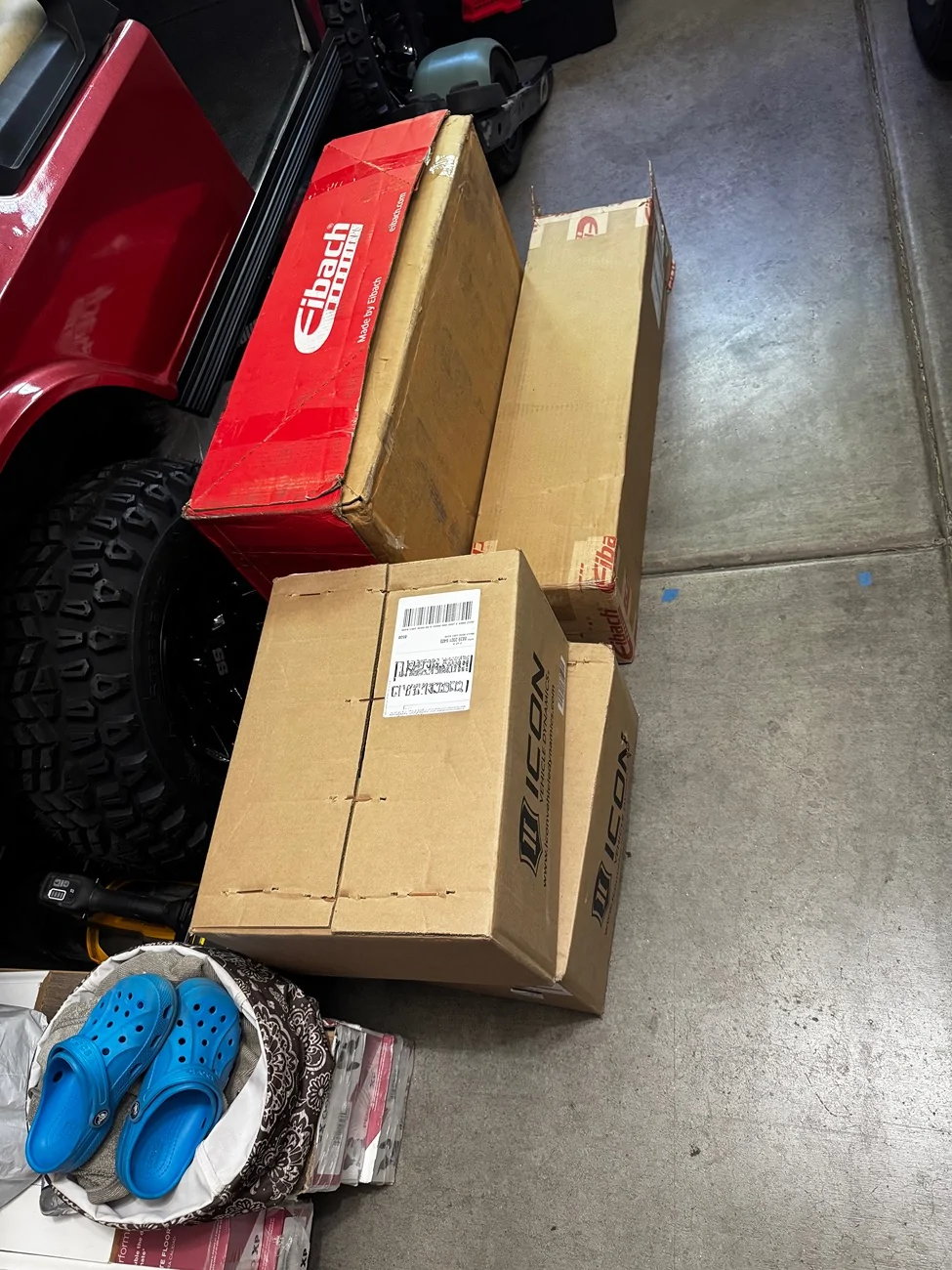

Thanks for your input. I took the plunge. Gonna try to install it this next week
Ford F-150 Lightning Leveled Avalanche Lightning (Eibach Stage 1 & 35" Wild Peaks) IMG_9786
