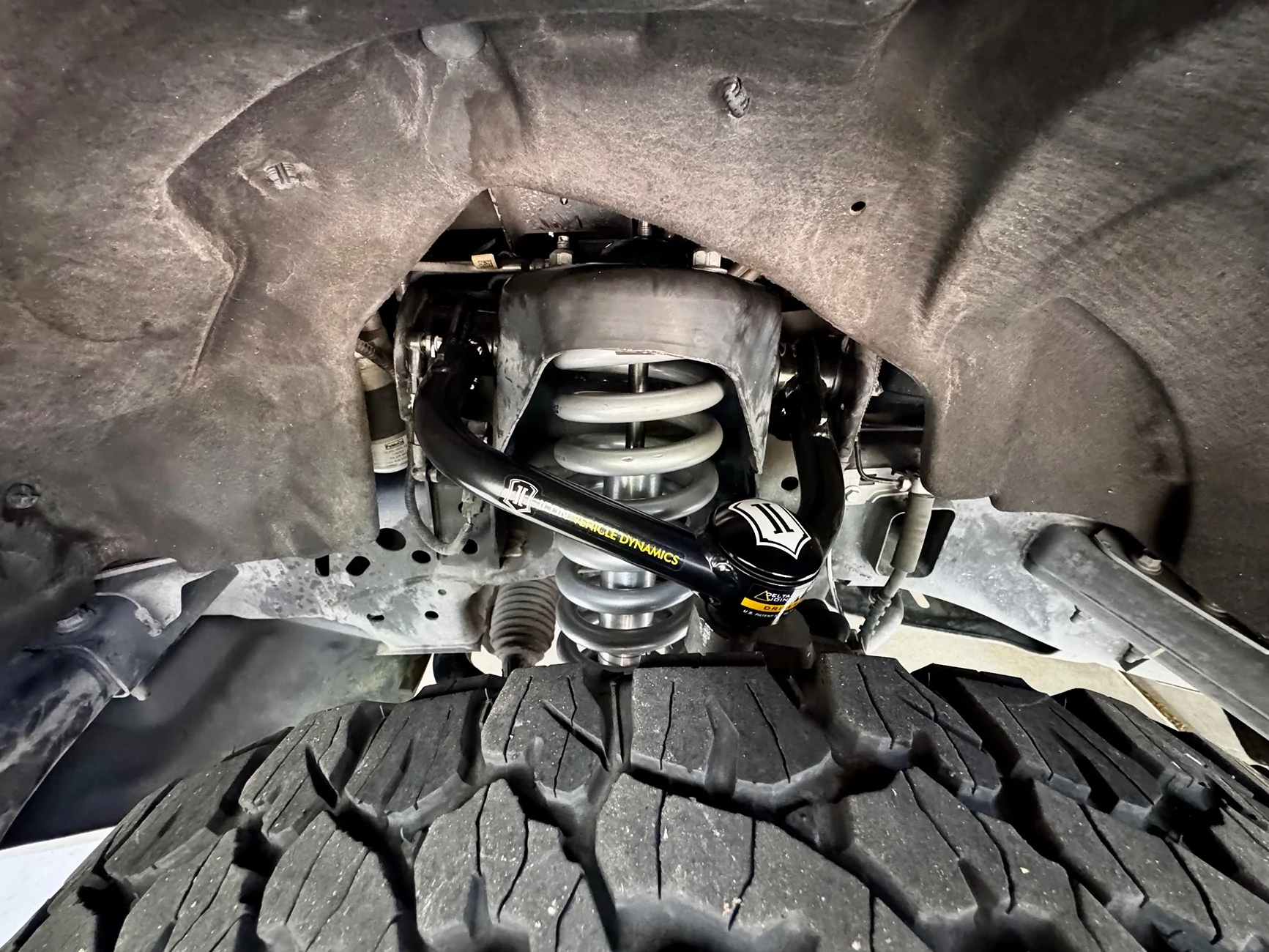

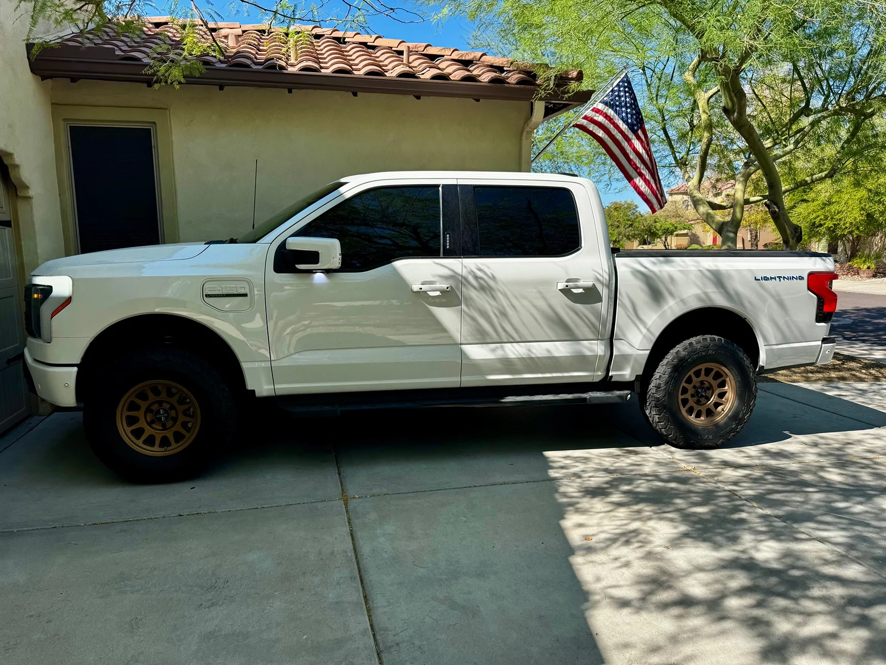

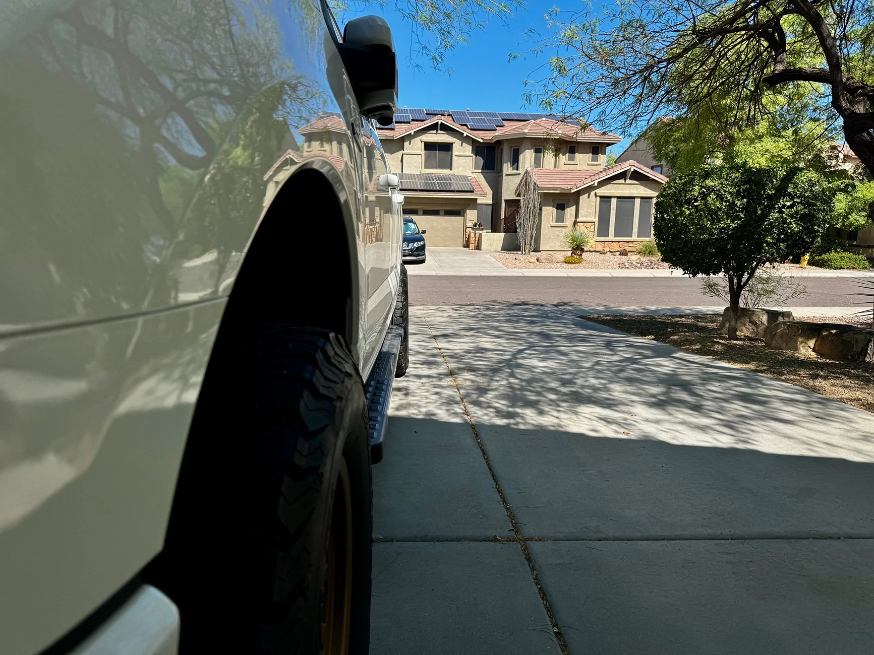

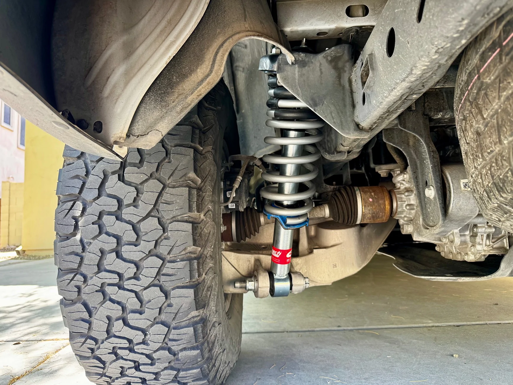

Well. That’s was a PITA driveway job but I’m very happy with the results! Thanks for all
Of your help with questions! After installing the front, I opted for .7 (2nd clip in the rear) and for what ever reason the front and rear are nearly level after letting everything settle! The camber is nearly gone! And the Icon Delta pro UCAs are great! Thanks again!

For better or worse I’ve gotten used to the hit. I leveled the truck on BFG ATs right after I bought it so I’m not accustomed to the “stock” range potential. 🫠

Best I can describe is firm but much more compliant. Not so bouncy. Like I feel dips but no more bounce afterwards
