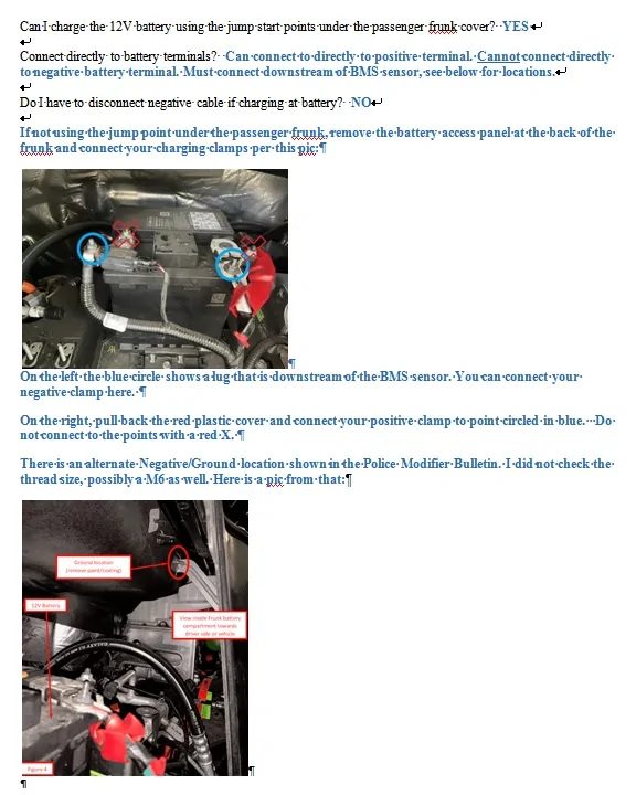

Yeah, you'll have to break the circuit, i.e., remove the negative terminal from the battery and put your ammeter leads inline. Make sure you are selecting the right banana jack on the meter.The amps scales route the high current through a shunt and measure the voltage drop across it.
