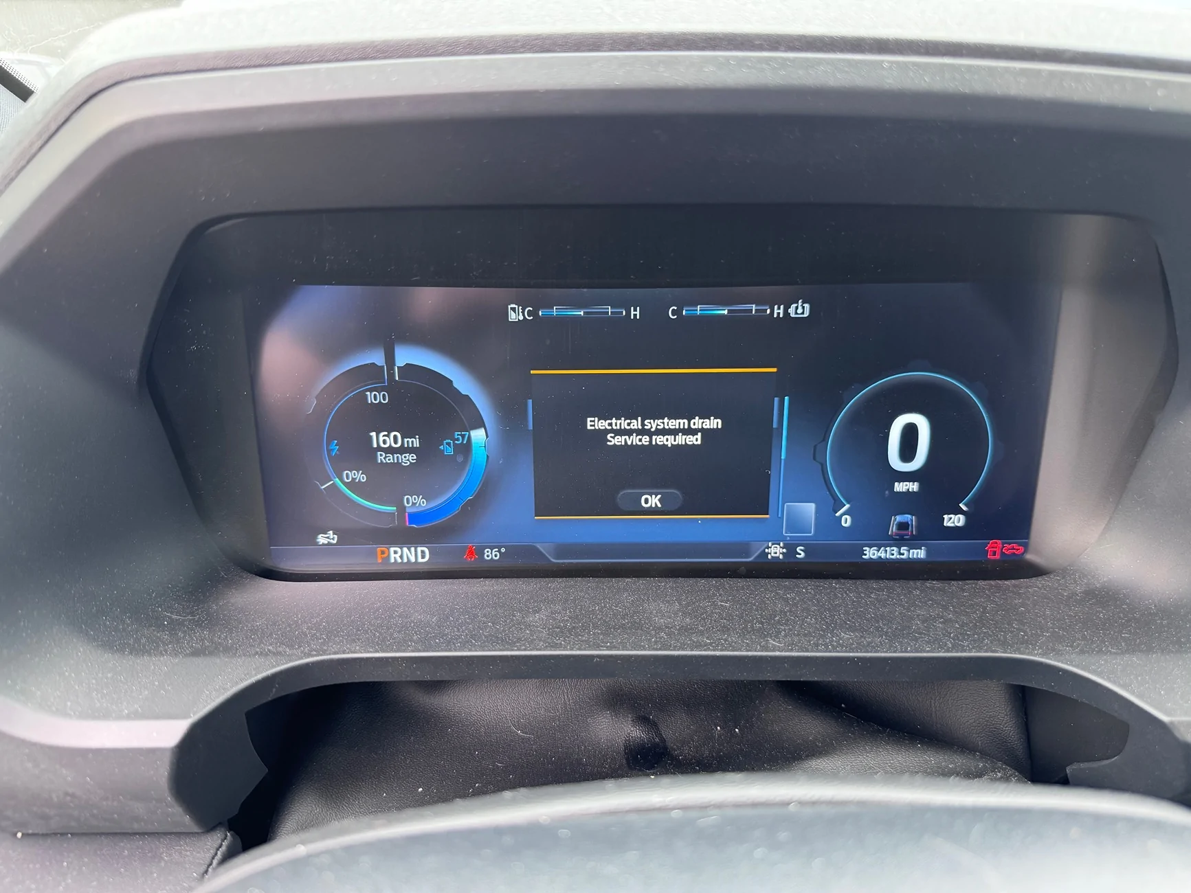

Electrical System Drain-Service Required Message

Any updates? I seem to have the same gremlin. A month ago, my truck went into battery saver mode, and a BMS reset fixed it after the dealer did a once-over. Now it has returned and says there is a drain. I have zero things plugged in or aftermarket like you.

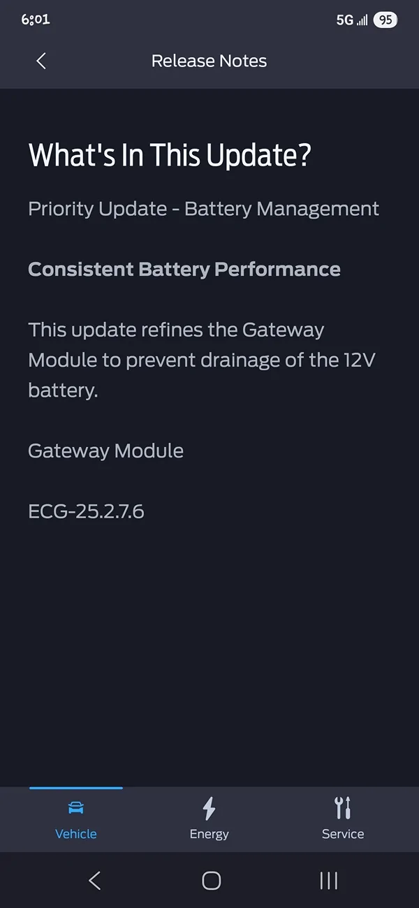

As of 9/30/2025, the issue may be resolved. The dealer had engineers from Ford physically come to look at the truck. They requested my permission to install “tokens” on various computer modules in my Lightning. I assume these are like cookies for a web browser, because I had to use DocuSign to give them permission to install these digital tokens. Apparently they let the engineers remotely track everything about how the vehicle is used and what these modules are doing at all times. The engineers then had the dealer perform manual forced software updates, to use the dealer’s words, “on a ****-ton of modules” (over 10). I was then allowed to take the truck home (on 9/19/2025) while the service ticket was kept open so the engineers could continue monitoring everything in the Lightning’s natural habitat. In the past 11 days, I have had zero problems. I am hoping to get a clean bill of health and my paperwork showing exactly what was updated in the next few days.
I am not sure why the first step taken by the service department at my dealer would not have been to ensure that every possible piece of electronics that uses software was updated. I can only guess that they are more accustomed to dealing with hardware issues. When I have more detailed information, I will post it.
