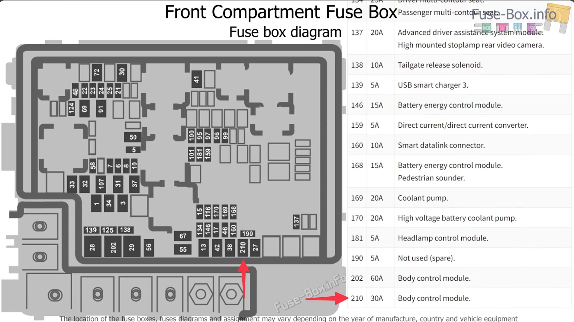

Update: I tested every breaker in both the frunk and the passenger-side panel. The only notable change was when I removed fuse 210 in the frunk panel, the current draw dropped from a steady 8 amps to 4 amps.
Fuse 210 is referenced as the Body control model. I dropped the vehicle back at the dealership this morning. They said I was only $200 CAD in the hole for diagnostic fees based on their hourly rate, but hinted that a considerable repair bill was coming since it will most likely require replacing the BCM.
This kind of sucks. I'm used to working on simpler vehicles, and it seems like I'm pretty much at the dealership's mercy here, since they can basically say it's anything. On one hand I wouldn't be surprised if this is fixed with a software update, on the other hand I'm looking at a 2-3K repair bill for a new BCM.

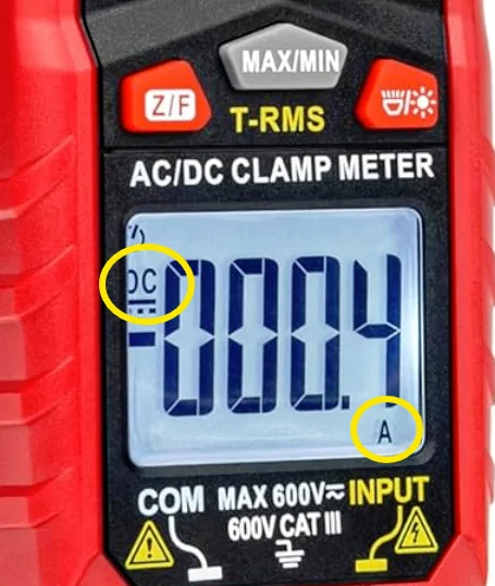

I have a BTMETER BT-570 (amazon) clamp meter with bluetooth which can measure DC current and can log Amps over time. It's showing -1.8A on the + battery cable when charging. 8.4A when not charging (frunk light is on, probably other loads as well). I plan on logging the 12v battery power when I get a chance... I recently had mine in the dealer for factory recall issue and asked them to look into a "powertrain malfunction" error I received earlier. They said they didn't see any issues and just reset the DTC codes. Luckily they didn't charge me anything but I'm not too confident they'll be helpful in the future.
