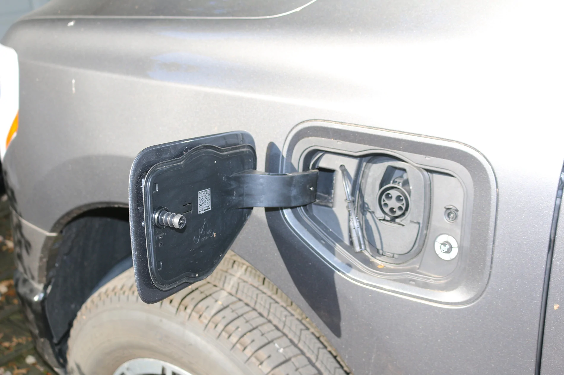

Yes, much easier to have a cable handy to plug in a charger right there at the charge port:
