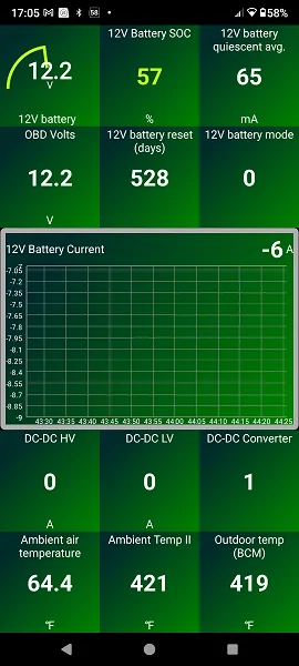

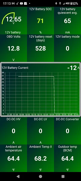

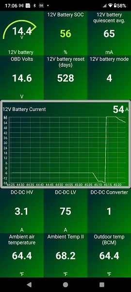

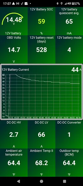

Well, this is interesting. Shortly after I posted the message above, I went out to the truck, got in, and brought up CarScanner. Note that the truck is in Silent Mode so no lights were on. I did not turn on the truck. It was showing a 12 amp load on the 12V battery which changed to a 6 amp load a minute or two later. Voltage was just over 12 volts. Turned on the truck and immediately saw the voltage climb to over 14 volts and charging current to 60 amps. The current tapered off fairly quickly. Used CarScanner to read DTC codes and saved them. It's a long report so I'm not going to post it here, but it can be read in it's entirety at: http://k6ccc.org/DTC_2025-11-29.txt
Below are screen captures of the CarScanner LVB page through this. You can see the time from my phone at the top of each image

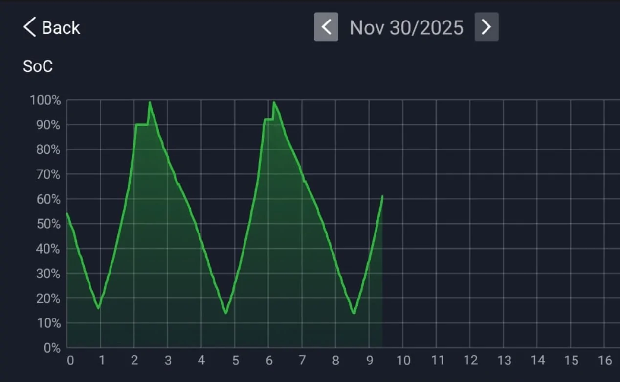

Got Bluetooth monitor installed, nice recommendation. After parking the vehicle the battery immediately begins discharging over about 3 hours, then once it hits 15%, the HV battery recharges it to 100%. This was with the vehicle not plugged in.
I'm assuming these constant cycling can't be good for the battery. I wonder if it's possible with forscan to adjust these numbers so it's not fully discharging or charging.

@lister coggs you have a serious parasitic drain problem. The pattern indicates you are pulling around 6 amps continuously if your battery is healthy. It seems your truck is not shutting down properly due to some condition like a door ajar or something similar. It takes about an hour to charge a healthy battery and your charge cycle looks about right.
It doesn't look good. Lol.
There's no physical evidence of door ajar, lights on, etc. Nothing like that.
I have another appointment with dealer booked for Thursday. In the meantime, I'm going to get a FORscan adapter. Looks like you can monitor module sleep states with that.

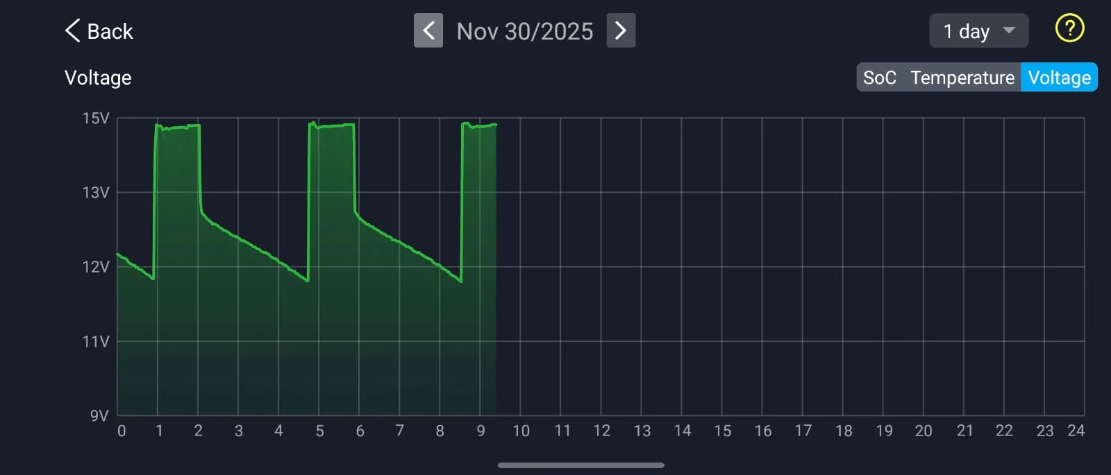

Here is the same chart with voltage over time which shows a similar trend.

The monitor only estimates SOC based on the voltage trends so it can be off a bit since it doesn't directly track the current in/out of the battery like a BMS, but it is close enough to show the trends pretty clearly.
The voltage chart doesn't show the SOC trends as well, but it tells the same story. Something isn't shutting down properly in the truck. I'm curious how many cycles it will charge/discharge before going into sleep mode. On my 2023, it would only do it once initially. Ford updated that charge profile sometime in 2024, I think.
Another thing to watch. When the truck goes into sleep mode, does the drain still happen?
Any chance you have or know someone with an infrared camera? If you point it at the fuse box and snap an infrared photo about an hour after shutting down, without a keyfob or PAAK around it may tell you which fuse is carrying the current. The problem is you need to sit in the truck and wait for 45 minutes to get the picture since opening a door will light up the modules.
You woke up the truck by opening the door, polling the modules via OBD will keep them awake and/or wake them up even though the truck is otherwise off, hence drawing a lot of power.
This is the reason why I monitor the 12V supply to the dongle so that I don't keep making requests once the truck is off - as that would drain the 12V / LVB battery.
