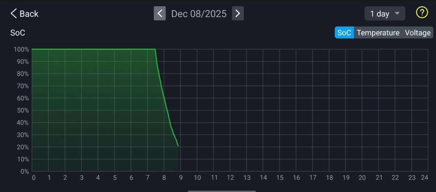

I put the monitor back on last night. The symptoms are the same as before I gave it to them (SOC stays at 100% when the HV battery is plugged in, drops immediately when not connected).

The monitor only estimates SOC based on the voltage trends so it can be off a bit since it doesn't directly track the current in/out of the battery like a BMS, but it is close enough to show the trends pretty clearly.
The voltage chart doesn't show the SOC trends as well, but it tells the same story. Something isn't shutting down properly in the truck. I'm curious how many cycles it will charge/discharge before going into sleep mode. On my 2023, it would only do it once initially. Ford updated that charge profile sometime in 2024, I think.

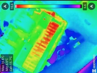

Any chance you have or know someone with an infrared camera? If you point it at the fuse box and snap an infrared photo about an hour after shutting down, without a keyfob or PAAK around it may tell you which fuse is carrying the current. The problem is you need to sit in the truck and wait for 45 minutes to get the picture since opening a door will light up the modules.
If you're curious, I tried an infrared camera on the passenger fuse panel and this is what it showed.
I tried taking the top fuses out and the parasitic draw remained, though, so I gave up on that technique.

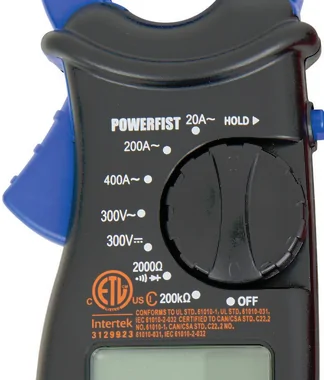

It looks like that one will only do AC amps, not DC. It has the sine wave symbol next to the 20A, 200A, and 400A scale. That indicates AC only.
If it did DC there would be a horizontal line with three dashes below it. Note for the Volts scale there is a setting for 300V AC (sine wave) and 300V DC (line with dashes).
If it did DC there would be a horizontal line with three dashes below it. Note for V=Volts there is a setting for 300V AC (sine wave) and 300V DC (line with dashes).

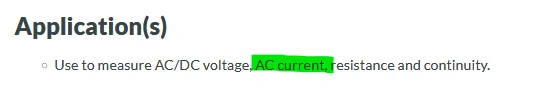

From the description: "Measures AC/DC voltage, AC current".
I'll probably just set up my regular multimeter for the testing. Confirmed it can measure DC current.
