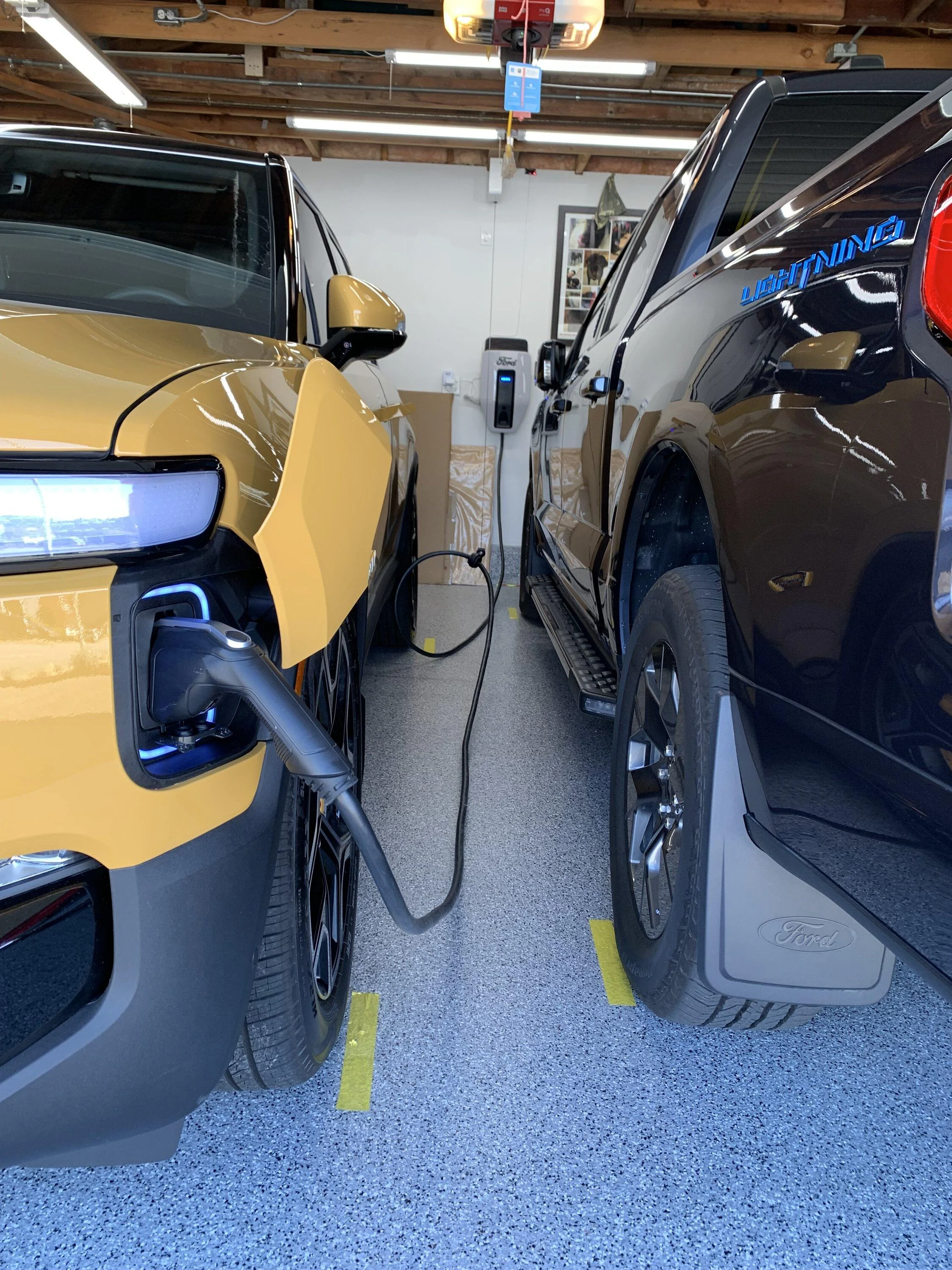

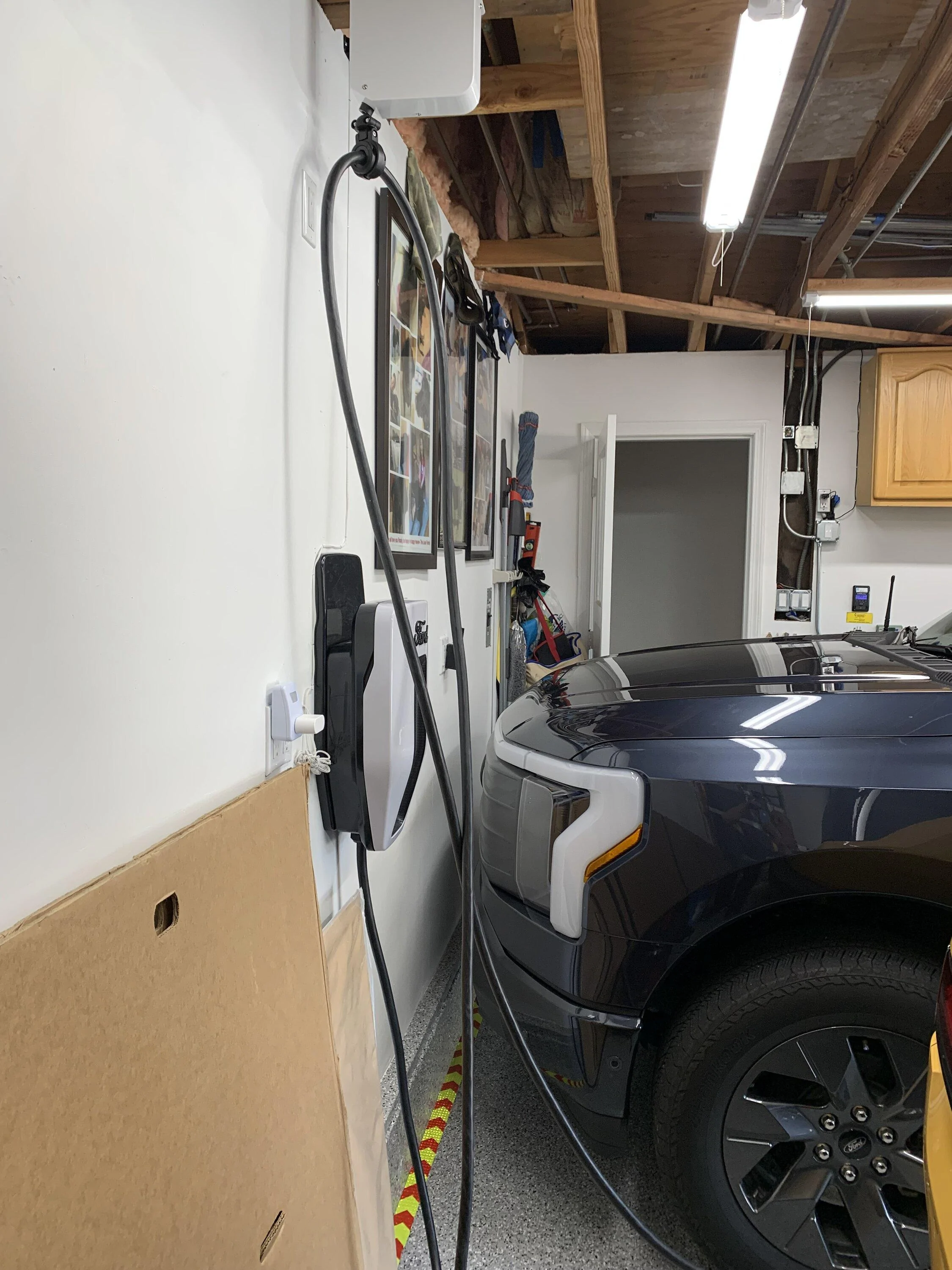

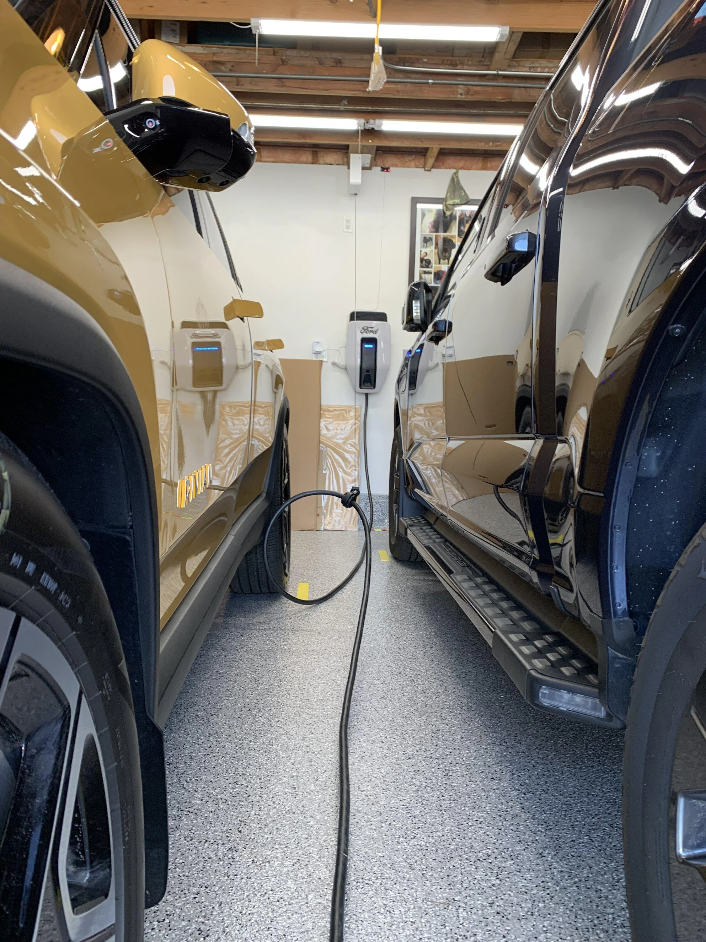

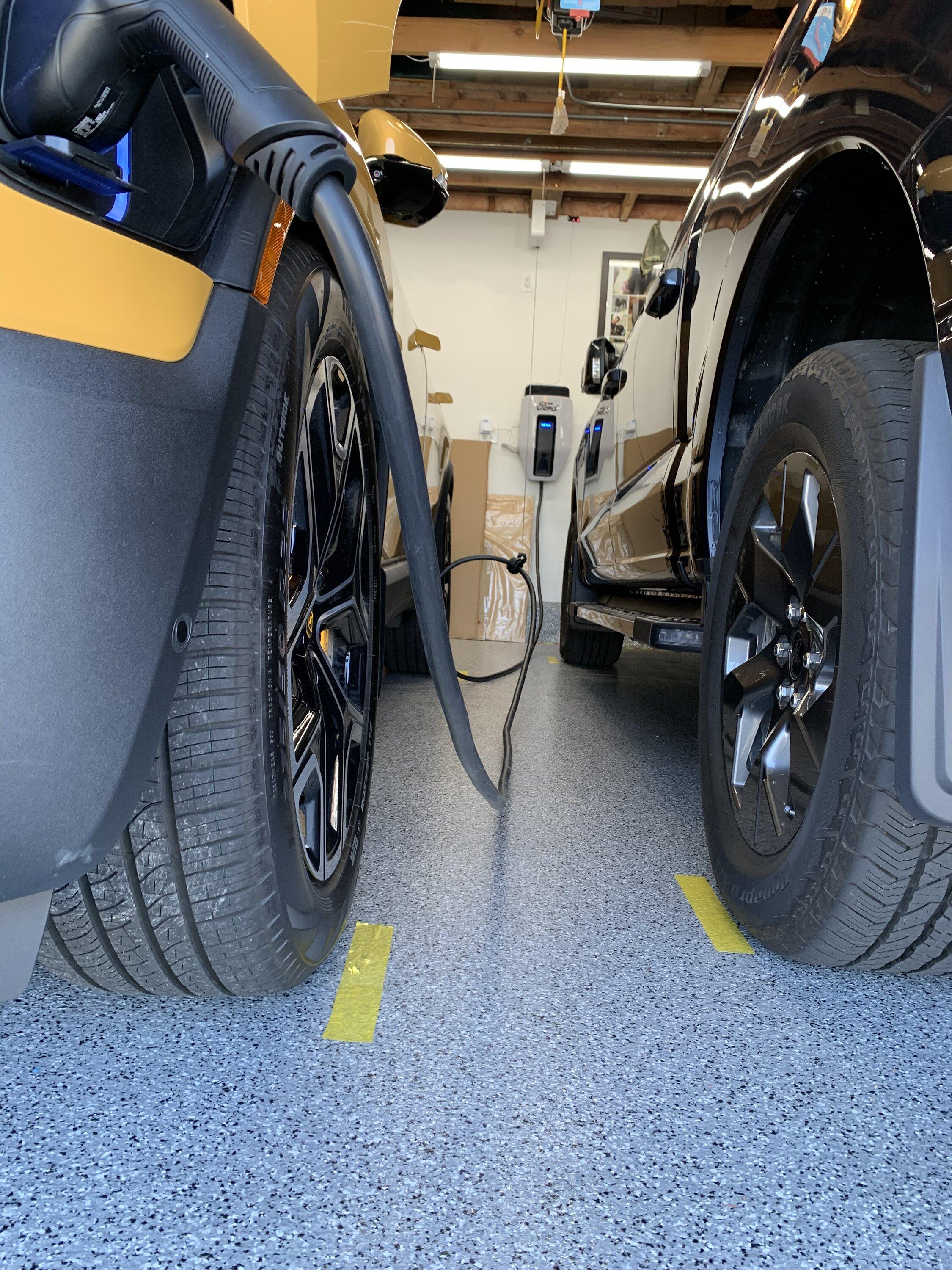

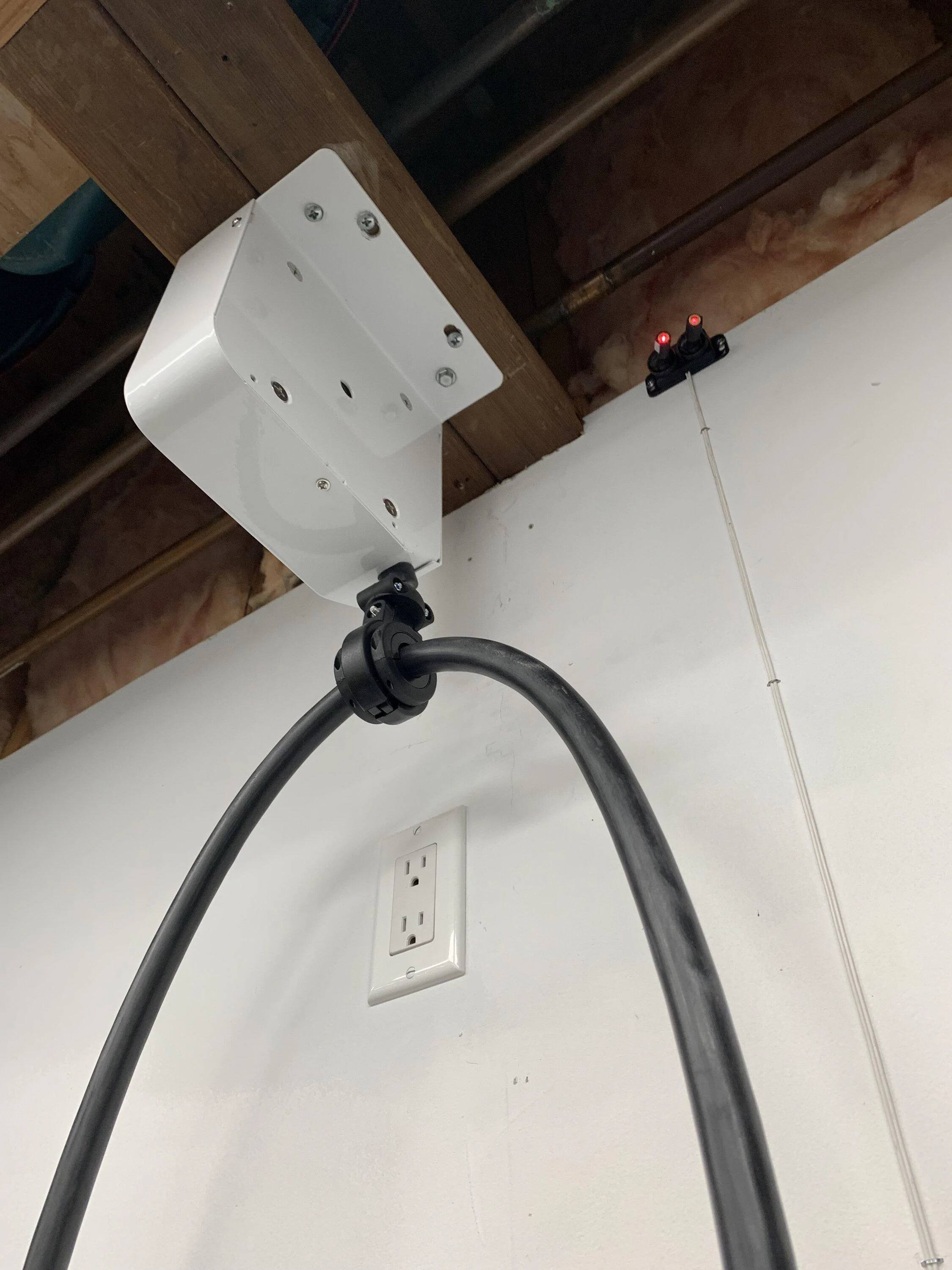

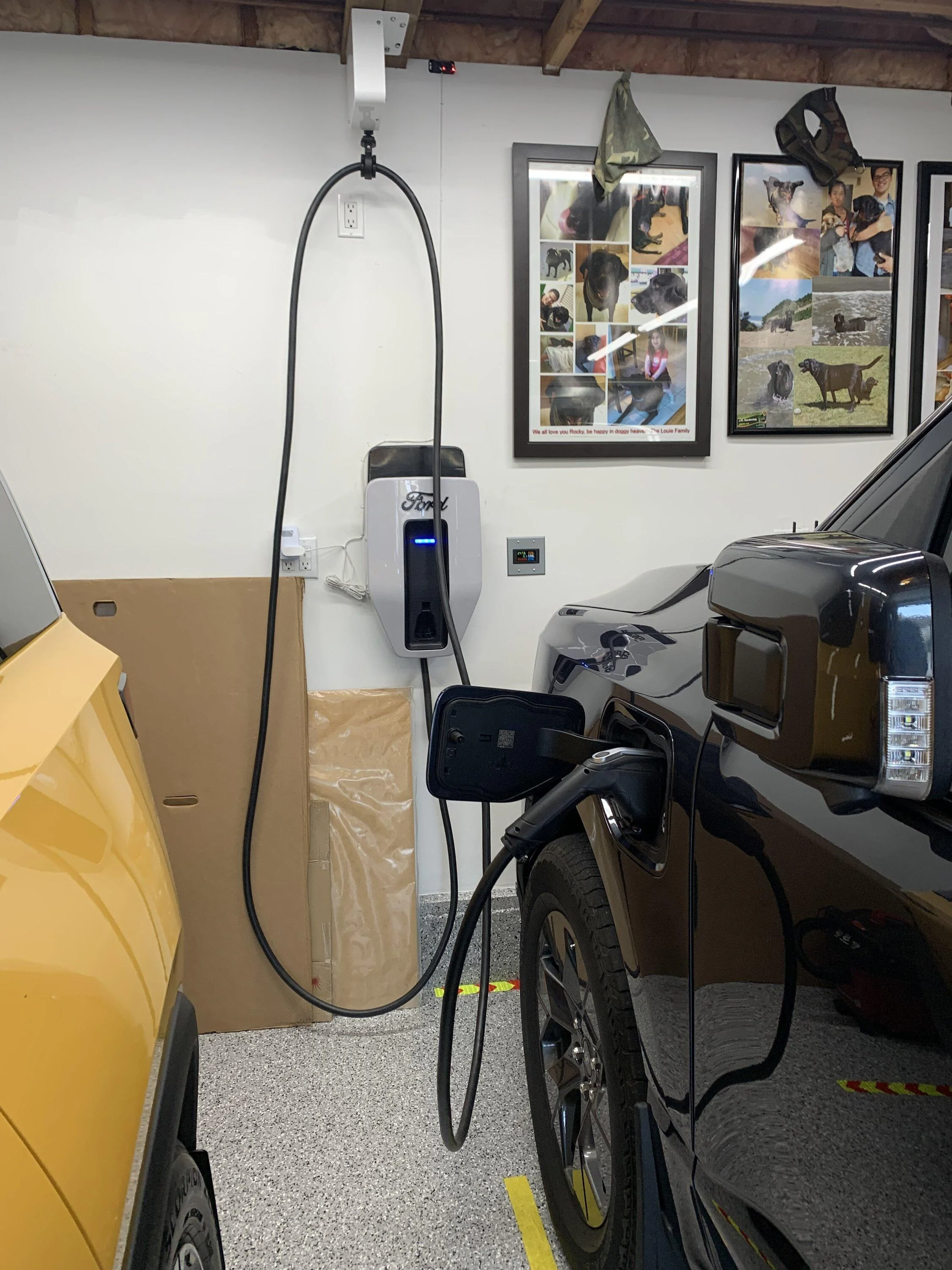

Got this on Amazon. Emporia EV retractor. Works good. Solidly built, cable locks in place with slight pull and stop. Keeps the cable off the ground. No need to keep rolling back the charging cable every time before and after charging.

Price is absurd.

I'm thinking you can buy one of those retractable extension cords for $40-$50 and modify it to do the same thing. Chop the ends off and attach a clamp. (i'm not talking about using the extension cord to charge, just as a retracting cable)

Someone posted on the Mach-E forum where they bought a bunch of cheap keychain retractors, and used a curtain rod to slide them along the ceiling.
I wouldn't pay $200 to hold my cord.

A plain ol' spring/tool balancer with or without a ratchet function seem like a much less expensive solution, then again, to some an hour of effin around is worth a lot more than the $100-150 that it would save you, so to each their own.

A quick search back on Amazon and there is a tool balancer with the same 11lb max rating as the EV retractors for $55! Good recommendation, an eyebolt and this will be just as effective as the pricy options I think!
