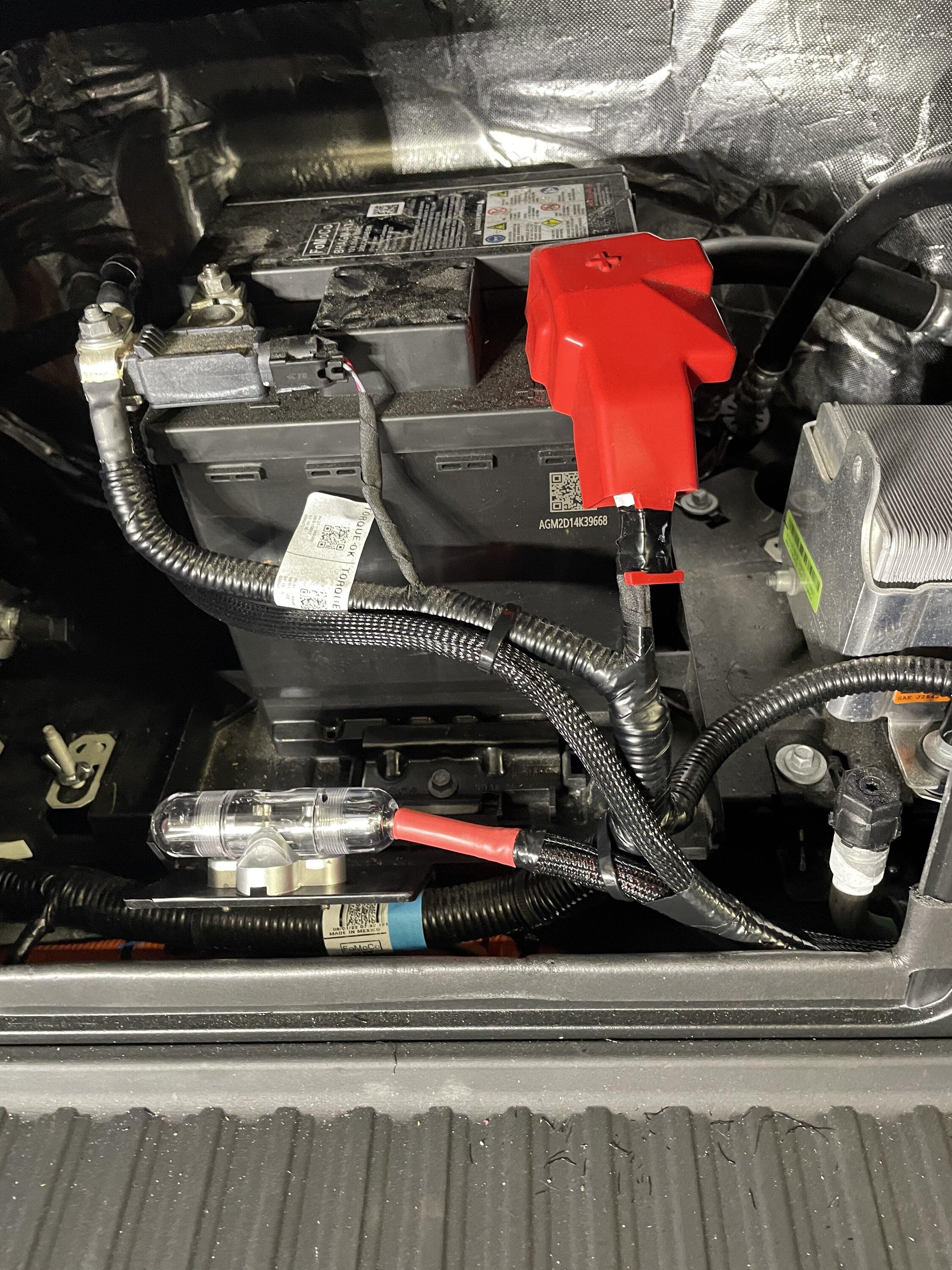

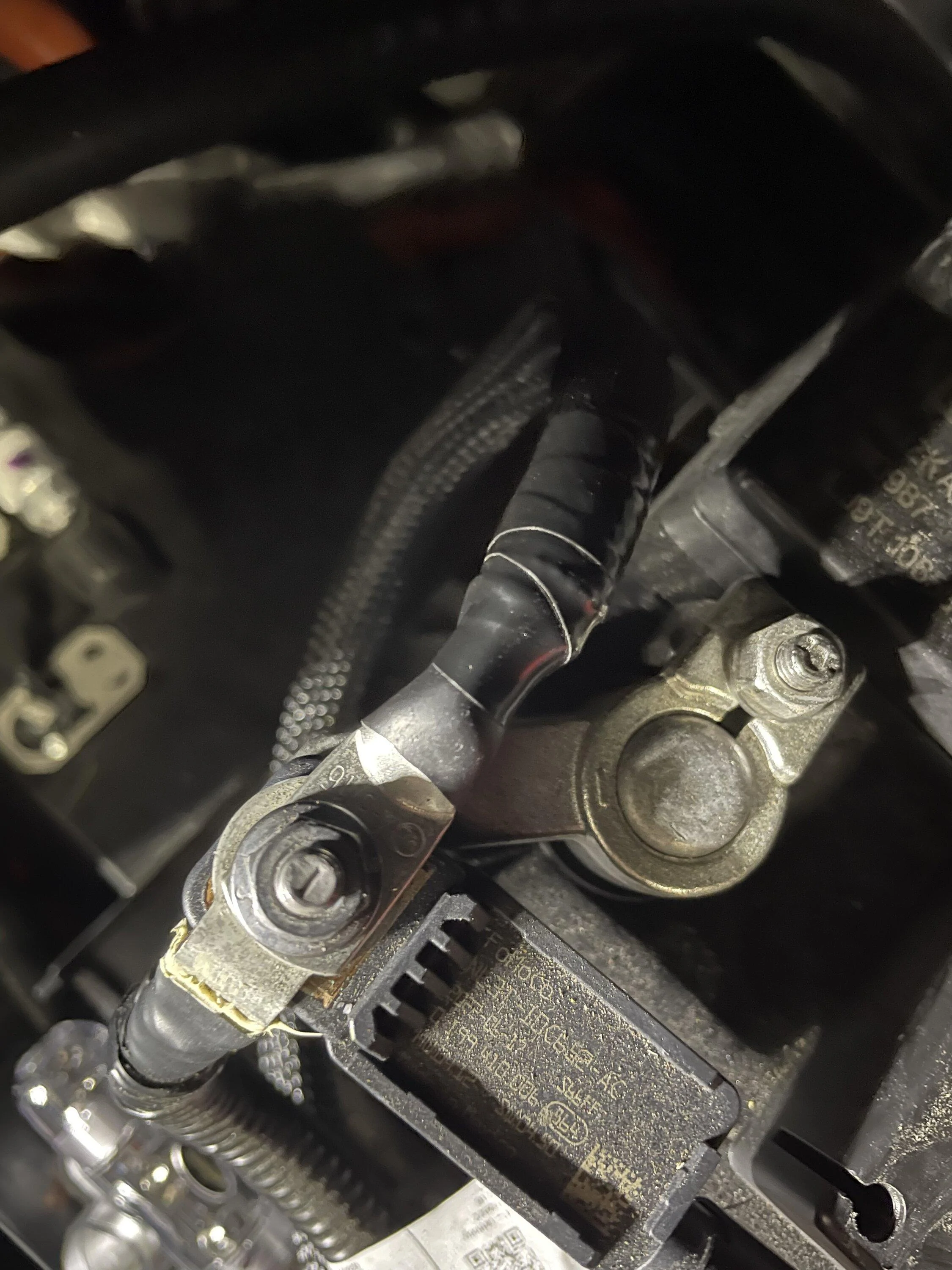

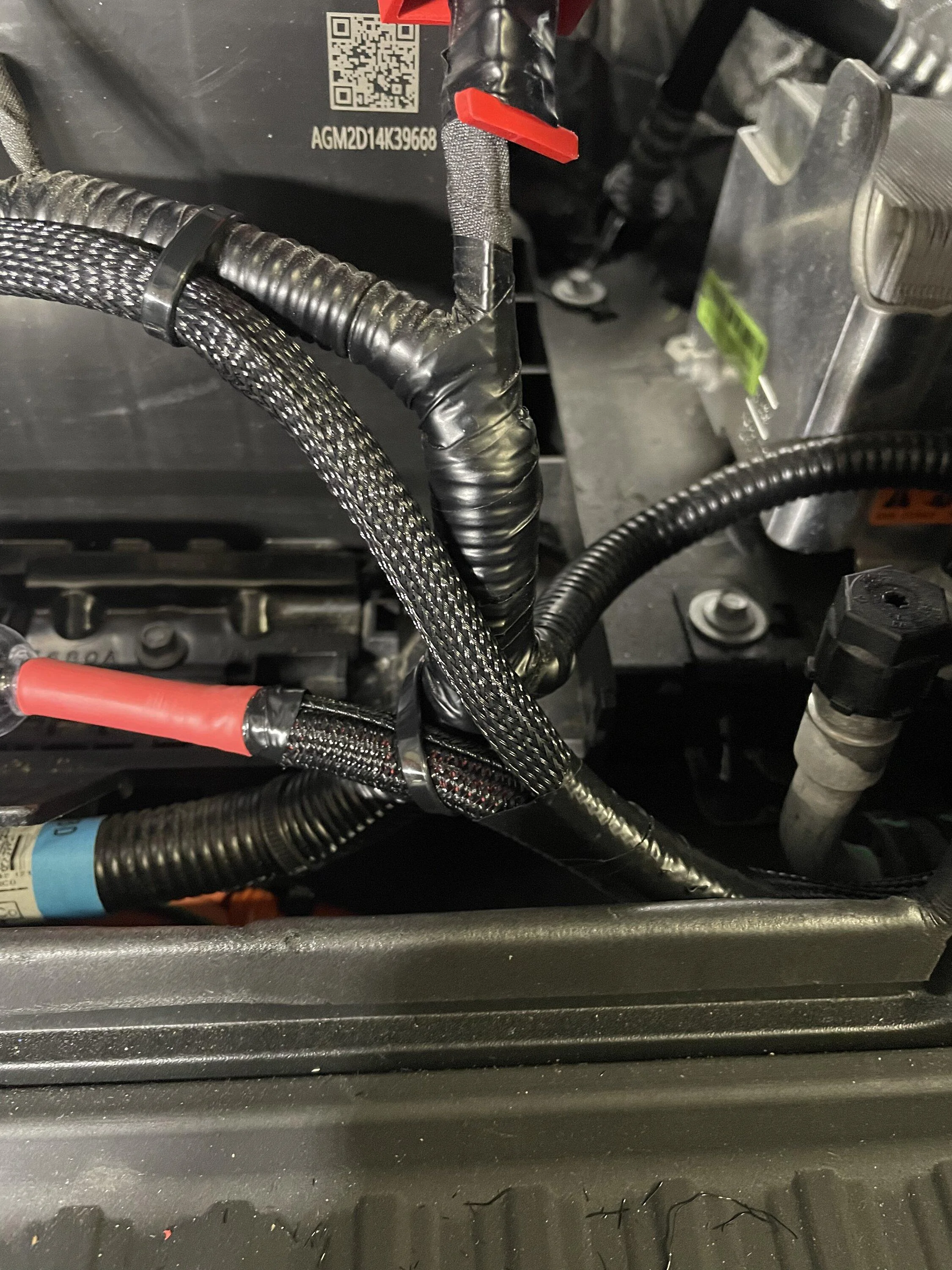

Couple shots of my idea for fuse holder and ground also Hooked up
That is exactly where I put my fuse. I was able to get two screws in it. I think it will stay put.

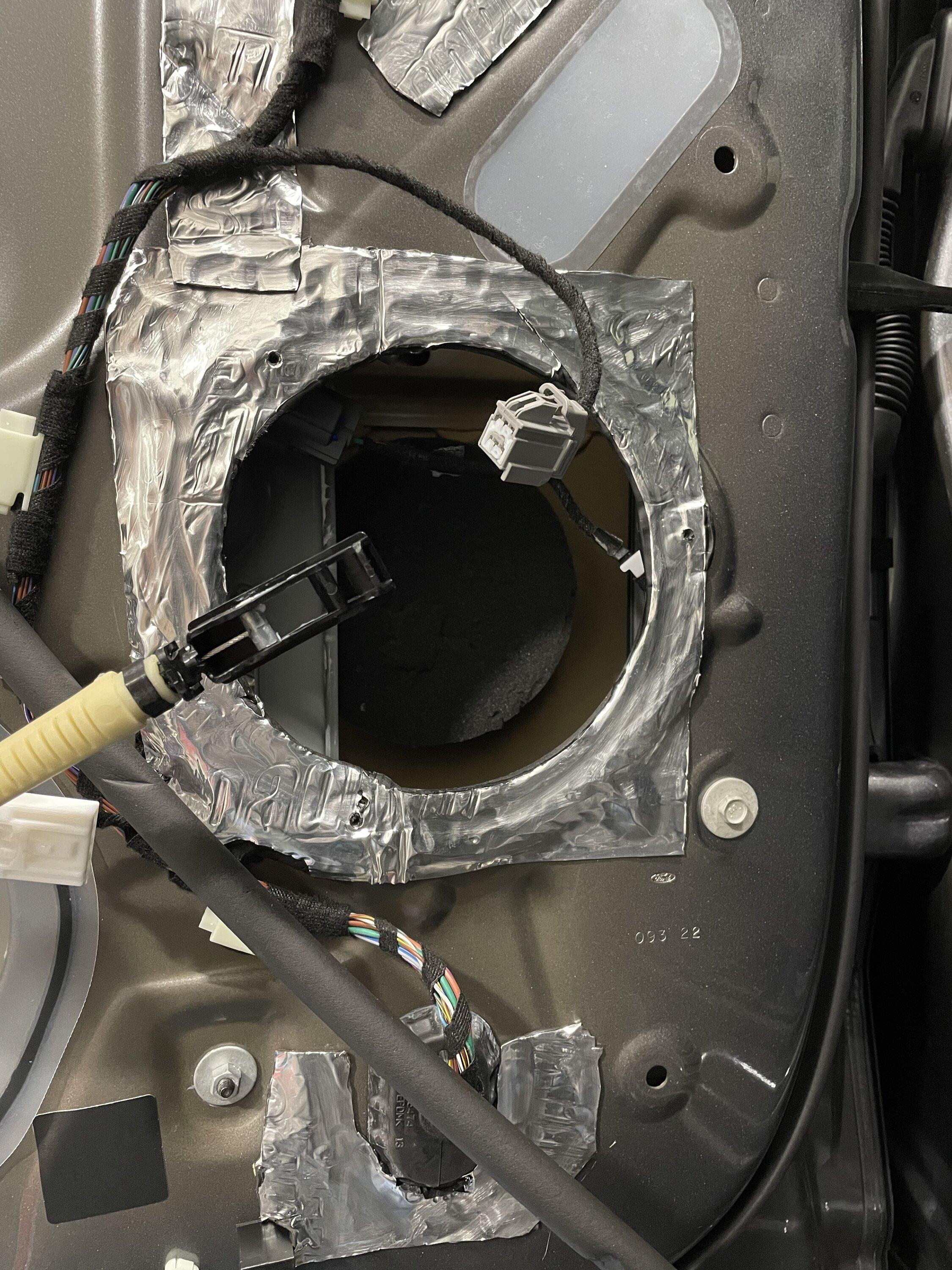

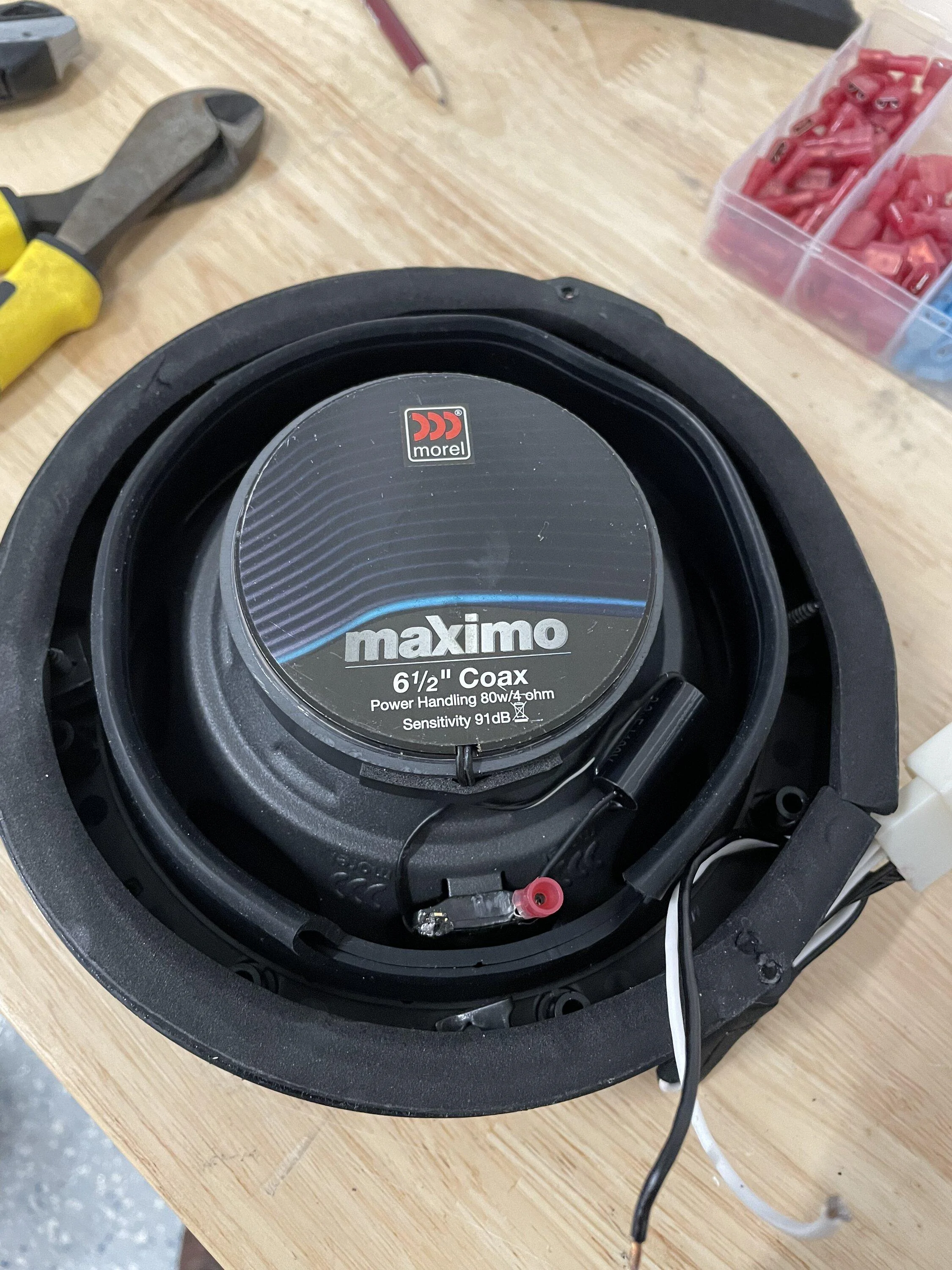

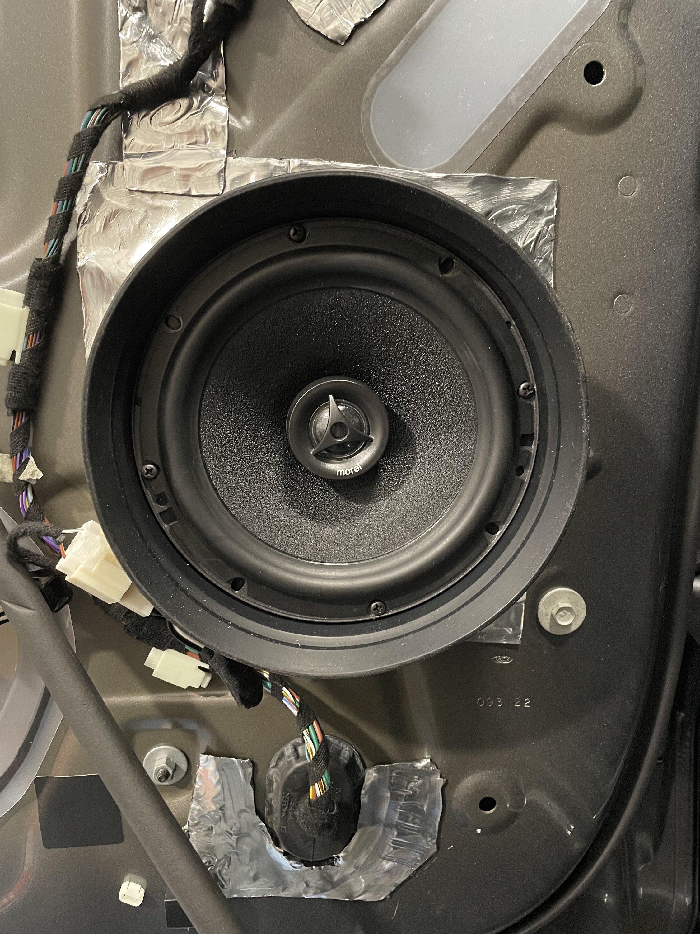

Slow process, but this is some rear door work I did this weekend. Morel 6.5 coax, metra speaker adapters, Install bay silicone baffles, and small amount of stinger roadkill.

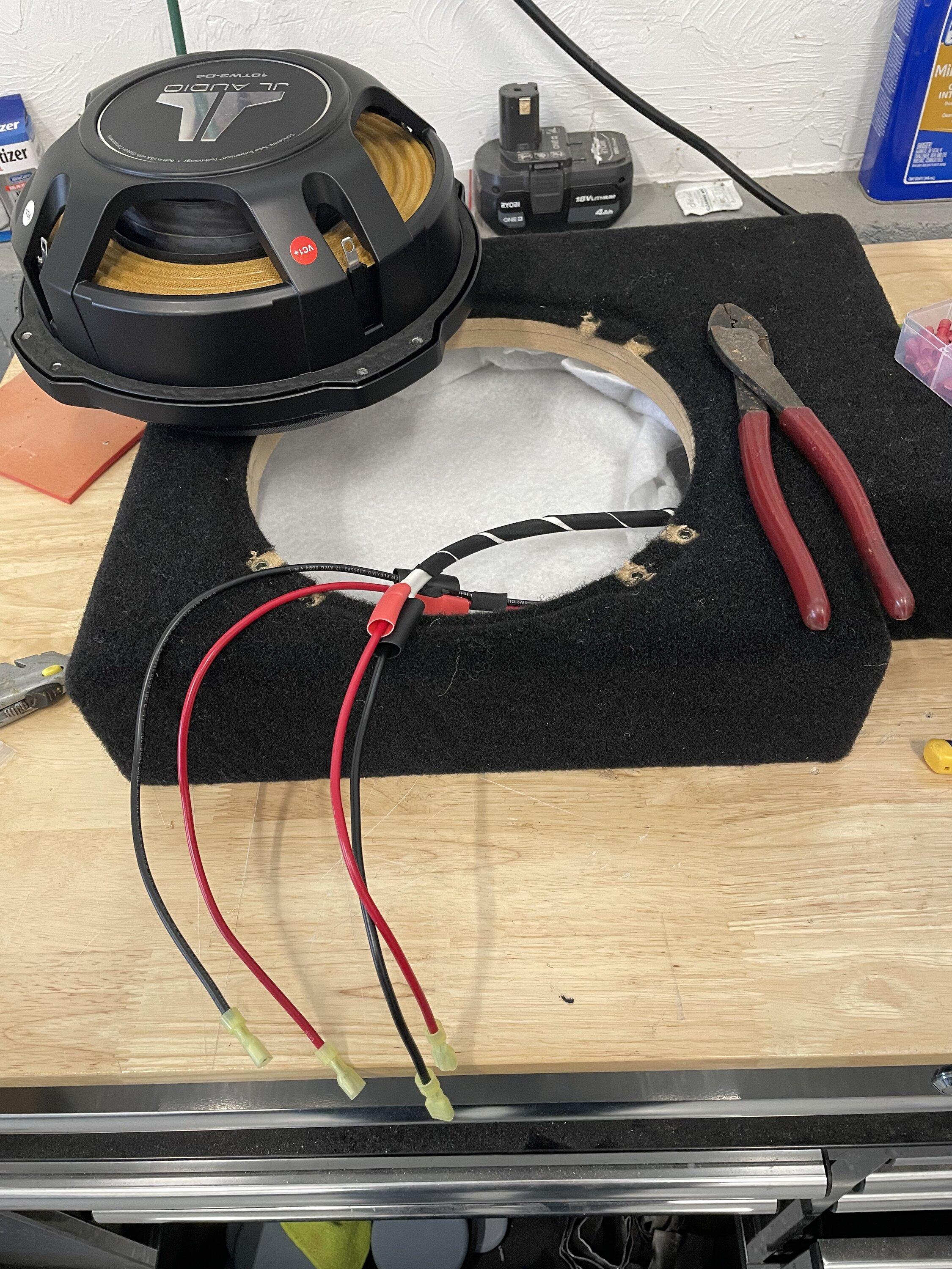

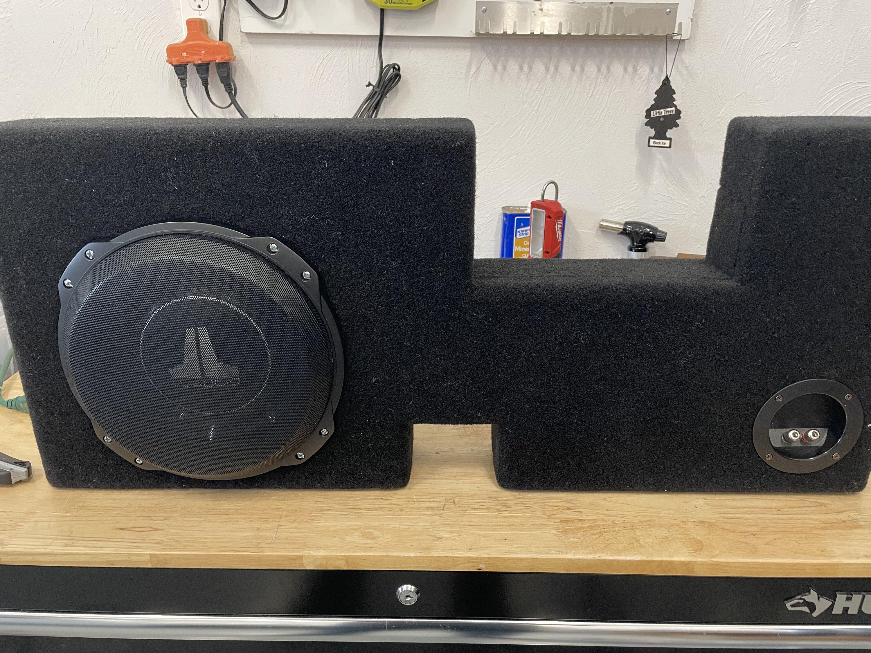

Started to wire and install sub in box today. It’s an mti box, I didn’t make it myself. I added the poly fill and did the wiring.
Very nice. I've got the same box/woofer. Purchased it already assembled. I see you are wiring both voice coils. Mine were already done which was a good thing, because knowing they both have to be wired is all I know. I assume just using a splitter from the inside of the wiring posts.
Did the mesh cover come with it? I'm thinking that is sold separately, but I need to get one just for protection sake. Mine didn't ship with it.
How deep is that box? Their site lists it at 4”, but not sure if it is 4” without the sub in? Curious to know if you have any issues getting the seat latched up when it’s installed?
Looks like it’s made mostly of 1/2 mdf with 3/4 mdf reinforcement where the sub screws in?
Thanks for sharing!
Hi, I had the woofer and grill from a previous build. The grill is a seperate part from JL. I don't think it will fit with the grill, I will probably have to remove it. But behind the seat its not at risk of getting punctured.
Thanks for sharing!
Its about 3 5/8 - 3 3/4. But not quite 4..
The front baffle is about 1" maybe. But the rest Not sure.

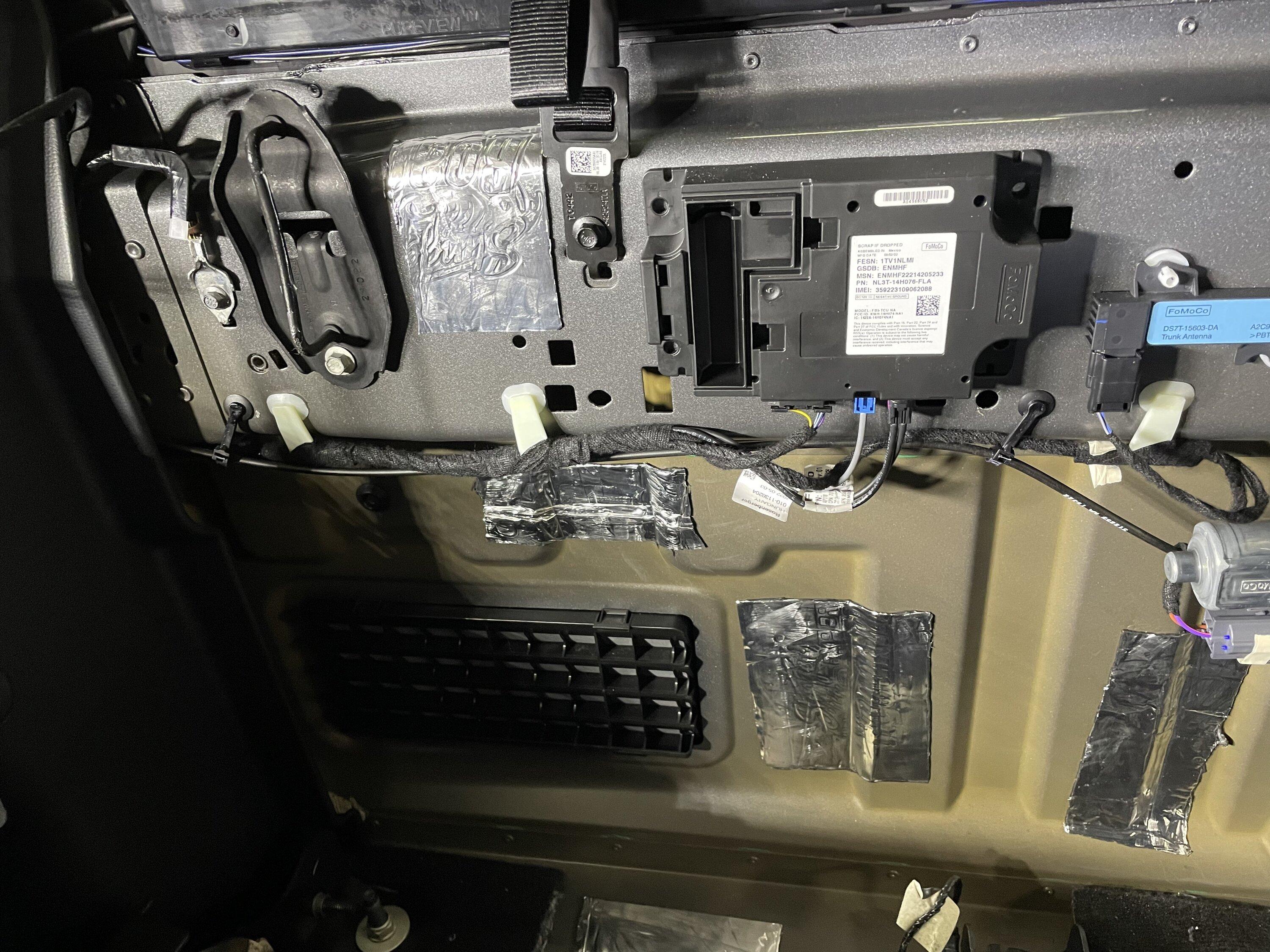

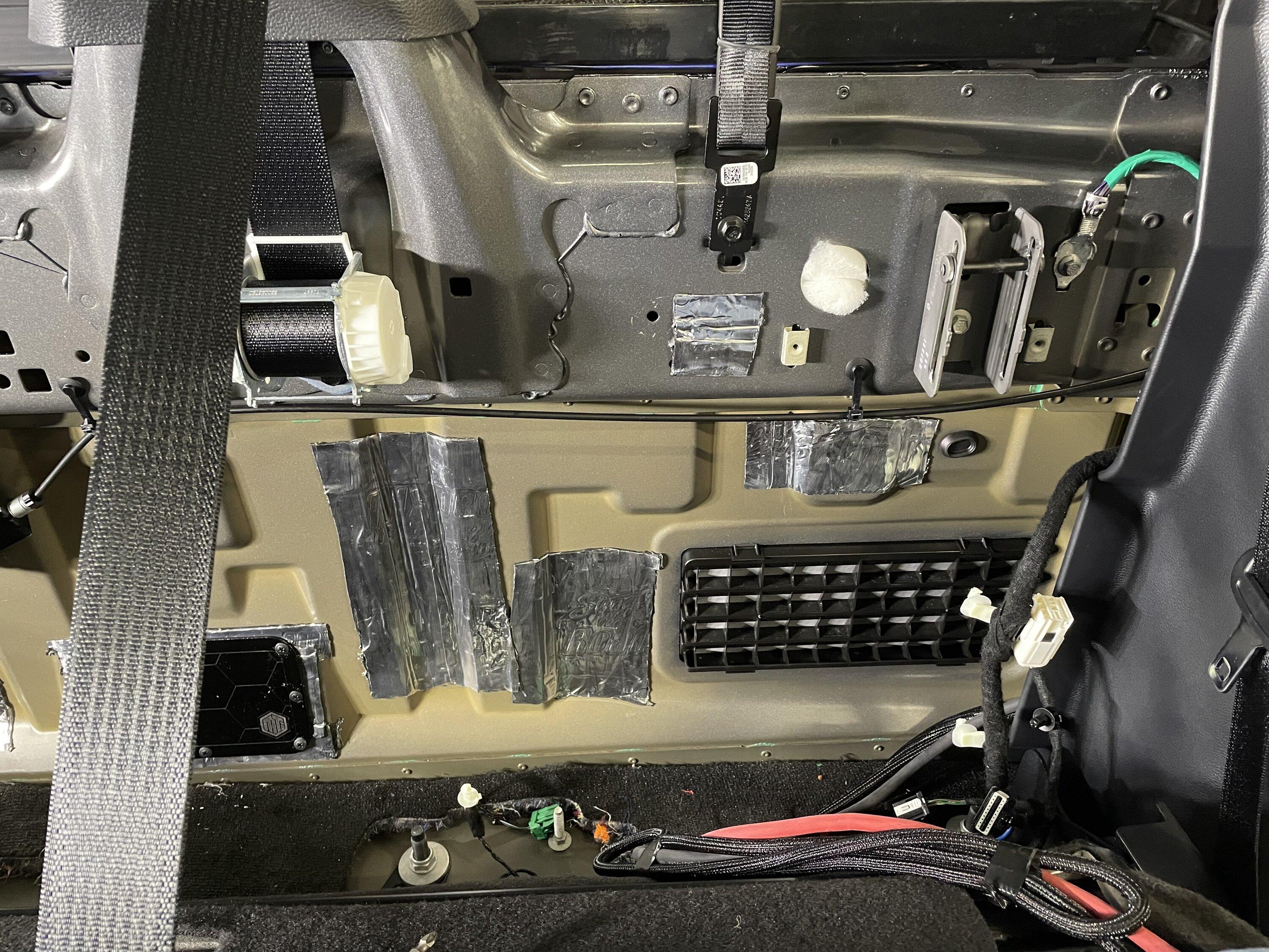

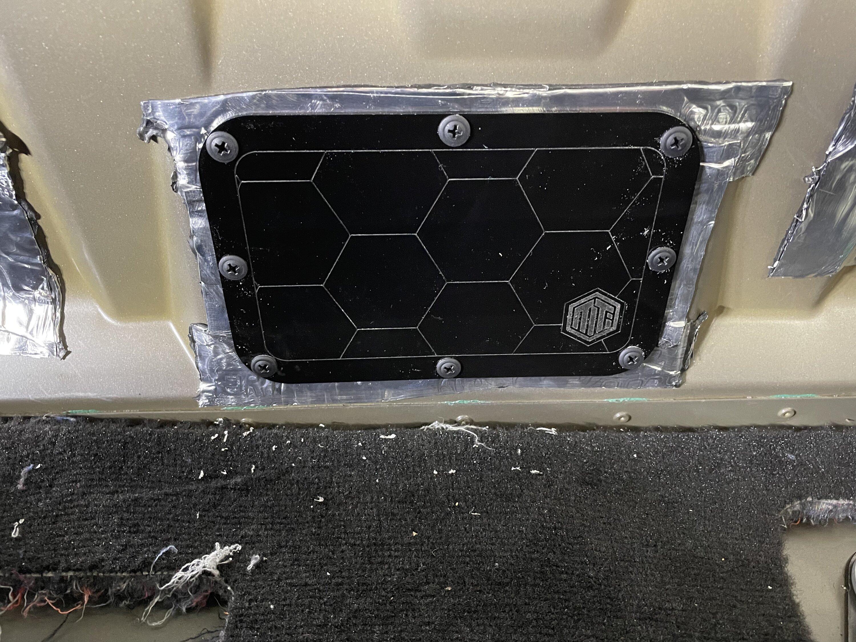

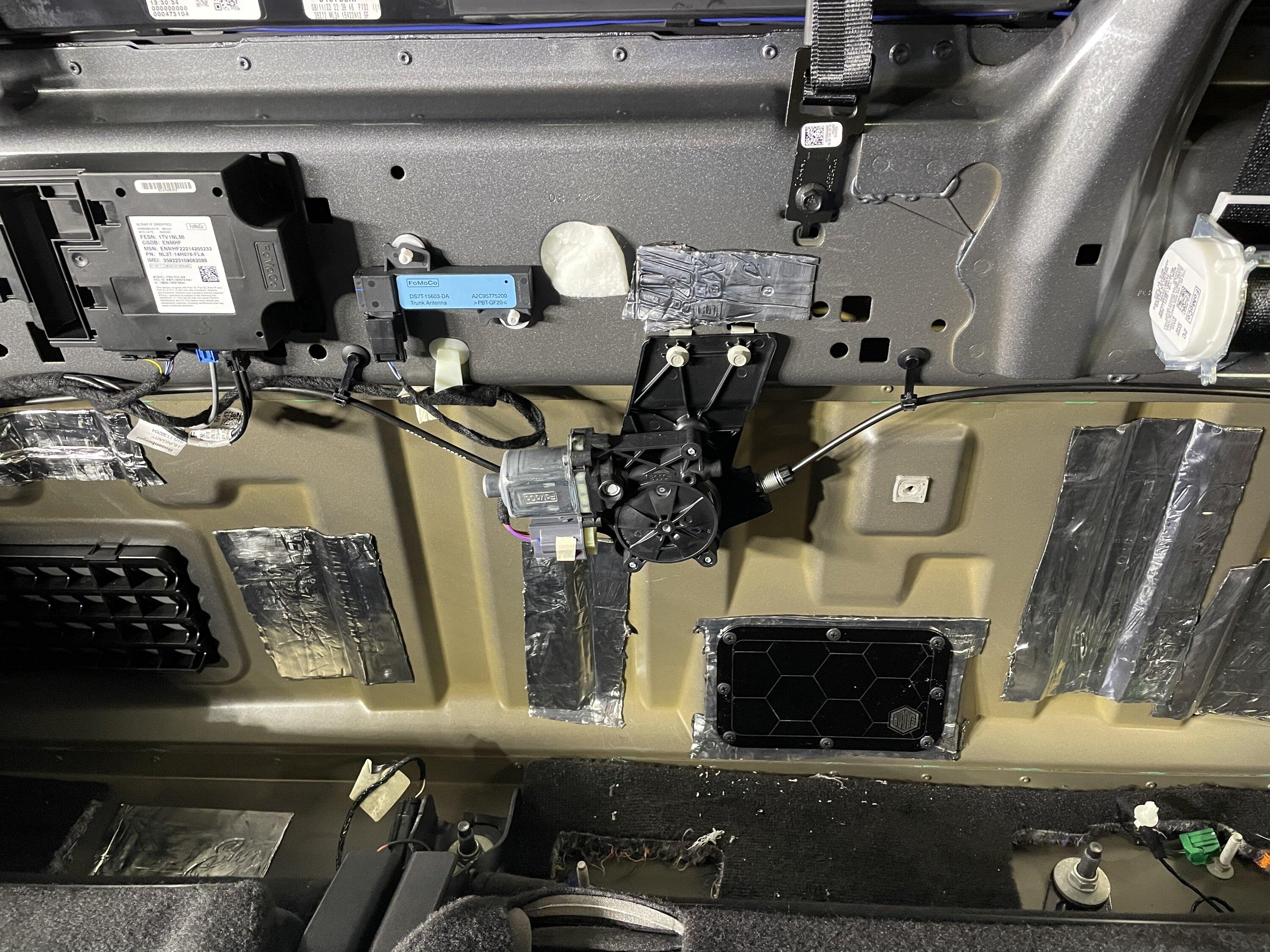

Started work on the back wall today. Removed factory sub/amp and Jack. Did small amount of sound treatment. Plugged the sub hole with a piece of hdpe. Also moved a module a bit up and out of the way of the sun box.
