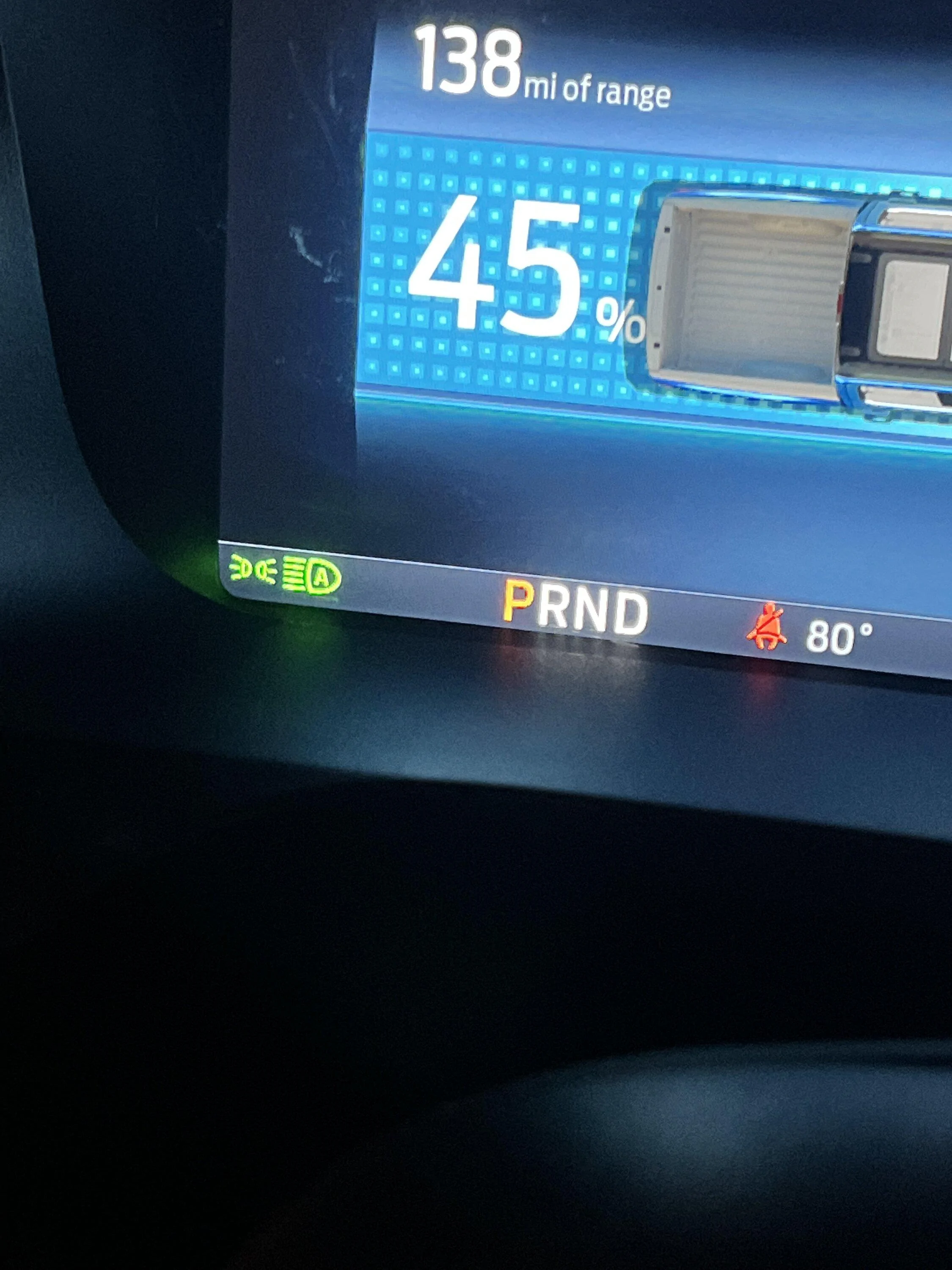

Oops, I left the IPC settings off of the sticky. I just added them now. @FlasherZ and @jredondox, try the updated settings and let me know if it works.
I don't see any changes in the sticky - I think you added IPC settings to the wrong section (the auto-window stuff). I looked at the ICE thread and added the settings, and now I have the headlight with "A" in it. I'll see how it acts later.

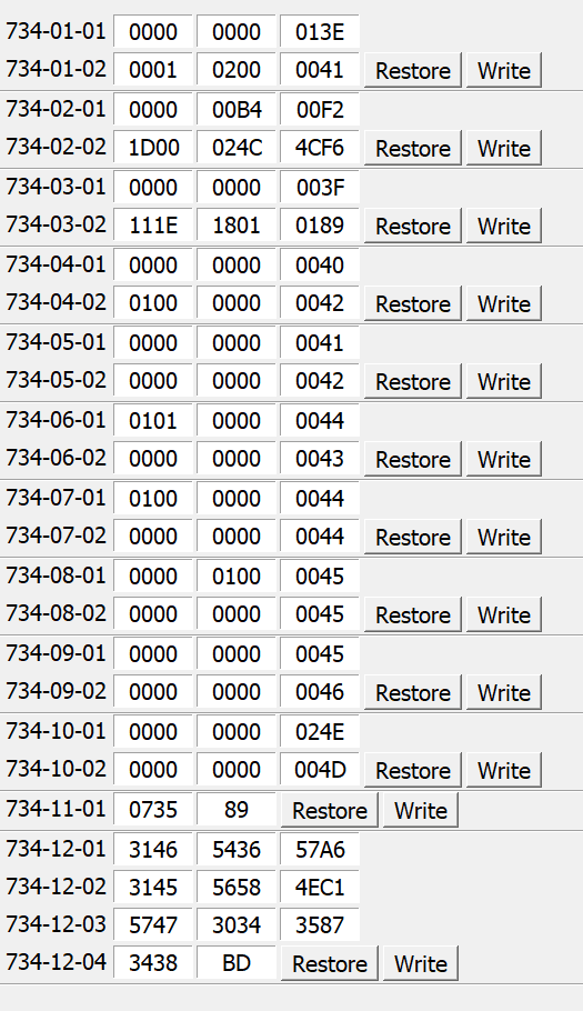

Thanks, I moved it to the right section. Weird, did you get a checksum error when you wrote the changes to the HCM module? I double checked my HCM settings and this is what I have:

On second thought, did you use the ICE settings for 734-01-02? That setting threw a checksum error but the setting I used in the sticky from this thread worked fine.

Ok - I restored HCM and followed the sticky instructions for HCM. I have differences compared to you (after mods):
Code:
             You-have          I-have
734-03-02    111E 1801 0189    111E 1801 0088
734-12-01    3146 5436 57A6    3146 5456 57C6
734-12-02    3145 5658 4EC1    3145 5638 4EA1
734-12-03    5747 3034 3587    5747 3038 378D
734-12-04    3438 BD           3535 BB
Lariat ER, tow tech, max tow.
If I use your full config, the checksum error isn't set, so it's obviously my "different" original numbers that trip it up.
The glare-free works regardless of whether your settings from above are used, or mine; just that MIL is set because of the cksum error if I use mine. It's a pretty nifty feature.

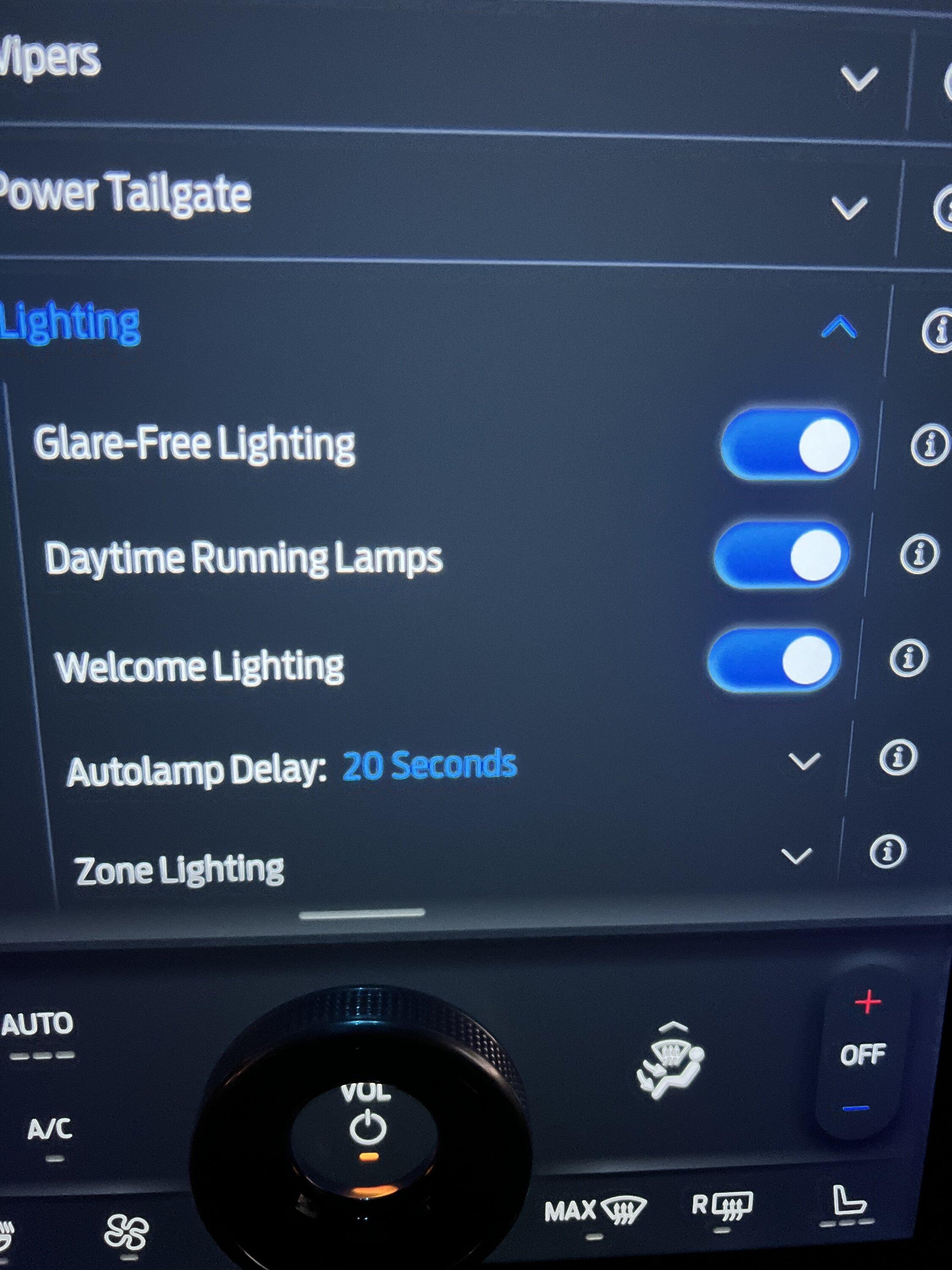

I got the checksum error and my mirror folding is wonky now. I have to reset and revisit the sticky. I’m sure, I know I shouldn’t be testing this after a long day at work.
