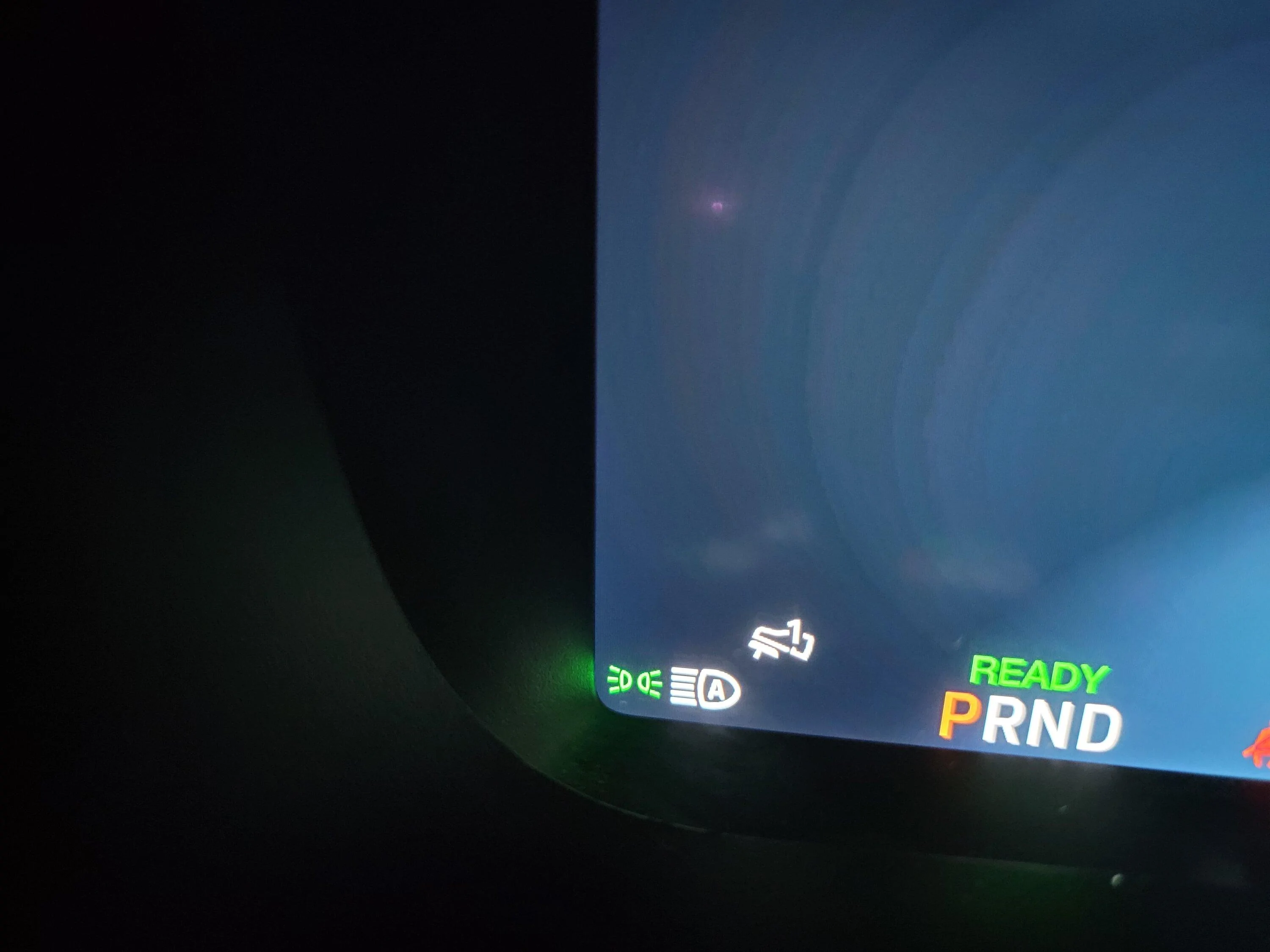

Interesting that you all see a green A. I only see a white one:
Ford F-150 Lightning F150 Lightning FORscan thread 20220825_074659
The beam-forming is working, I can see it when I'm driving at night. Perhaps I need to recheck my other modules again.
