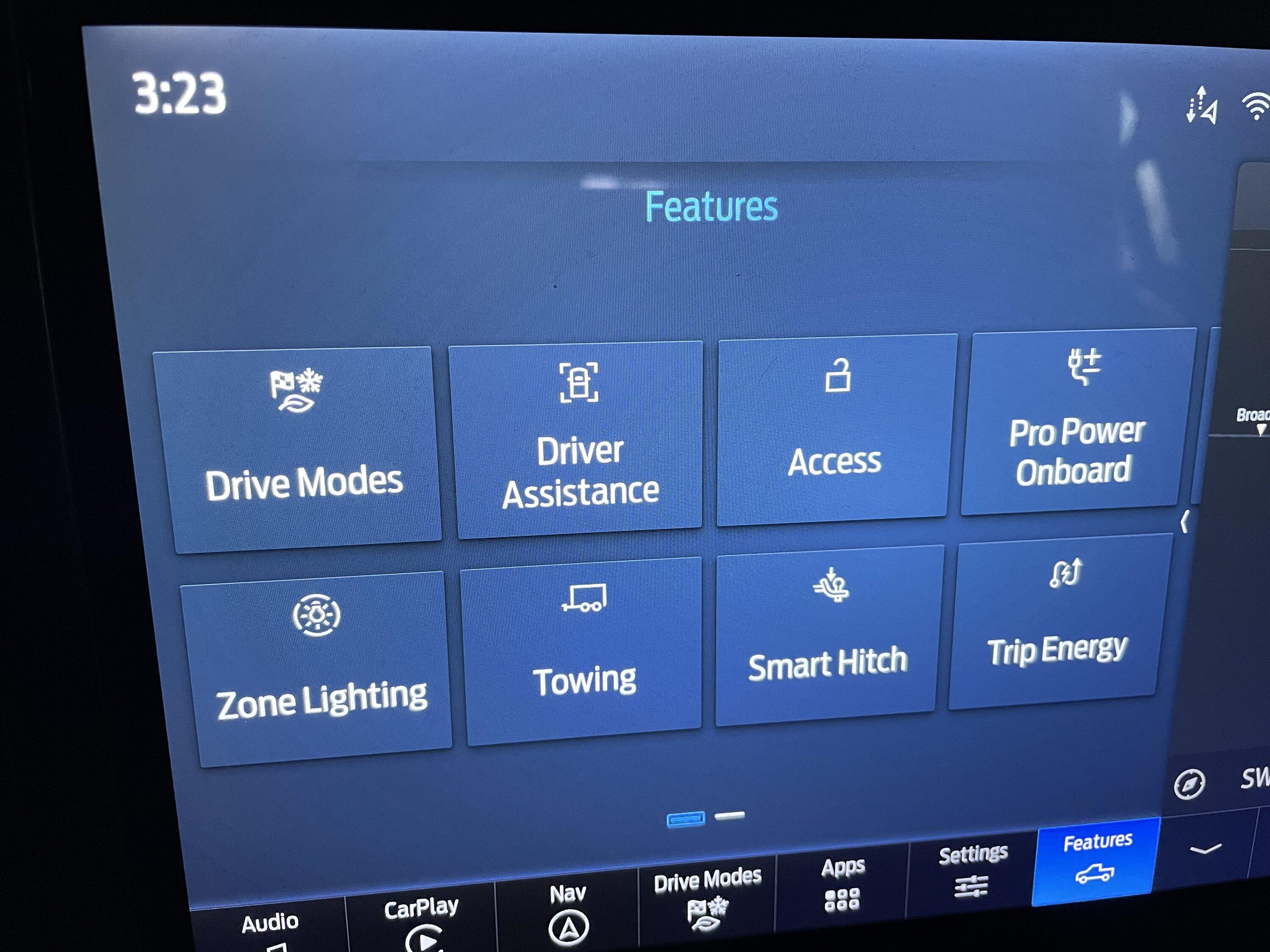

Just added in the Zone Lighting thanks to @LUXMAN and @GDN. I only needed half those values as some were already that way on my truck. It also appears to have added smart hitch which I didn’t have before. I wasn’t able to drive it right now, but will check it out later if I can.
Ford F-150 Lightning F150 Lightning FORscan thread IMG_7246
Also to note for others if you need to modify the GMW modules you will need an extended Forscan license. Of course mine expired in Dec.

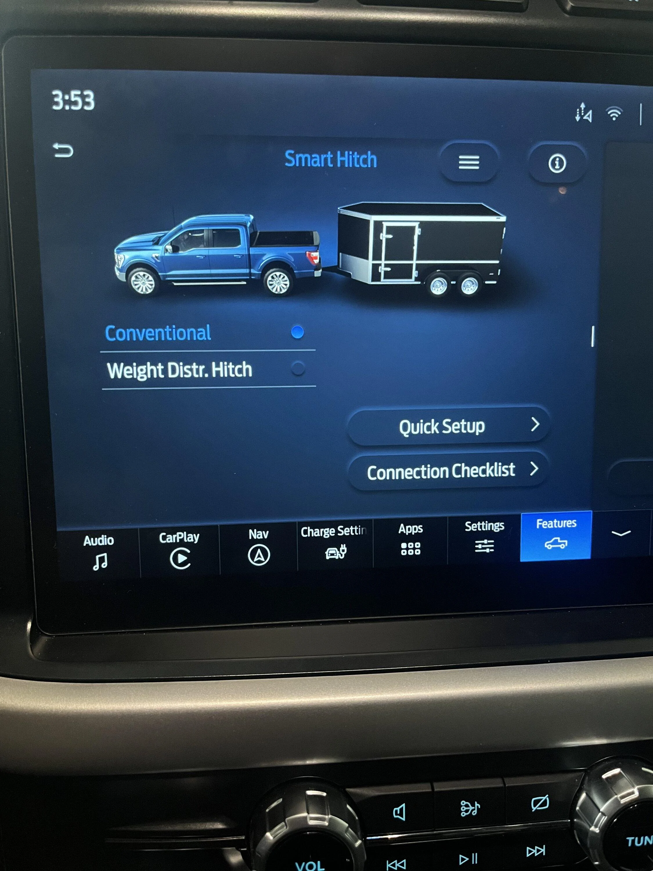

Good catch. I didn’t even know I had Smart hitch. But since you mentioned it, I went and looked at both my truck and my wife’s.
When activated, I see this
Ford F-150 Lightning F150 Lightning FORscan thread IMG_7453
both of our trucks have the tow technology package and the max tow package. So it must be included.
I don’t tow however so I never looked.
is yours a ‘23? Does this require on board scales? Ours do since they are 22s. Not sure what is needed for that.

Yea must be a part of one of the packages. I don’t have either of those packages nor on board scales. I have a base 22 XLT 311.
Very cool that it worked for you, hoping others can use it. I just happened to be the one with the cable, so I help out @LUXMAN. As far as the codes go, we verified most of them matched my Lariat with Zone lighting and most of @LUXMAN's were already the same too. @Livnitup had helped with them and had them all listed, so just in case someone else wants to activate, they should indeed check them all.
