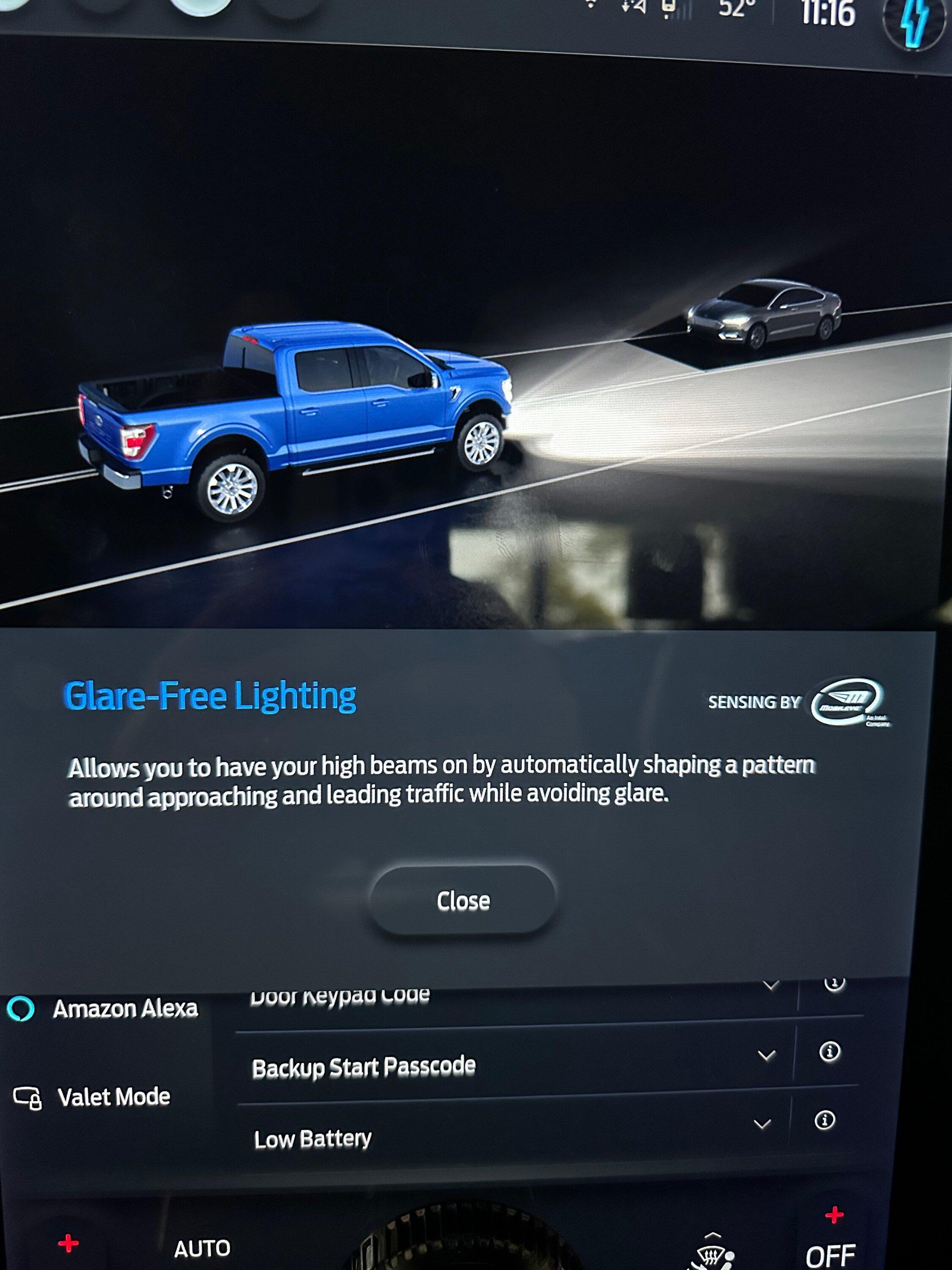

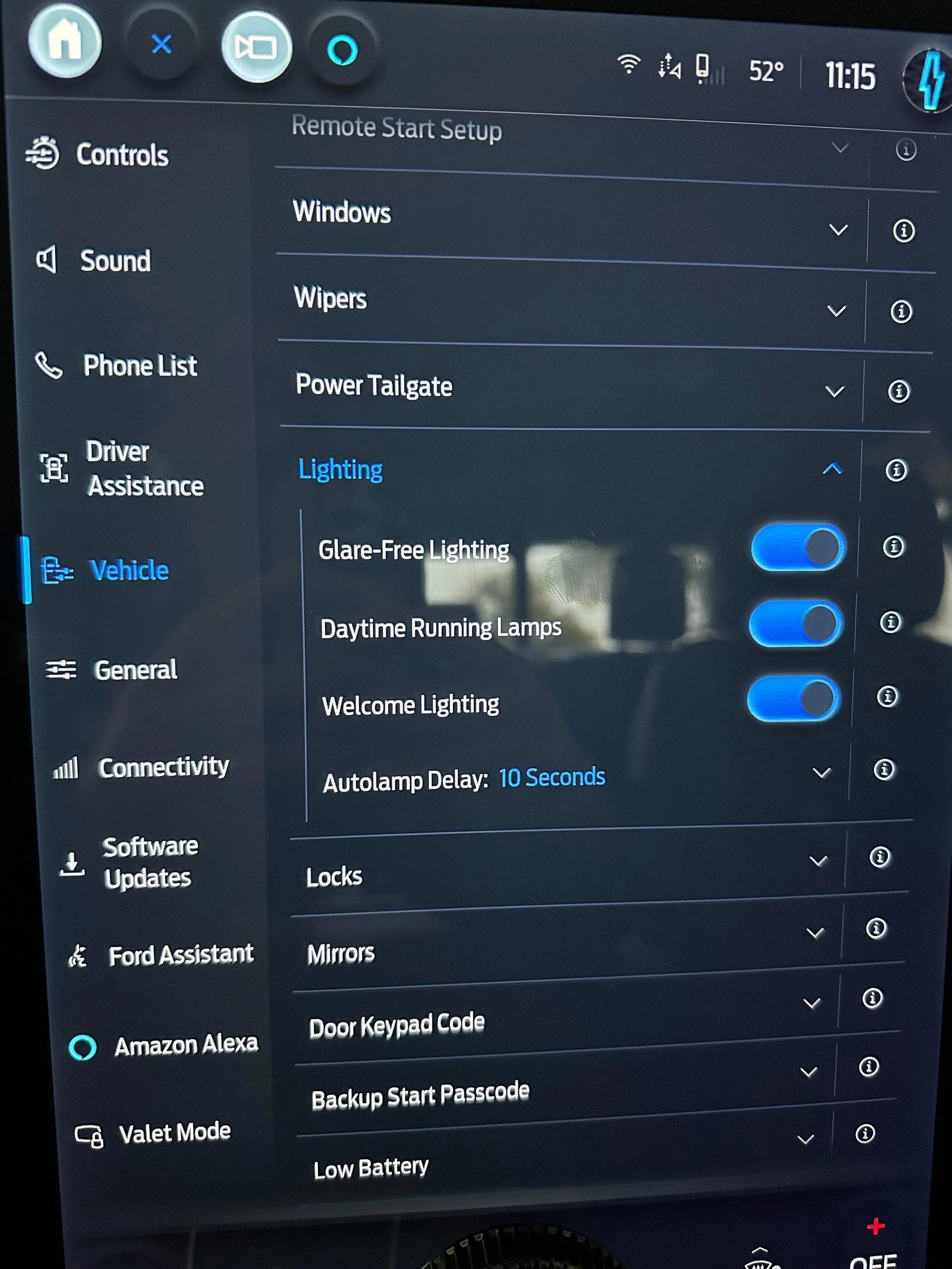

Will someone who has glare free headlights please post a photo of the options in the lighting section of settings on the center screen?
I'm trying to get glare free working using another method and running into road blocks. Self-inflicted road blocks but obstacles nonetheless.?
In case you haven't gotten what you were looking for already, here is the lighting options picture and the info screen for glare-free in my MY23 Lariat ER.
Thanks. I had figured it out but my first attempt gave me the option of what side of the road to drive on.

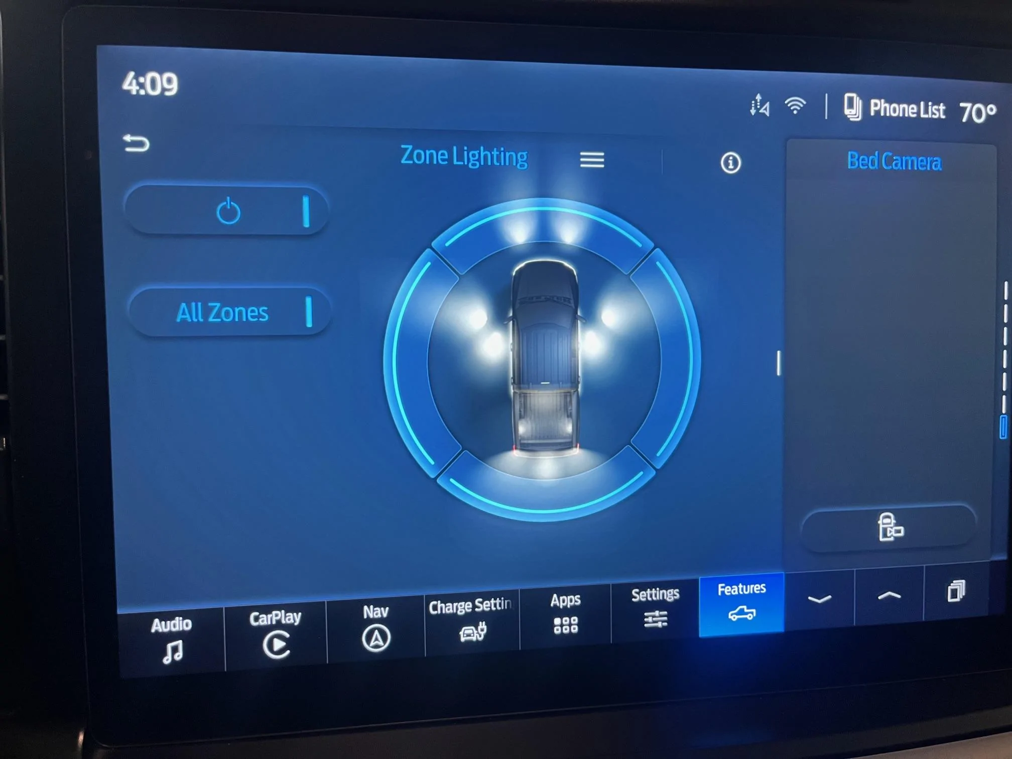

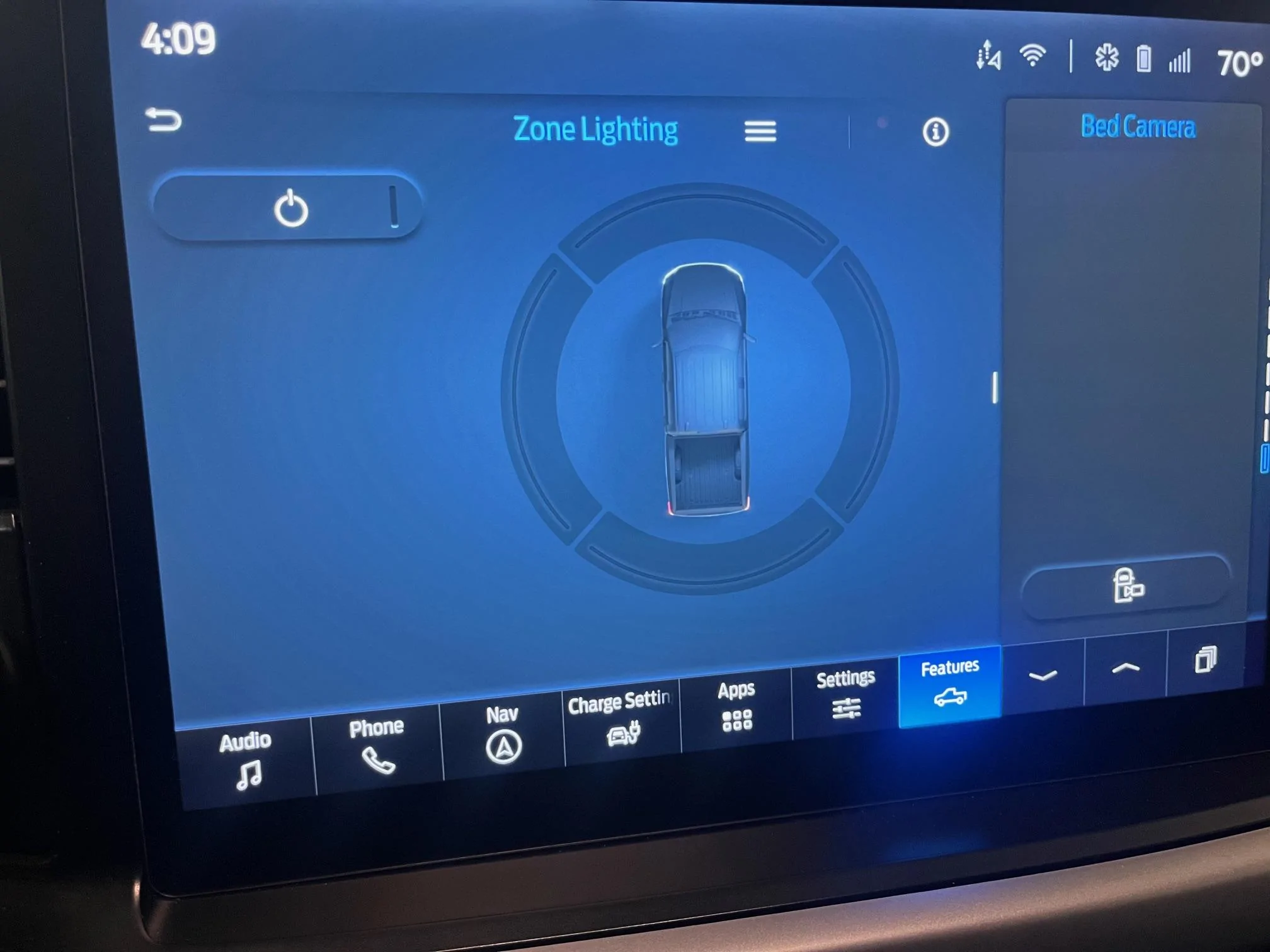

Got the ZONE LIGHTING Feature added to my PRO thanks to @Livnitup and the Install help of @GDN !
***Just to be clear, this is a LIGHTNING only Forscan change. Cant be used on the ICE truck if there are any lurkers ***
Here are the codes to make the change and we also reset the modules after we made the changes.
GWM
716-02-01 xBxx xxxx xx--
716-06-09 7C7D 7D7C 7C--
716-14-01 x1--
716-24-02 xx5x xxxx xx--
716-27-02 xx7x xxxx xx--
APIM
7D0-01-03 xxxD xxxx xx--
7D0-01-04 xxxx xxxx xA--
BCM
726-84-02 0101 xxxx xx--
We were hoping that APP would show the ZONE LIGHTING feature after this, but it has not shown up yet. Hopefully it will show up in a few days after the mothership sees it ?‍♂.

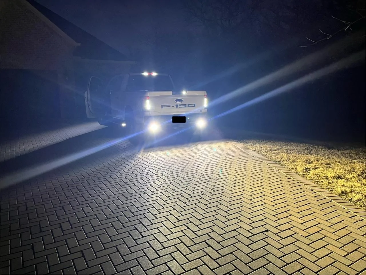

The great thing is the Zone Lighting also activates trailer lights, so I added some rear spots from @4x4TruckLEDs.com
Yes they are bright but I don't really drive at night. However they should come in handy this summer in the mountains of Colorado maybe.
