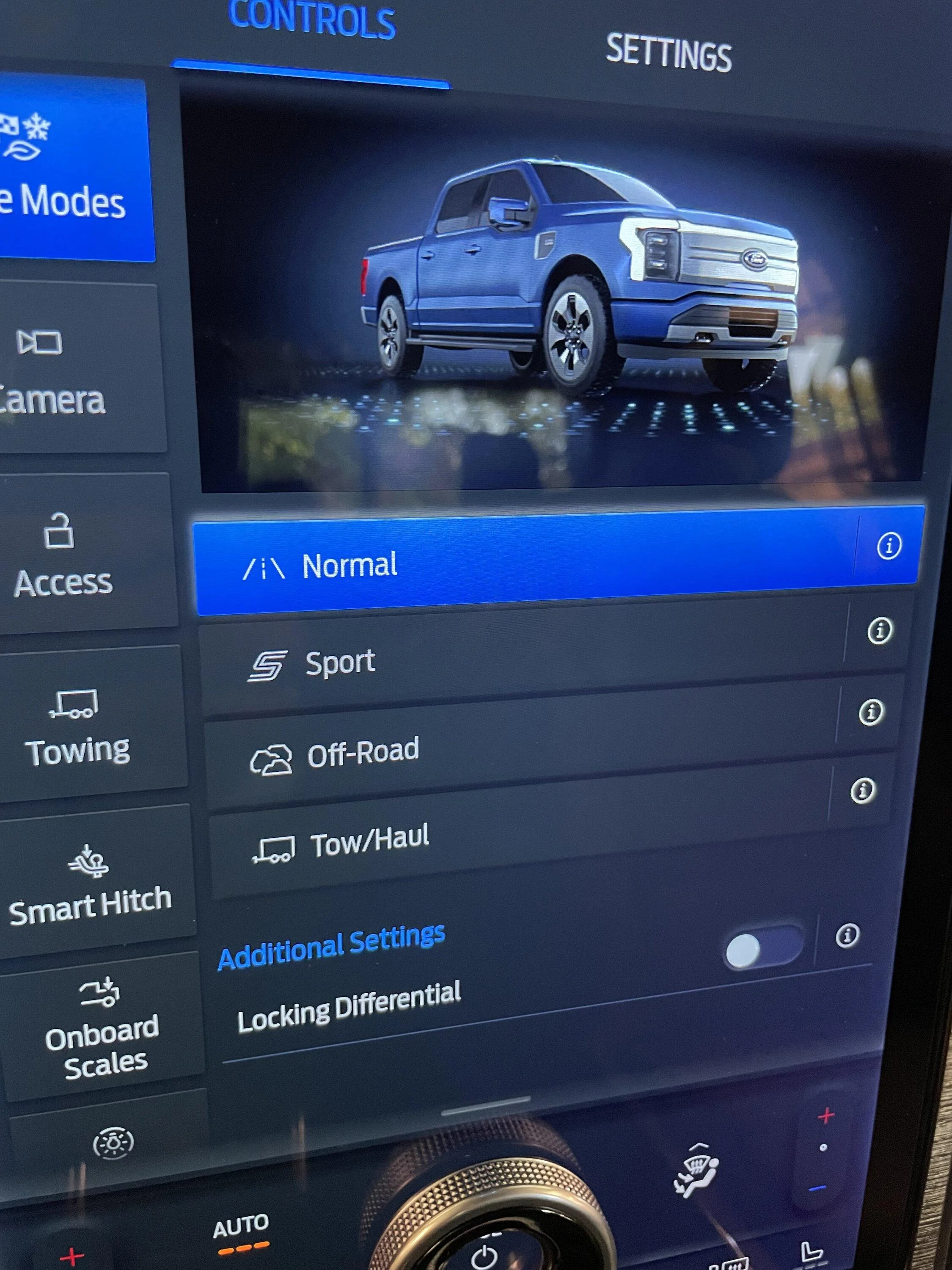

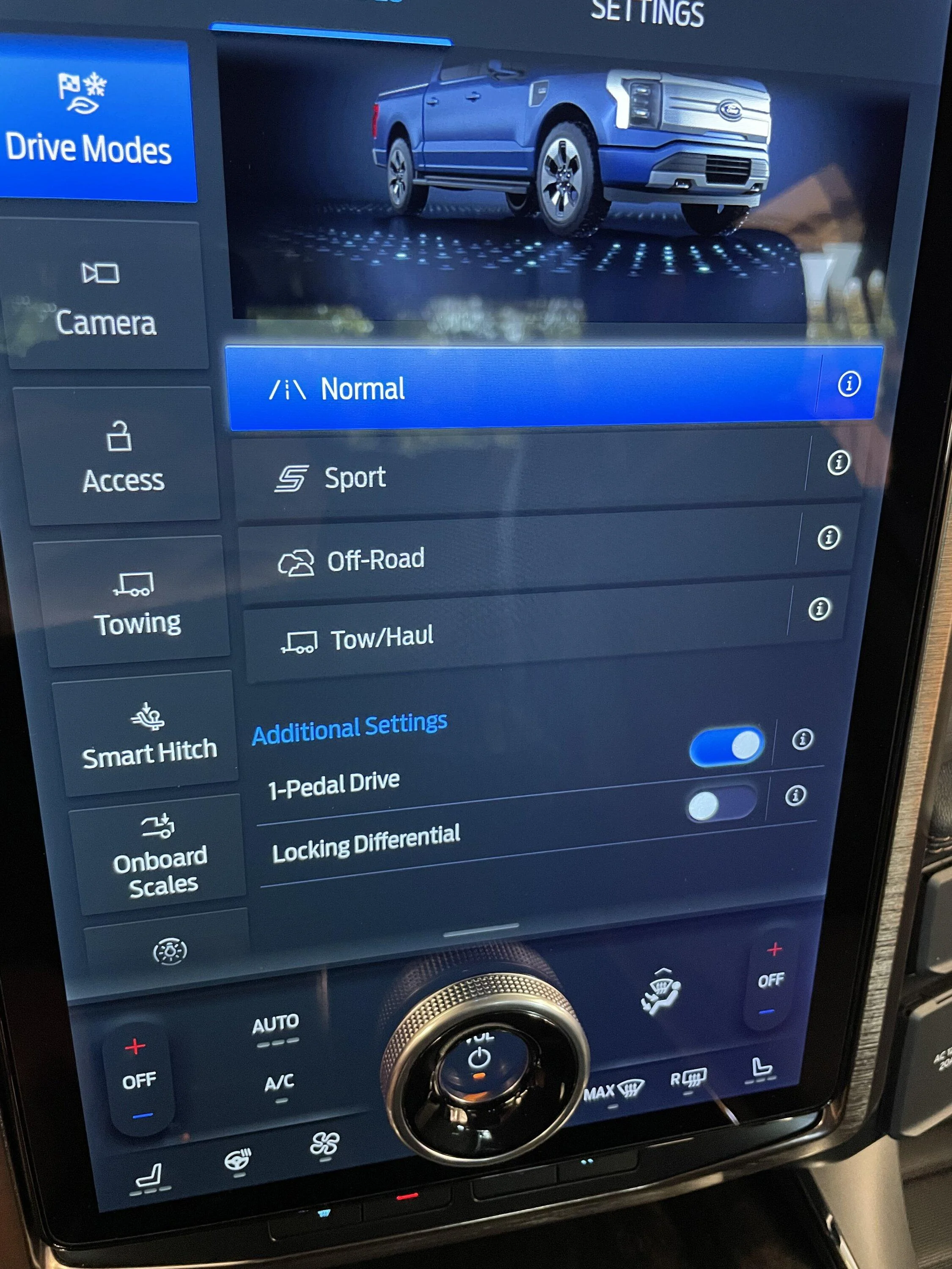

Forscan mind hive - I need some verification and help. I've made updates to change 3 items on my '22 ER Lariat. I'll provide them below all although only the Glare Free would be affected by what I've found.
First - for those of you that have done the GlareFree change - can you check under your "Drive Modes" and see if your One Pedal drive "switch/selector" has disappeared? Mine has and I know it is tied to my changes for Glare Free in either the APIM or IPMA module.
I backed up all of my original files before making my these changes. So today I restored my original APIM and IPMA files and the option comes back so I can select it. I don't honestly know which of the two, I will have to do it again and make sure I reboot between changes to know for sure. There are only 3 lines it could be however.
These are the only changes I made, but again I only restore APIM and IPMA and the option came back, so one of those 3 lines.
Ford F-150 Lightning F150 Lightning FORscan thread 1664505999304
Screen shot without and with 1PD selector:
Did you figure this out?
3,776
4,862
I have not. I took my 3 sets of updates out and the One Pedal Option came back on the screen. I put them back in and it disappears.
I've not had any other feedback from others to know if it happened to them or if it can be tied to any one specific line or group of changes.
