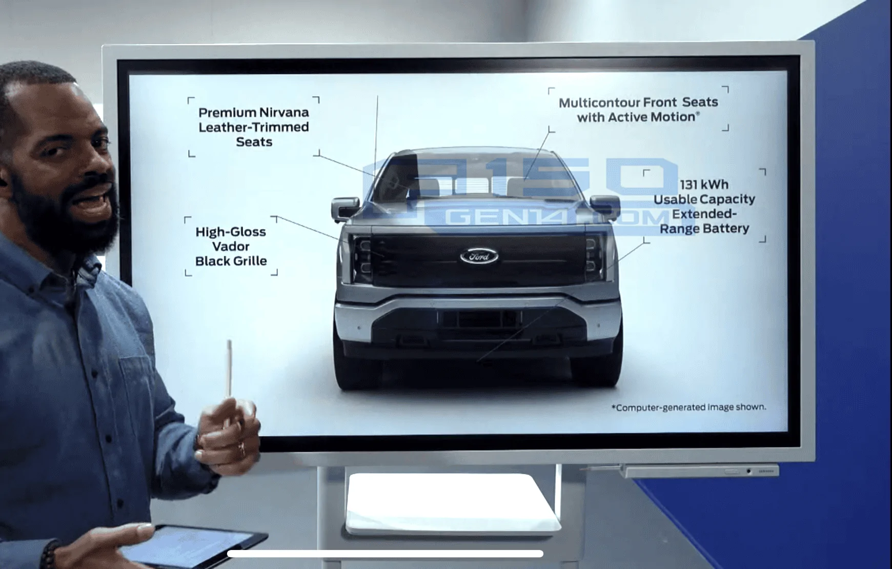

One thing technical thing that just stuck out.....131 KWh useable capacity extended battery.
And 300 miles per charge? That rivals smaller, more aerodynamic EVs. I hope they can squeeze 300 miles from that capacity but it seems like a stretch...

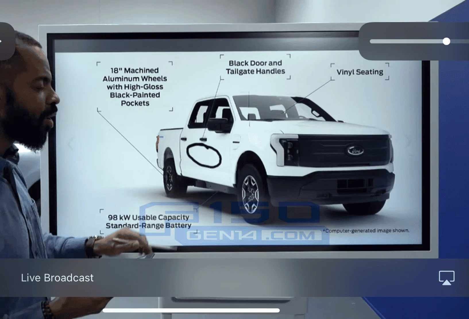

Even Ford marketing struggles with kW vs kWh. 10-15% less useable capacity than what was expected. Means these are more efficient than expected. 2.3 miles a kWh. Not bad at all. Hopefully they are software locking some of the gross capacity and can open it up over time like with the Mach E.
300/131 = 2.29... with 1000lbs of payload. Doesn't seem bad if that is truly how efficient the truck is. What's the Mach-E? 270/98 = 2.76? Doesn't seem too bad at all.
That works out to be 2.3mi/KWh. Rivian is 135KWh with 314...so that works out to be 2.33 mi/KWh.
Edit: Corrected calculations to be mi/KWh energy useage

That works out to be 2.3KWh/mile. Rivian is 135KWh with 314...so that works out to be 2.33 KWh/mile
I'm having a hard time believing this :)
Either rivian failed at aerodynamics (kind of doubt) or ford found magical aero paint.
Alternately... EPA rating may end up a bit shorter than anticipated.
