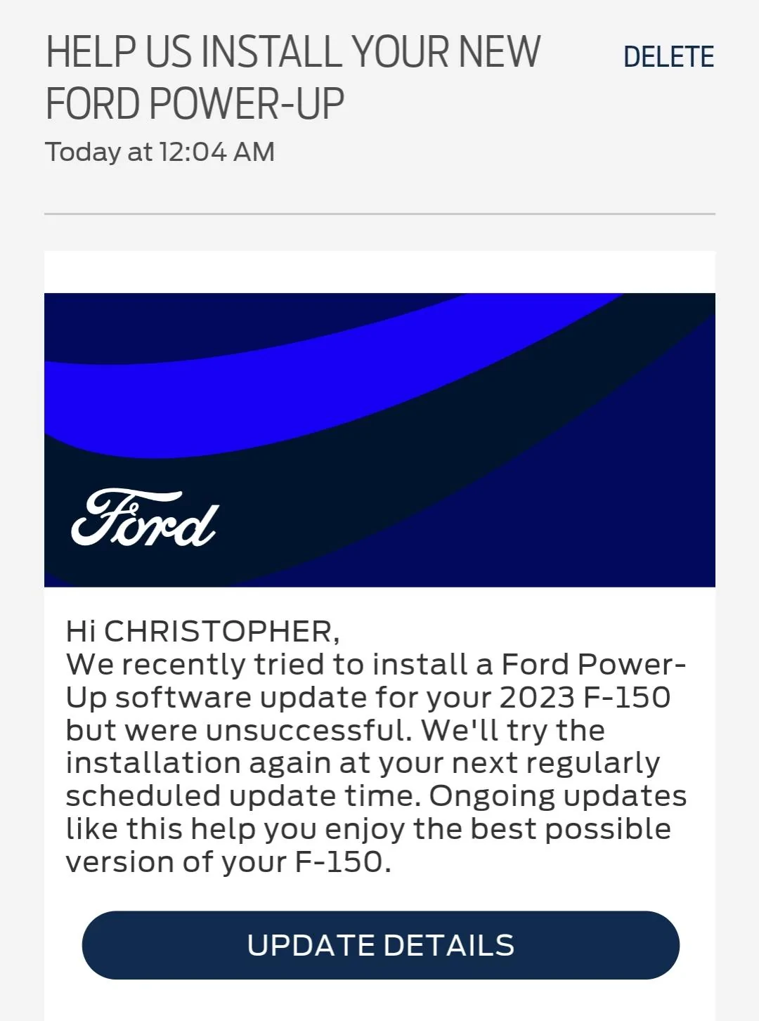

My truck has been unsuccessfully trying to push PU0306-BCF-DET since 6/21. Glad I'm not the only one. Shouldn't have to screw with the 12V to get basic OTA functionality to work. @Ford Motor Company are you listening?
