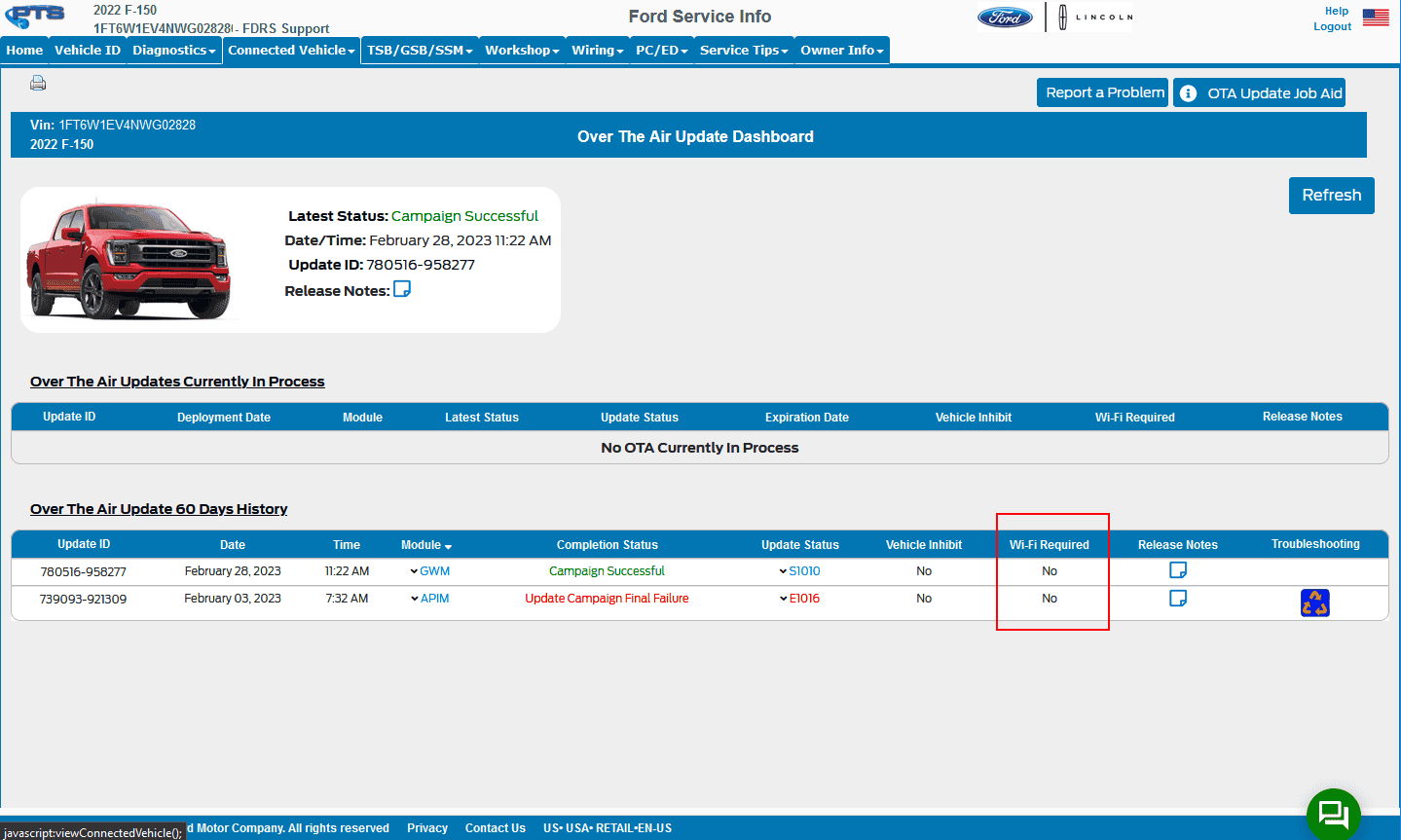

Go see your service advisor and ask to see the OTA Dashboard for your vehicle.
It's gonna look like this:
See the part that notes whether Wi-Fi is required?
I don't care who's VIN you look up none of them will say that Wi-Fi was required. And there's no conclusive proof that any OTA has ever downloaded using Wi-Fi. Does your truck connect to Wi-Fi to do something. Yes. Is it to download OTAs? There is no evidence that this has ever happened on a Lightning or Mach-E.
The 'campaign failure' in this pic was because I used FDRS to do the APIM update after the OTA had already started to download.

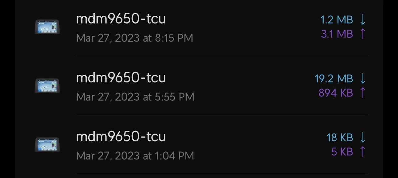

Wifi isn't required, I agree. However if it faster and it works.. .then why not? Its connectivity, and what I see on my side may not show the whole picture, but to download MB of data or even GB shows its doing something. I have months of data being collected and more often than not when I get a large payload I get a notification saying it was updated or installed in the next few cycles. In this case, I saw the large payload and I drove around that night and it was updated with a new PU.
As you saw in the graph, I rarely see more than 1 MB download. If anything, its more upload usually.
Here is a new graph covering from 1/1/23:
