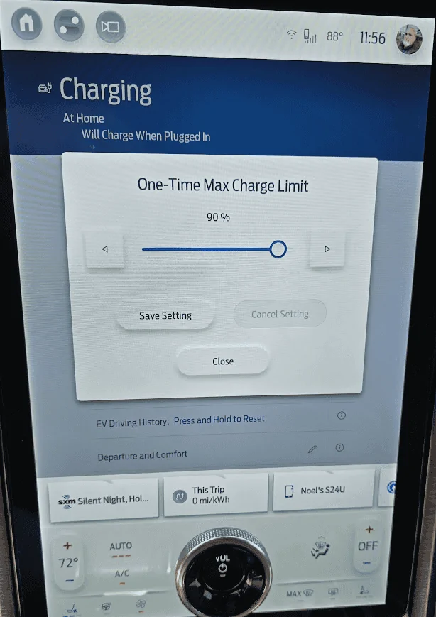

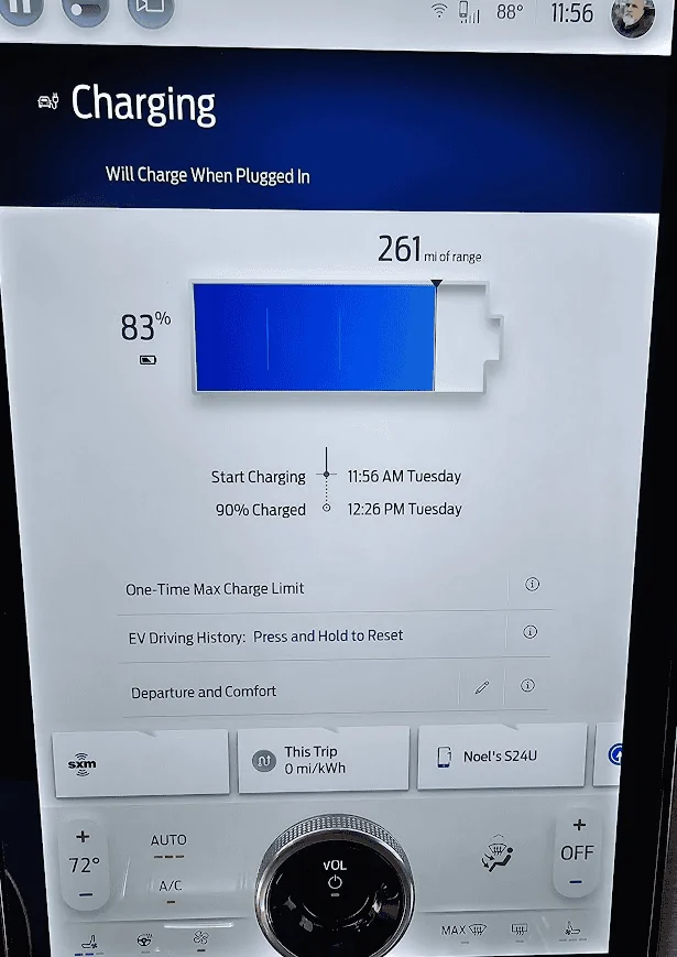

During an active charging session, you should be able to adjust it IIRC (not in the truck or at a charging station) there should be adjustment icons {arrows L/R to move the stop point}
Updated with snap shots:
Tap the One Time Max Charge Limit ---------------------------See the Arrows & Slider?
Ford F-150 Lightning Fast charging question 1723564887229-vm
Ford F-150 Lightning Fast charging question 1723564914376-41
Adjust to a prefered value --------------------save change
Ford F-150 Lightning Fast charging question 1723564969807-cz
Ford F-150 Lightning Fast charging question 1723564997001-8
Tweaked further to show projected time to prefered setting at 89%
Ford F-150 Lightning Fast charging question 1723565066912-s7
After the subsequent charging session has reached goal point it should revert to 90%

15" center screen see amended post 2
213
15,707
17,604
15" screen
Home button
Apps tab Screen
Charging
Tap One Time...... function
Adjust
Save
Charge

The easiest way (for me) is to set the one-time charge limit in the truck using the Charging app. It can also be done with the Fordpass phone app.
Setting the one-time limit applies to the next or current charging session. Once that session is done it reverts back.
The truck defaults to 90% for DCFC, the only way to override this is setting one-time limits. For Level 2 charging, it defaults to 100%, but you can set a location and and lower limit for that location. The one-time limit can be used to override that. For example at home I set the limit to 80%. When I'm going on a trip, I manually set the one-time limit to 100%.
