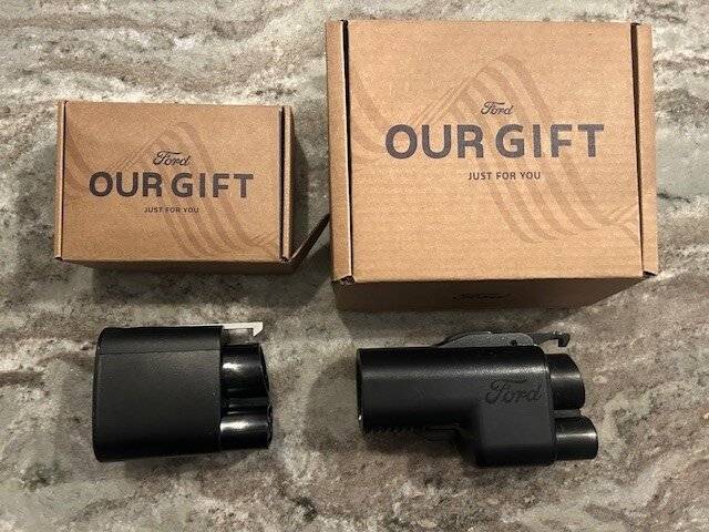

I'm confused on which adapter @TheBigBezo is referencing. He said it was a recall replacement but first gen. The recall replacements have been both the Tesla-made and Lectron-made. First-gen was Tesla.
@TheBigBezo - which style is giving you issues: Left (Tesla) or right (Lectron):

Interesting, I definitely have a Tesla one then. It’s the big clunker on the left. I tried multiple times on this trip and each time the A2Z performed better than my ford one. I can’t imagine why.
