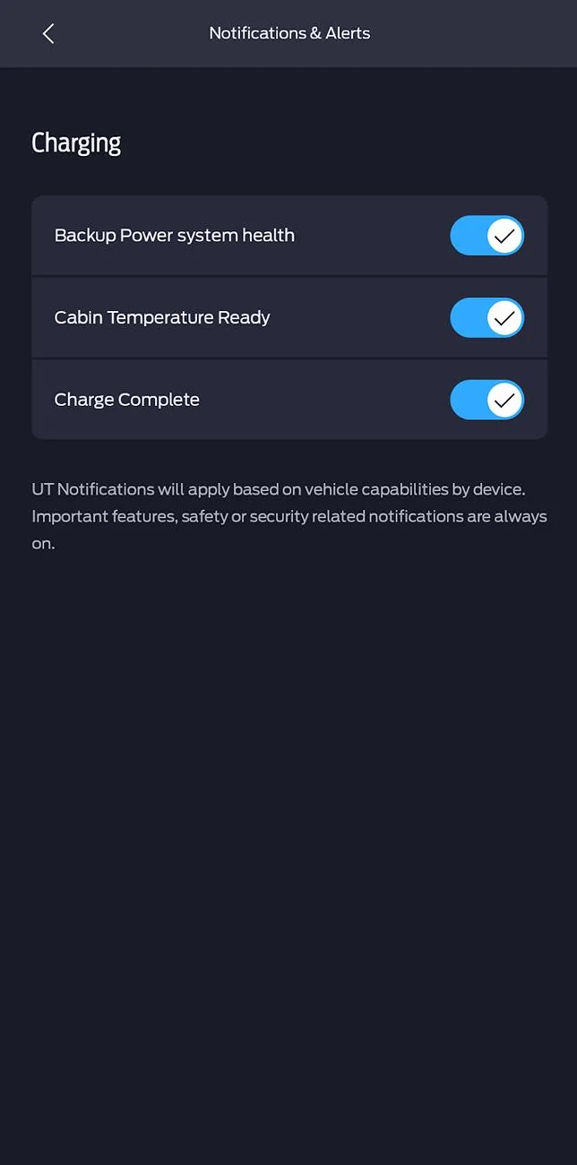

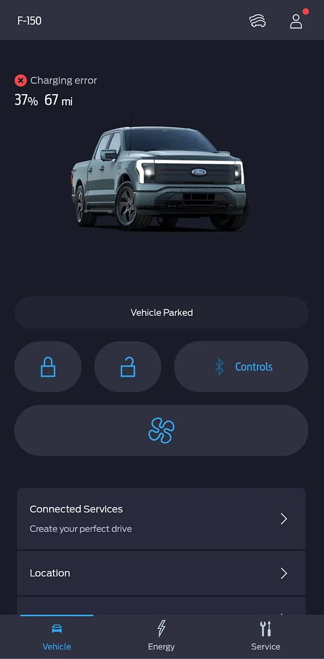

A fun thing happened last night. I'm not at home, but the house has a 50 Amp welder outlet in the garage, so I plugged in the mobile charger and went to bed. I woke up to nearly no increase in charge. Once open, the app does show a charger error, but with no further details. Unplugging and replugging allowed the system to resume charging. But that doesn't make the vehicle usable anytime soon or fix the fact that this would have been great information to have when it happened. Beyond that, I don't even know how to debug this sort of thing.
I'm only partially venting. I'm also asking 2 questions:
1. How does one debug issues with the mobile charge cable that was included with my lightning? I've never had an issue with my home's dedicated charger.
2. How do we request that the app be updated prioritize letting us know about issues like this when it happens? I can't be the only one who has been in situation.

Thanks for taking the time to respond with the suggestion, but it's not the notification sound. There just is no notification, and no option to add one for such an event in the app.

The error kicked in about an hour after it began charging. 240, 50A breaker, I've charged in this location several times before and have never had an issue before. Of course today, getting stranded very far away from any public charging options I'm frustrated.
Now I know to check the app every 20 minutes and make sure it is still making progress. And if cold temps is the issue, maybe the mobile charger needs to start wearing a little jacket. :)

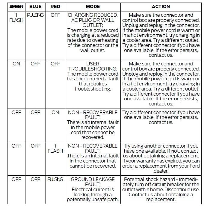

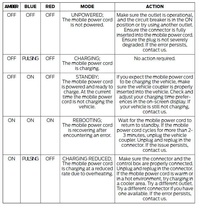

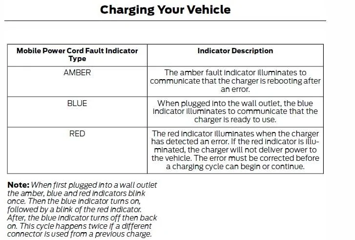

" 1. How does one debug issues with the mobile charge cable that was included with my lightning? I've never had an issue with my home's dedicated charger. "
The Mobile Power Cord charge seems to be notorious for errors and failures from posts on the forums anyway.
Any failure should be treated as a warning that something is wrong.
There is an error code table for it (attached in three images) if that helps.
One thing to think about is the dongle that adapts it for 240v or 120v - be sure it is seated well in the body of the MPC.
Some (most) severe failures have included "melt downs" literal melting/overheating of the components and case. I wonder if the Lightning is asking for too much current and the MPC is trying to provide it, i.e., 32A vs 30A. Exceeding the current capacity of a device is the most common cause of excess heat failure.
The FMPC should be on a 40A breaker which won't pop unless 40A is exceeded for a period of time. Your 50A outlet - is it on a higher amperage breaker? That could/would be a problem if the FMPC decides to draw more current than it's internal components can handle!
If anyone diagnoses the reason for so many failures of the FMPC with Lightnings, I would like to know.
Maybe the components used inside it are not really suited for everyday use?

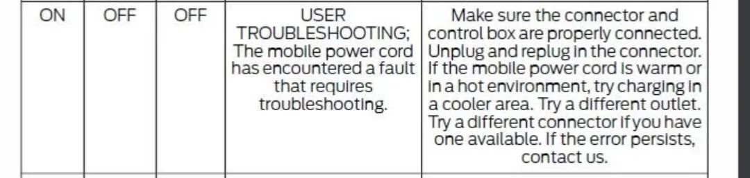

The only error code I ever get is this one, solid amber, no other lights.
Ford F-150 Lightning Fordpass app missing notification option for "charger error" Screenshot_20250106-070211
Unplugging and replugging works fine, but it'll happen again some other time. I doubt it's overheating, the garage temperature is near freezing most nights.
The truck never has issues with the 48A emporia or 32A chargepoint j1772s I use in other locations.
I guess the next step is to hand over my charger to a dealership and ask them to evaluate. @Ford Motor Company , do you have better input here?
