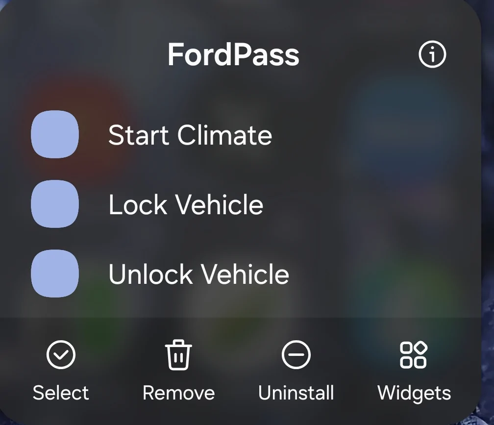

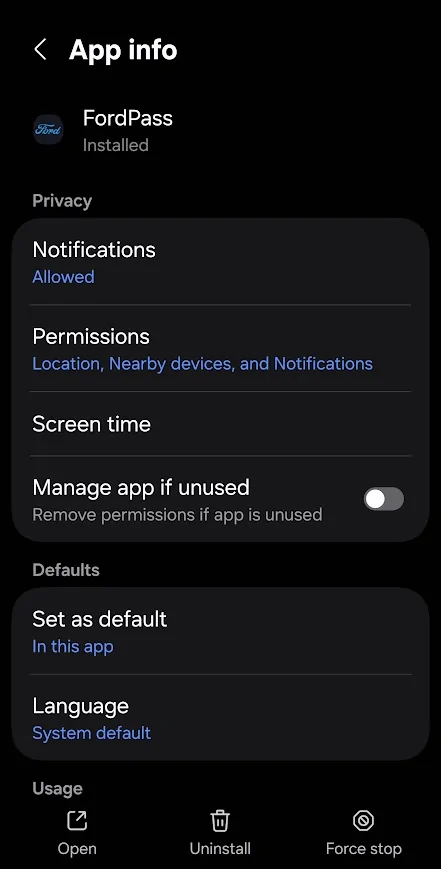

I know nothing about how the iOs works, but from the Android perspective if this is a problem for them here are the steps to confirm the app's basic notifications settings are correct.
If this solution path isn't possible in some fashion on iOs, then full uninstall & reinstall might remedy and mis-configurations that have crept in to your particular setup.
Android
Hold the Ford Pass app icon for extended period to cause this view, select the i.
Ford F-150 Lightning FordPass APP notification - Walk Away Lock 1760708961148-f

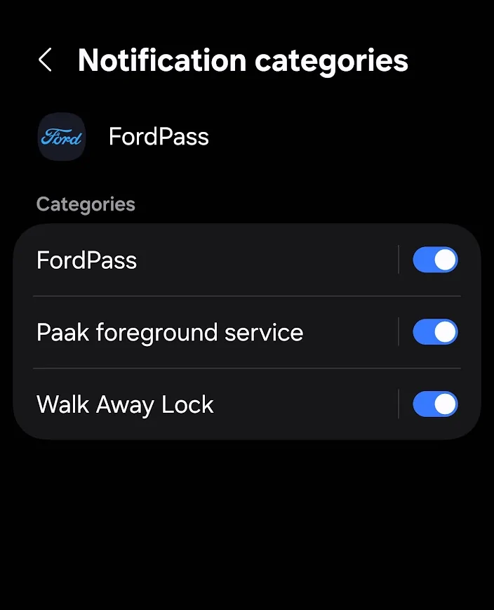

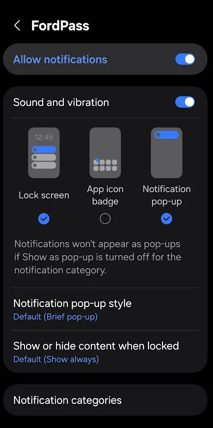

-------------Select Notifications---------------------Select Notification Categories

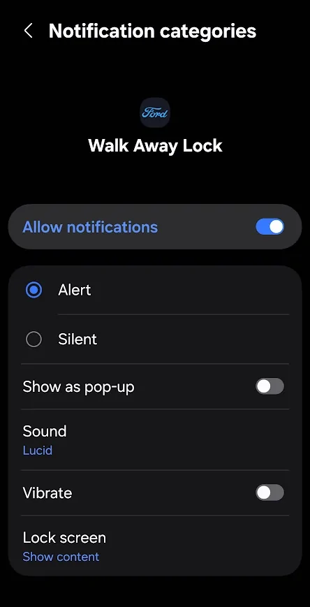

Ford F-150 Lightning FordPass APP notification - Walk Away Lock 1760709010008-m9
Ford F-150 Lightning FordPass APP notification - Walk Away Lock 1760709032246-73
Review and adjust these settings, I have a customized the sound when WAL activates

My notification section didn't have wal or paak. Makes me wonder if not having paak is the reason I don't have wal.
Yes, that would be the reason your configuration is missing those switches

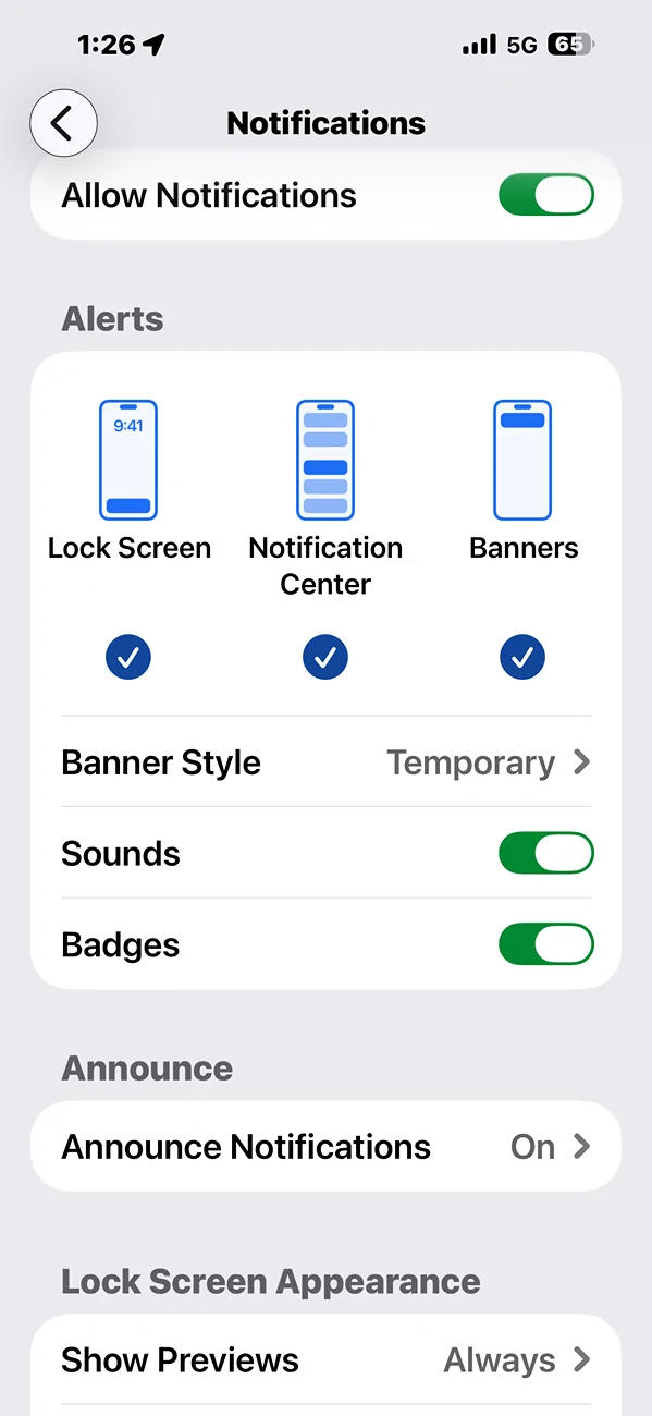

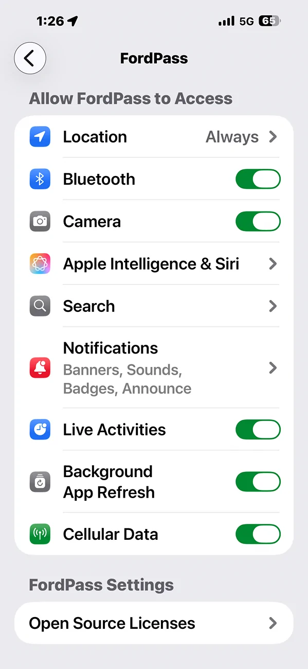

OP here.
I was able to enable WAL Notification by turning off and then turning Allow Notification back on.
