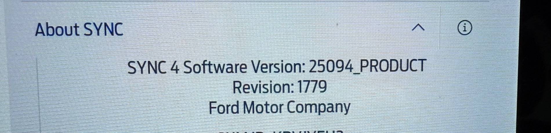

Got this APIM update done at the dealer when I took her in for recall work. I’m now at Sync version 25094. I don’t have the BC 1.4 toggles though. I’m not subscribed currently, so maybe those options aren’t present if the subscription isn’t active?
Ford F-150 Lightning SYNC-25.2.1.6.5: Walk Away Lock Clean-up IMG_6364
2,920
4,169
Your 2024 should have come with BC 1.2 and those toggles from the factory. So it's interesting they remove the toggles now when your subscription lapses. Guess it makes sense.
