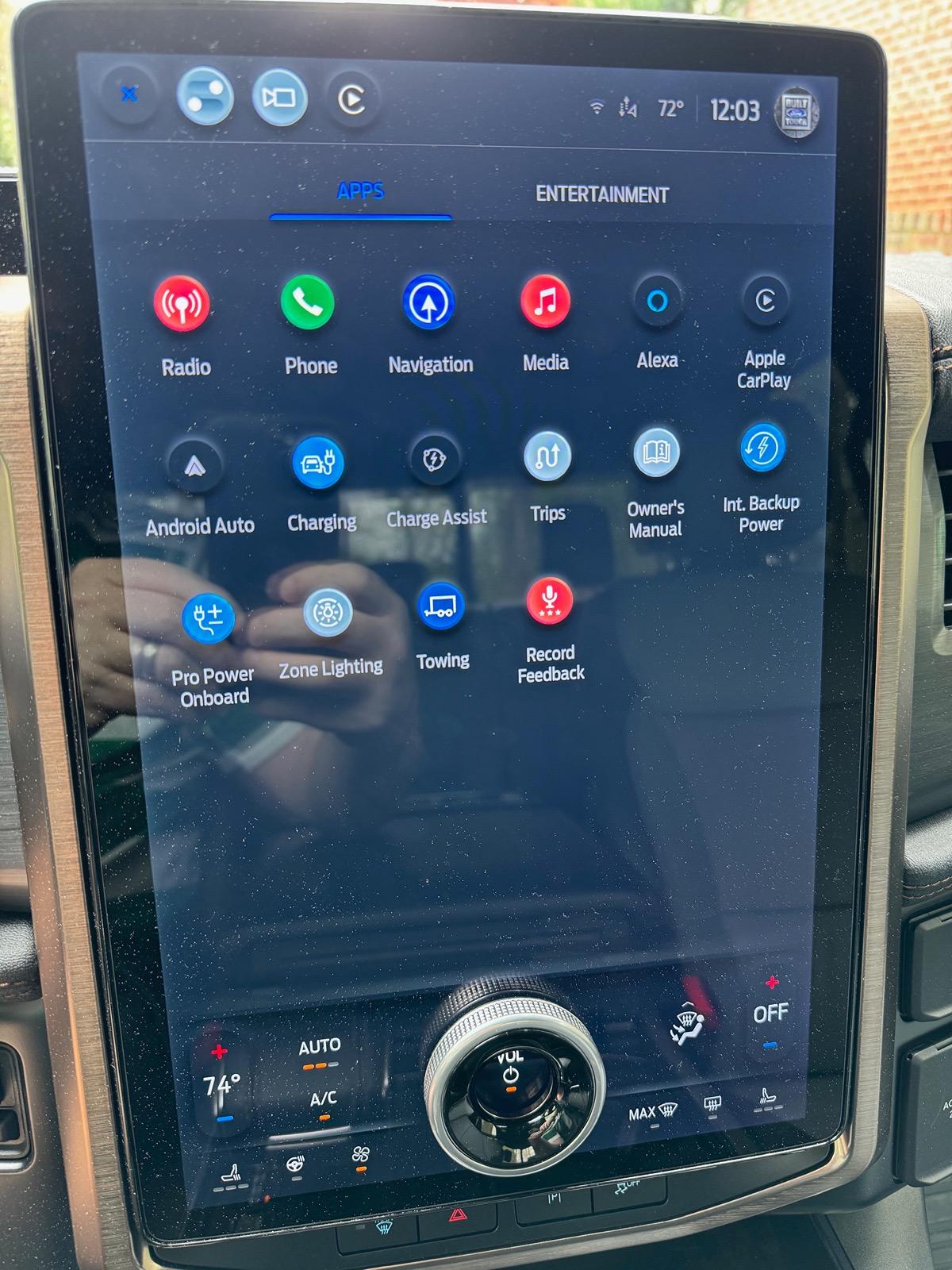

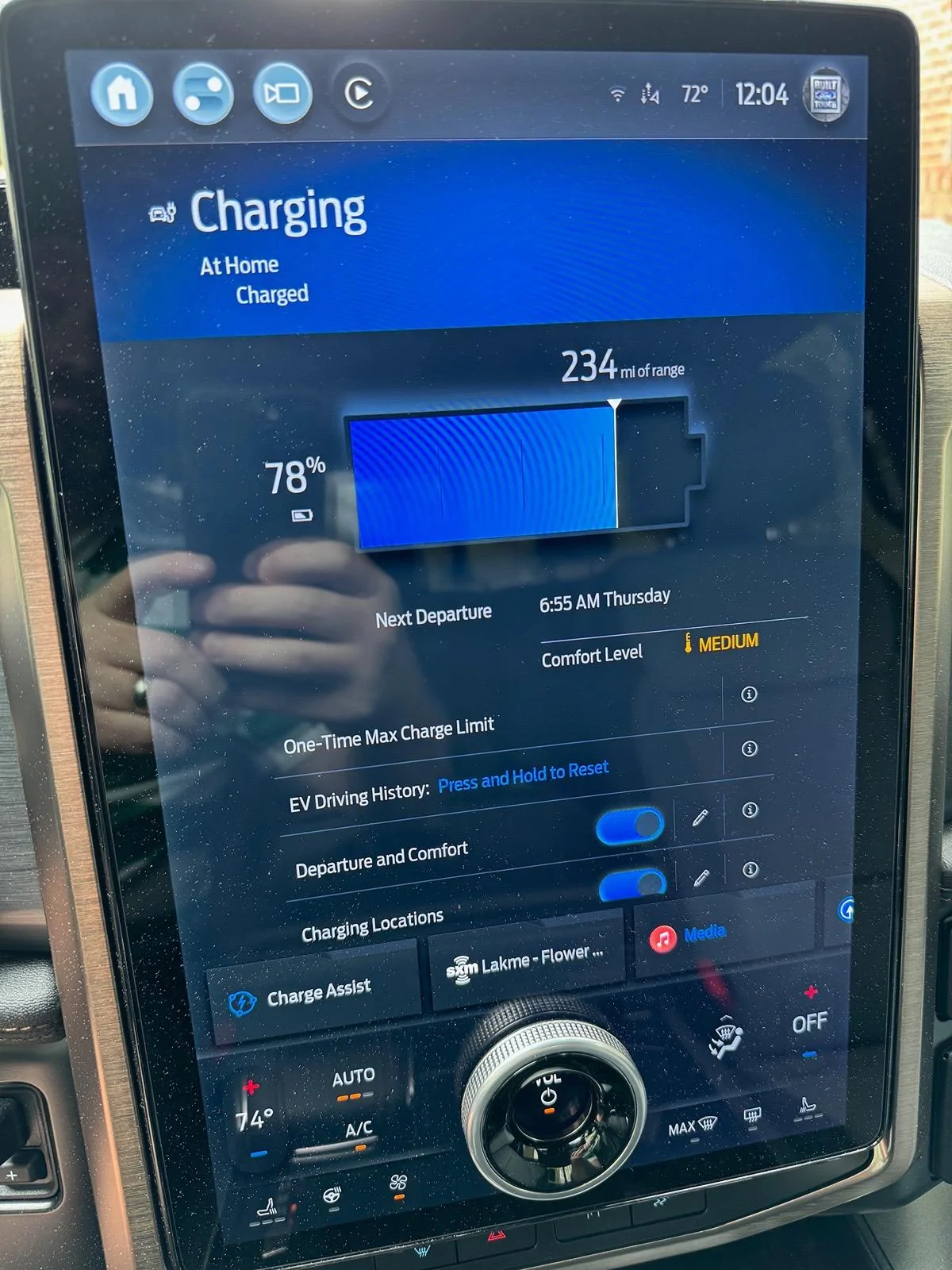

Nope, I haven't made any changes to the truck settings with respect to privacy, I can see all my charging stuff in the truck (see below). What I did notice is I now have the charge Assist app, not sure when that got installed as the last Ford PowerUp update I received was FordPass 6.8 and then a day or so later I got the Tesla Supercharger update, that was about 10 days ago no updates that I know of since then.

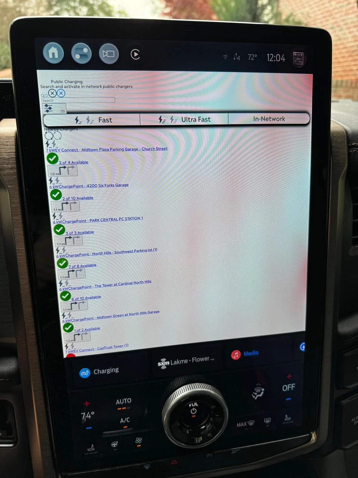

When I first opened the Charge Assist App it took 2-3 minutes to load (that's ok, guessing it was downloading initial database of chargers etc.) app looked normal but then after about 2 minutes screen flashes and the Charge Assist screen changed to the white unformatted (per Ford UI normality)! Definitely some bugs roaming here! Will give it a day or so to see if it fixes itself!
Anybody else ever seen the white charge assis screen below? All other apps and interface screens are "normal".
Ohh just to clarify, I shut down truck several times, exited locked it, came back and no change to charge assist screen still the same. I've also reset my phone, uninstalled and reinstalled the FordPass App several times.

So no idea how or why this resolved the issue. But deleting phone as a key resolved the FordPass issues where I couldn't see Preferred Charging or Depature Times post lasted FordPass update from the App Store.
I reenabled PAAK and still seems to be ok, I can see Departure Times and Preferred Changing times again.
Charge Assist is now also no longer stuck on white screen but it was stuck on the "loading" screen for 10+ minutes, needed to leave so shutdown the truck, but will check it later tonight!
