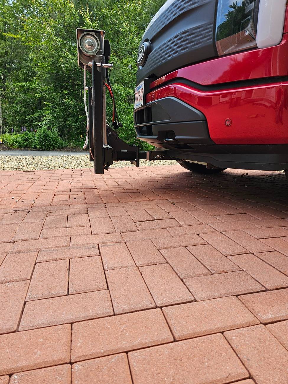

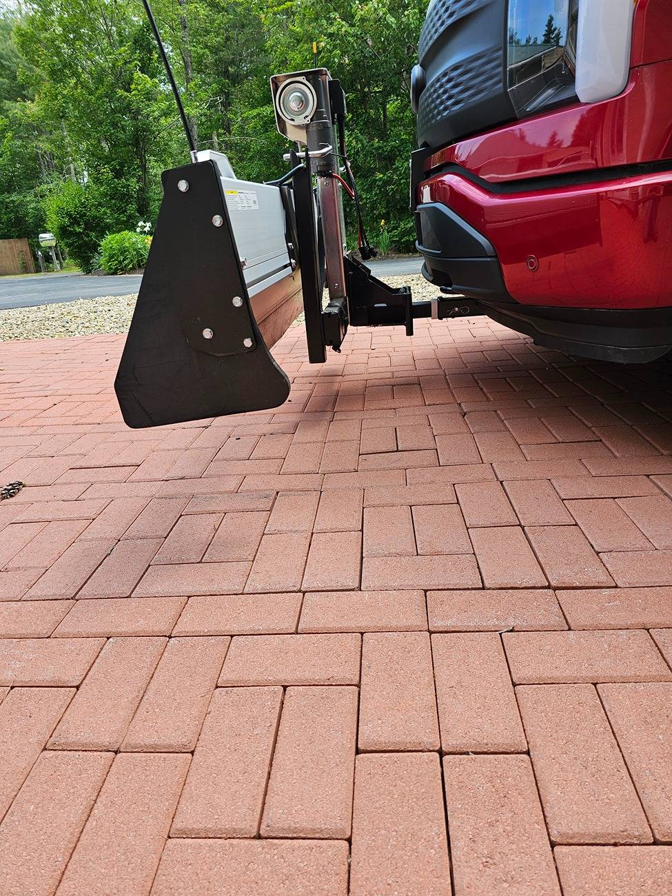

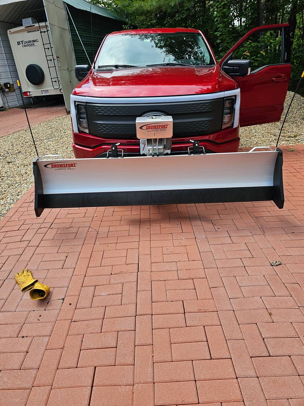

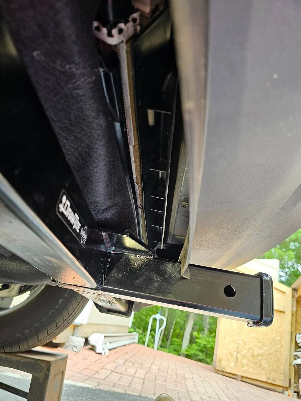

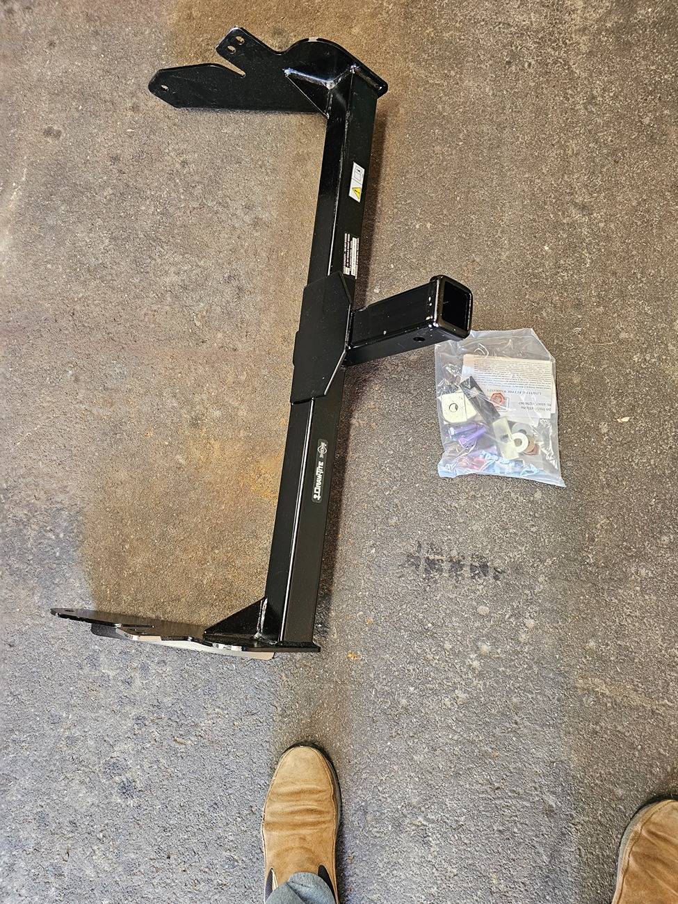

I finished the install of the draw Tite - 65067 receiver- currently the auto deploy air dam is removed, and I do not see any normal driving effects of it not being there for deployment at higher speeds. I do not do a lot of high speed driving. I cannot modify the dam to deploy around this receiver, but I am going to try to modify the dam to attach the actual receiver in the deployed position. It would involve cutting a center hole for the receiver part, and making a couple small brackets to bolt to the receiver crossbar. Sure it permanently reduces my clearance, but I do not drive this in off road or clearance limited places. Here are some pics of the production F150 Draw-Tite receiver installed. I have about 8" bottom receiver to ground front clearance. The hitch has a 500# tongue weight and 9000# capacity. and costs about $200_- from etrailer.com. When I received it, the shipping had banged it enough to make me have to do a little bit of sledge hammer enticing the end mount area about 1/2" wider. I figured that out by measuring where the mount steel is welded to the crossbar, and measuring the end width between the left and right side mount steel. The shipping had bent it about that 1/2" inch, but a couple smacks with a hand sledge hammer while it was stood up vertically widened it in about 6 bonks. then it slid right into place as shown. I like working with annealed steel - lol.

Power was simple- Snowsport winch to raise plow has 2 wires. Power (12V) and control switch wires. They are only long enough for a front mount and I had to extend them for my initial rear mount. Anyway the 12 V power cord went directly to the 12V battery and was bolted onto the normal battery terminals. The wire has a fuse in it. I was easily able to drop that wire down to the underside of the truck and zip tie it along the frame to the location I wanted in the front and back. The control switch wire was put up to the cab immediately behind the drivers seat through an existing rubber plugged hole. I did a small cut with a knife to allow that wire to be through that rubber floor seal and still keep the seal. I put it obviously under the rug to under the driver seat and mounted the up down switch on the left lower side seat rail so I could reach down and easily control the up and downs. The 12V battery is continually charged via the HV battery and has no issues with the winch draw. Even with the truck turned off on my 2024 the 12V is charged if I happen to raise or lower the plow while the truck is off assuming you are plugged in. If not plugged in the HV battery will automatically top off the 12V if needed.
