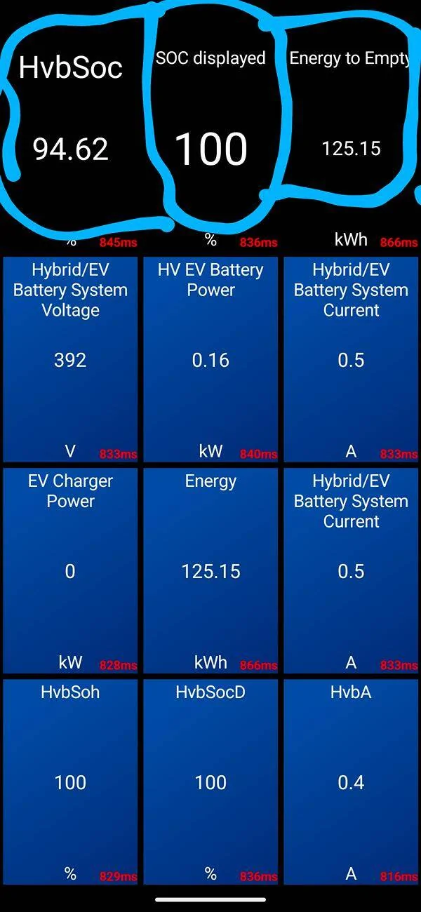

So I got a new 2024 lightning couple weeks ago. I was only charging up to 90% but always noticed on the range was well below what I expected by 10 or 15%. I know that's just an estimate but I would reset my My driving history and that wouldn't help the range go up at all. I was also driving around City so it was averaging 2.4 to 2.5 kW per hour.
I hooked up an OBD and fully charged my truck and only got a maximum of 125 of usable energy. I was expecting 131. It's only six off but that's still 4.5% or maybe 10+ miles on a road trip.
Do you guys get only 125kw? more or less?
I also noticed that the entire battery pack charged to 94%. I was expecting that to be around 92 if you divide 131/143
I have a Ford service appointment next week for a bed liner. Is this something I should bring up?

the ‘24s could still have a smaller battery pack if you divide 125.15 by 94.62% you get 132.26? Maybe with the single onboard charger they decided they didn’t need as much overhead? I am certainly no battery expert would be a question maybe @MickeyAO could answer?

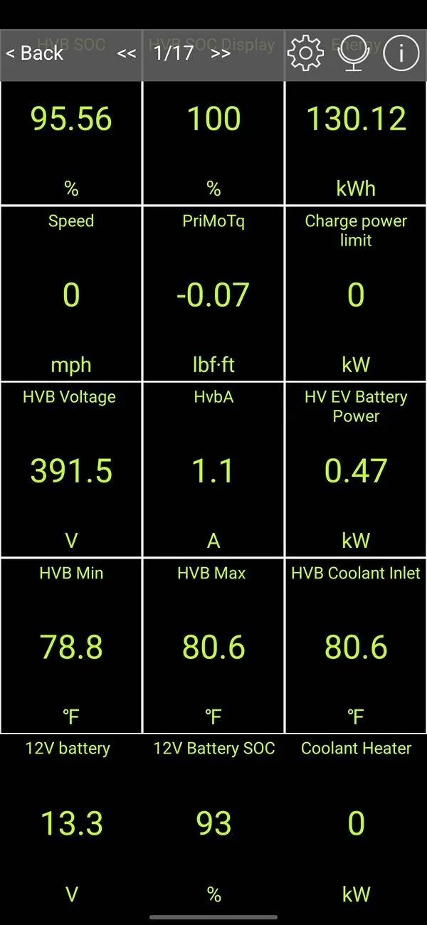

This is what I've typically been getting with my truck 23ER with Car Scanner. 122-127KwH at 100% SOC Display. Not sure how accurate it is though.

Did you mean 2.4mi to 2.5mi per kWh?
Even though you read this with an OBD device, it is still an estimate of the SOC.
There is a margin of error from any on-board SOC number.
The only way to really know the "actual" SOC of an EV battery, well a closer approximation, is a bench test and even then there is some smaller margin of error.
There are many ways to try to measure the SOC of a lithium-based battery some are more accurate than others.
1) Open Circuit Voltage method: the voltage at the terminals decreases or increases depending on the charge level - however Lithium-ion batteries have a much flatter discharge curve, which means that over a wide operating range, the voltage at the battery terminals changes very slightly which means less accuracy closer to full charge. The error is estimated to be 10% to 15%.
2) Coulomb counter method: tracking the state of charge when using the battery by follow the current integrating it during cell use - the integration gives the quantity of electrical charges injected or withdrawn from the battery making it possible to more precisely quantify the SoC of the battery. However, even though the current measurement is performed with a precision resistor, small measurement errors may occur, based on the sampling frequency. The error is generally estimated to be around 1%.
What you get from the OBD device or other scanner connected to the truck computer is what the truck says the battery SOC is based on whatever method the truck is using to estimate it.
So my advice it to just relax and enjoy not having to buy gasoline, and only get worried if the reported battery estimate falls into the battery warranty range.
