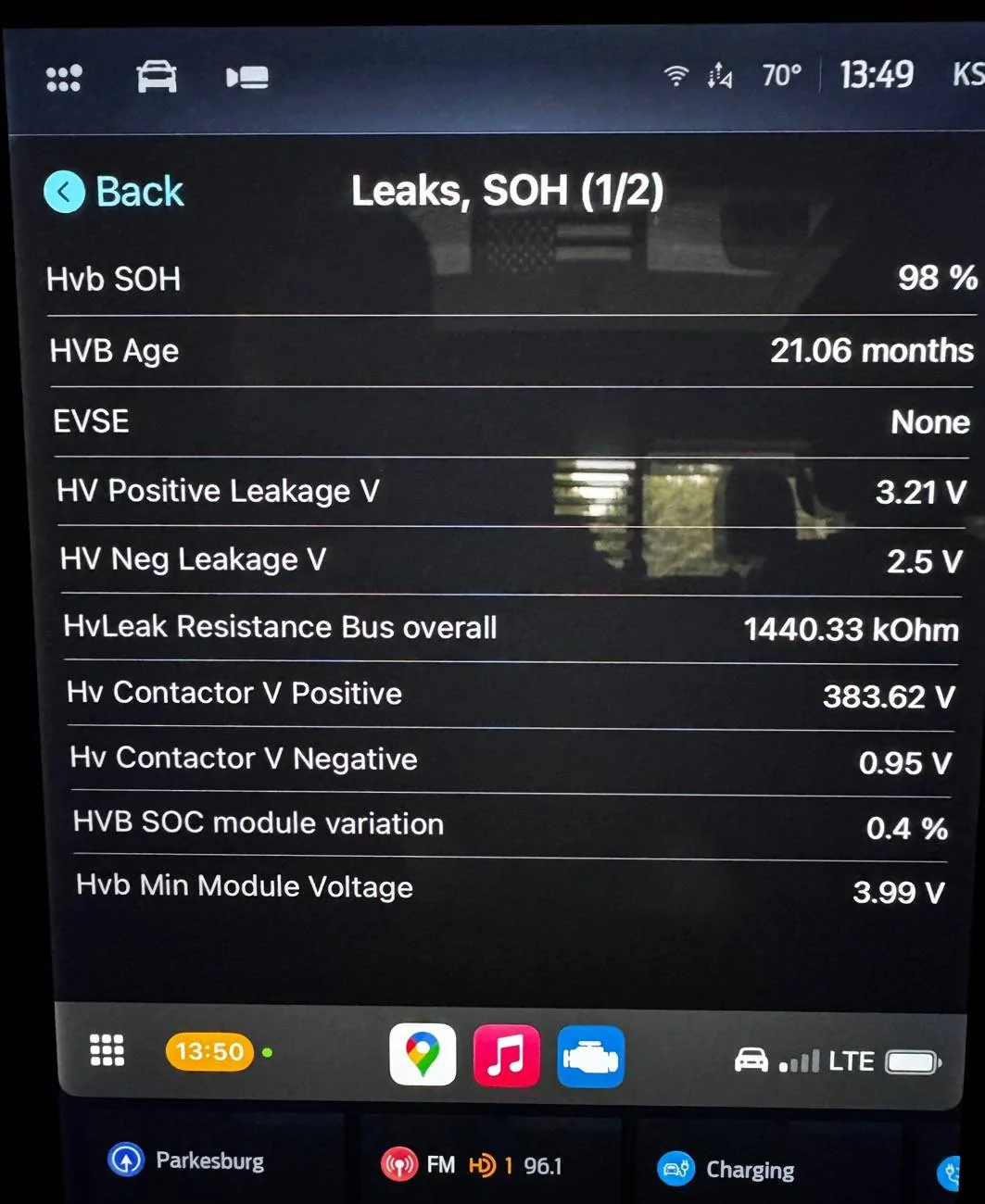

1 too have a 24 flash ER . But what obd app are you guys using as I want to buy 1 that displays all the info you're showing.
Is it Bluetooth to your phone. Is there anyway to show it on the 15" screen via the app? Or do we already have this feature and I haven't played with all the apps and settings?
Rick
The Veepak OBD adapter and the CarScanner app would allow you to display dashboards they have pre configured on the 15” screen, like this:
Ford F-150 Lightning Full charge but below 131 KW of usable power IMG_2485

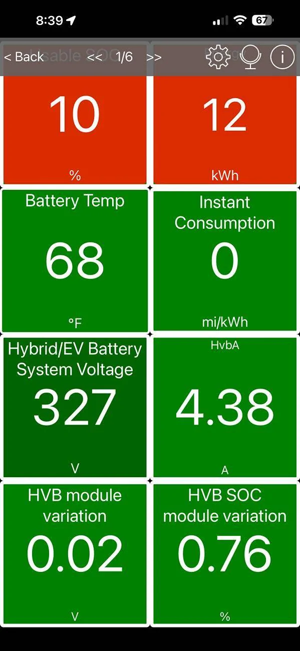

So drained the truck down to 10% dSOC that was showing 12 kWh in the tank.

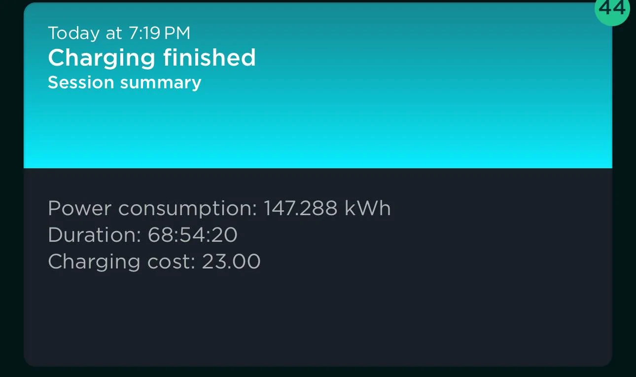

My charger said it was providing power for 68:54 and provided 147.288 kWh.
Ford F-150 Lightning Full charge but below 131 KW of usable power img_6937-jpeg
My FordPass notes shows 69 hours and the truck received 131.6 kWh of power over that time.

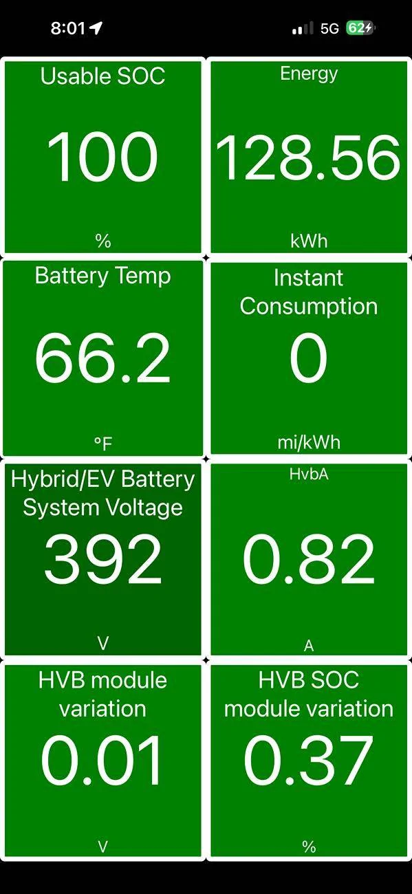

From Car Scanner the dSOC is showing 100%, shows only 128.56 kWh in the battery @ 66 deg F.

So wish it didn’t take as long to actually do it, but battery is closer to what I have seen in the past and “found” some of the previous lost kWh noted by me and others.

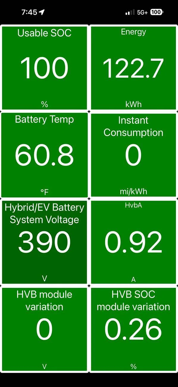

Definitely something going on with the BMS and some bs. Trying to drive the battery down and what should have been around 93% usable battery is still showing at 100%. seems @Ford Motor Company has a needed software fix in the future. ?‍♂

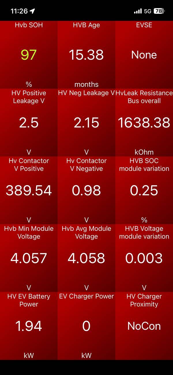

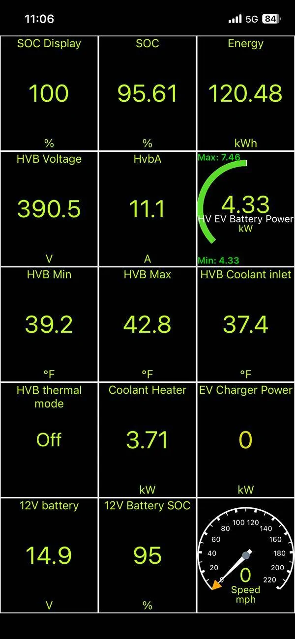

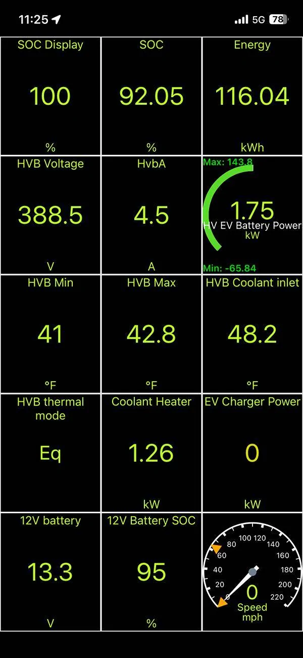

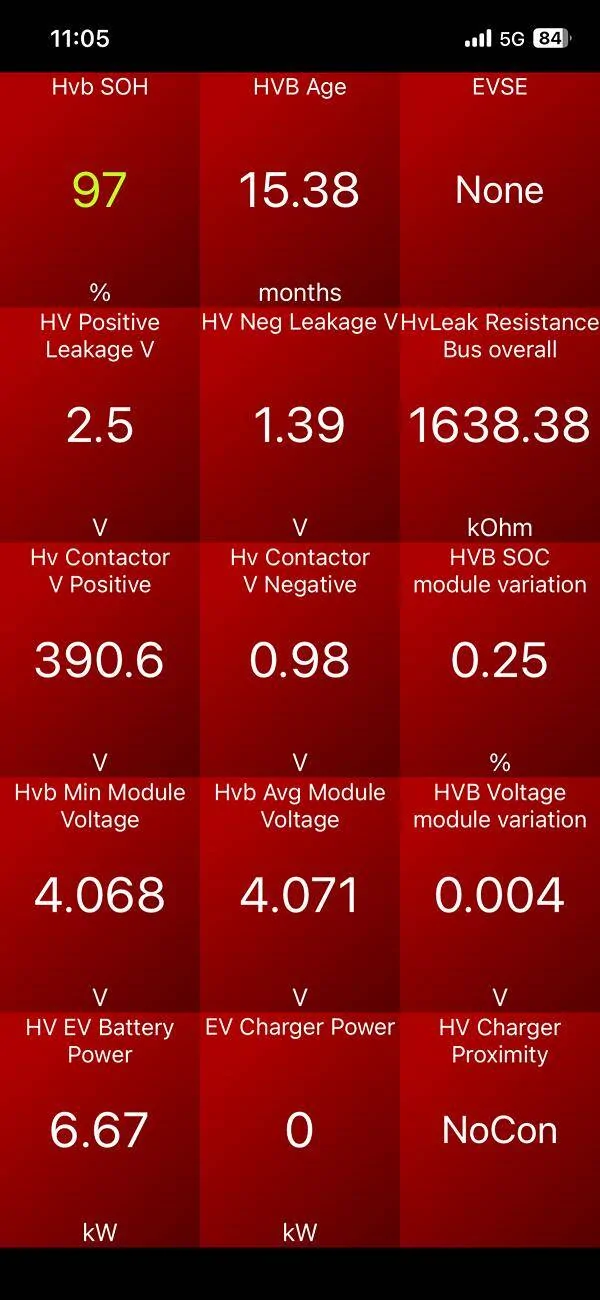

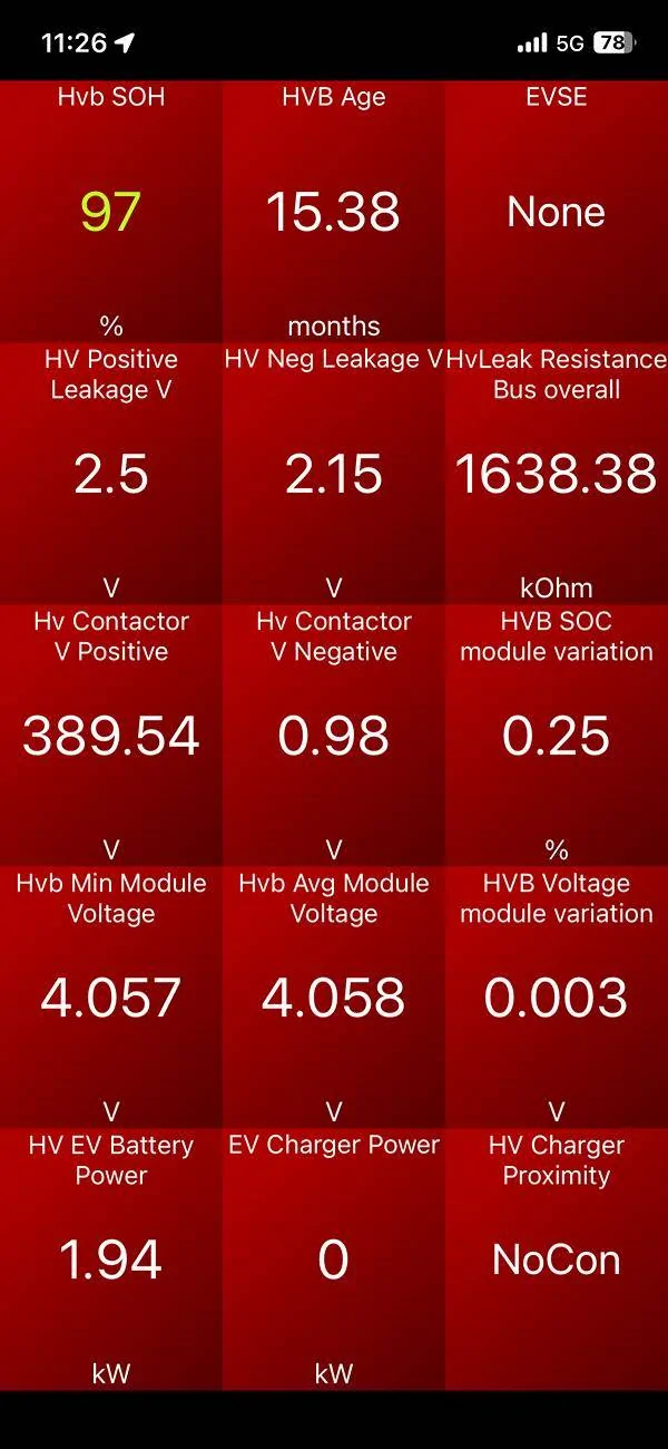

I’m experiencing this today after charging to 100% for the first time in a long while. I let it sit on my level 1 charger for 25 hours (yes it took 25 hours) to go from 97% to 100%. Then I hopped in to check things out in car scanner. It’s showing I only have 97% State of Health and 120.48kwh until empty. Display SOC is 100%. Then I took a drive for about 15 mins and the dash still says 100% but now car scanner says it’s 116.04 to empty. I cold started the truck in 37 F temps when I left. So I’m not sure what’s going on but it seems like some weird BMS stuff.
I expect your low capacity reading is caused mostly by the low temp. Like every other battery these lose capacity when cold. That's not cold, but it is still quite a ways off the 70-some degrees used when calculating nominal capacity.
Draining it down very low, and back to 100%, a few times, is also needed
That is exactly correct. If the battery is 37 degrees, you have a big hit to available energy. If the battery is 77 degrees, it's close to perfect.
@MountainAlive, set a departure point, and charge to 100%. When it's ready for departure, go read the energy. It will be around 60 degrees, and should read in the high 120s.
