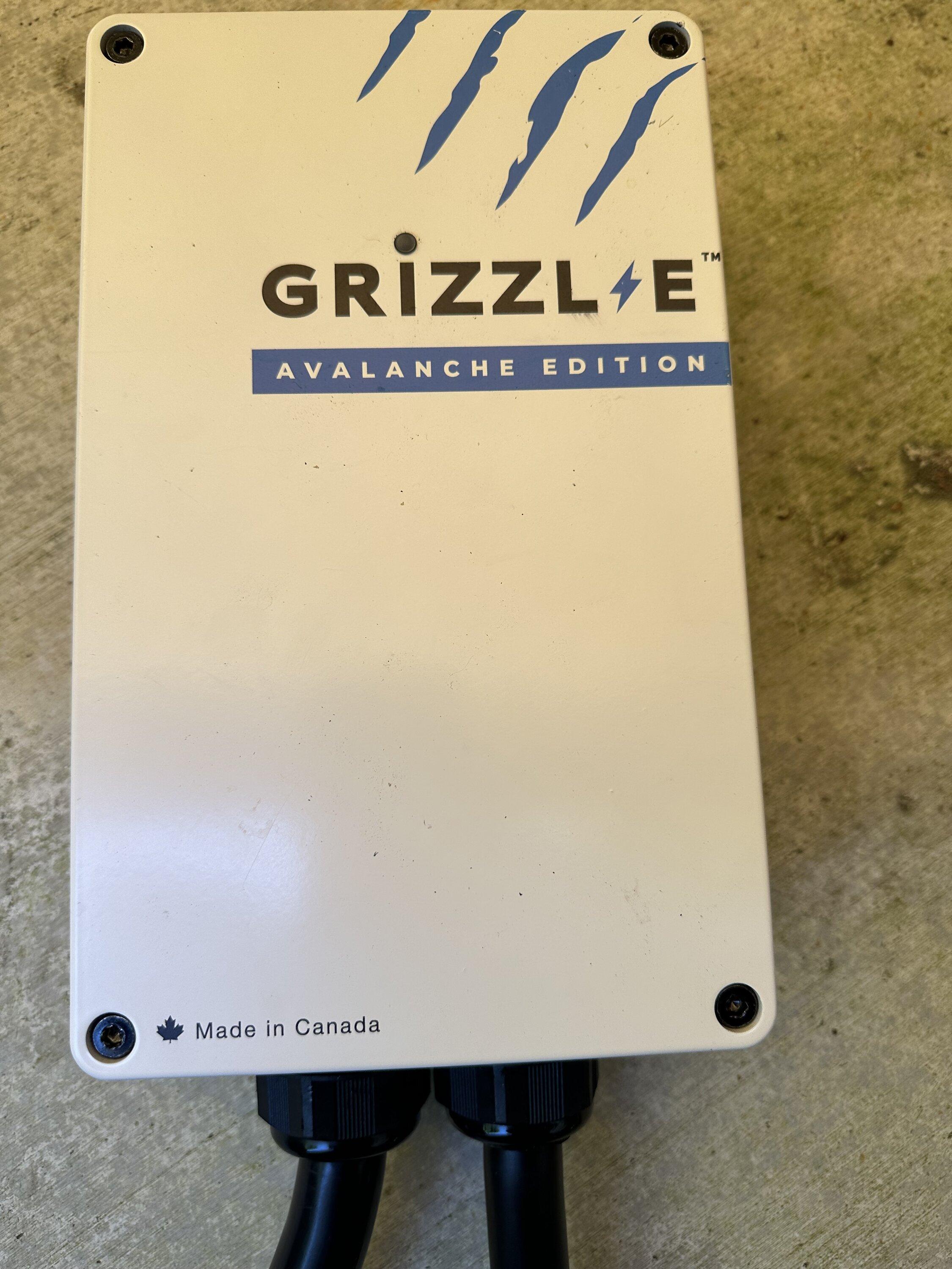

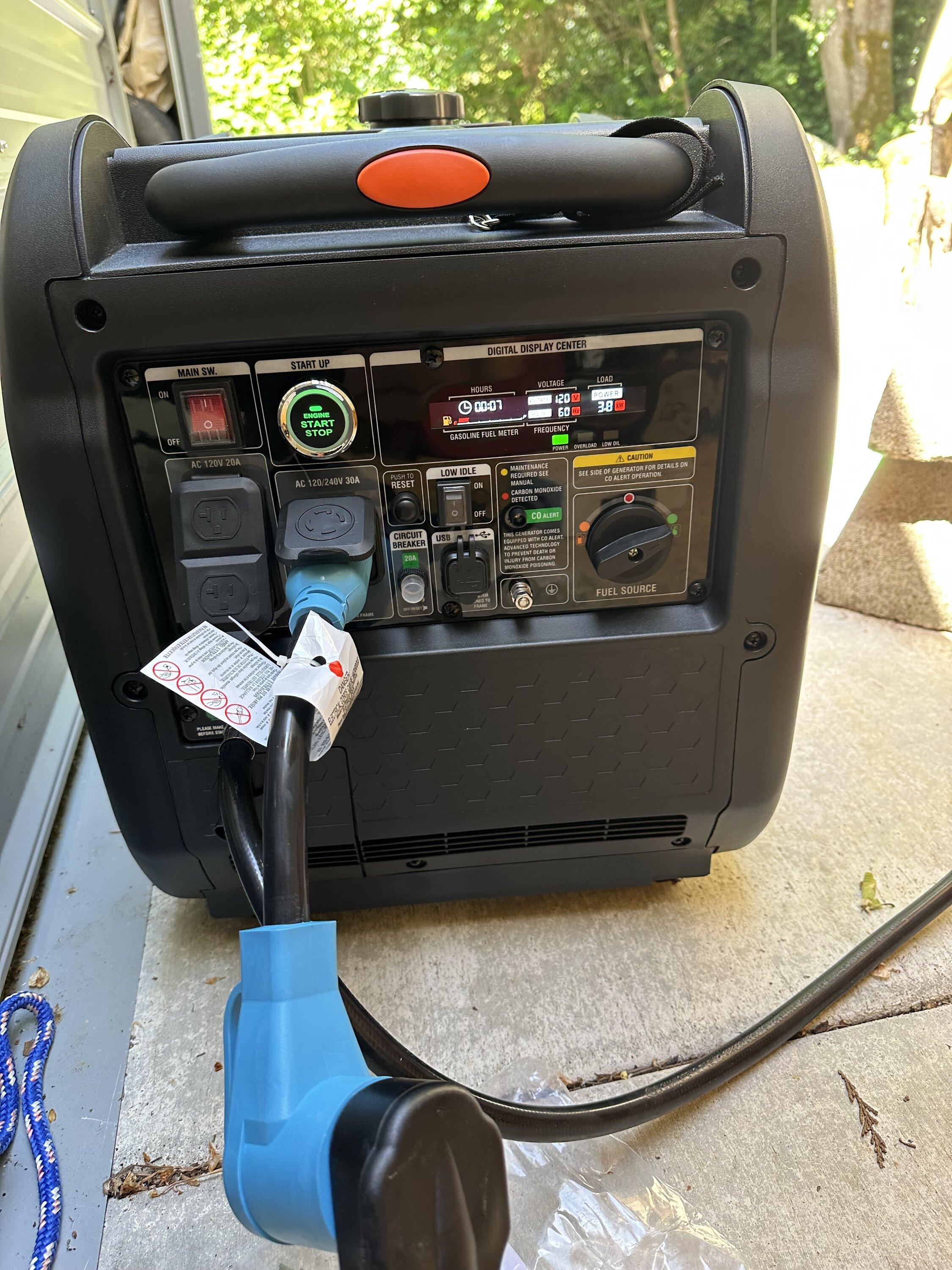

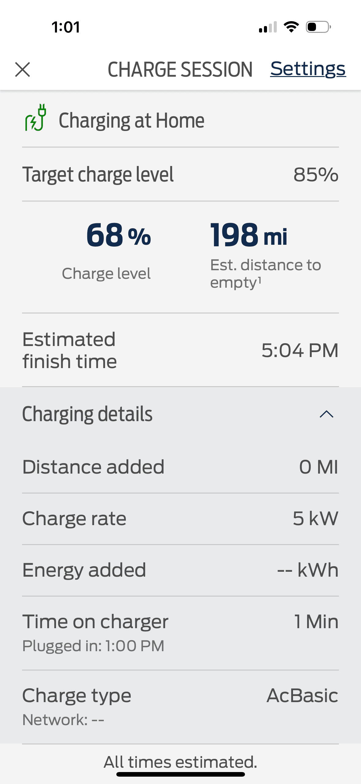

I have an inverter generator for my house backup that also charges the truck. It will run/charge on propane or gasoline. I also have grizzl-e charger that allows you to manually reduce rate that I use while at campgrounds that works with this set up. Details in the photos.

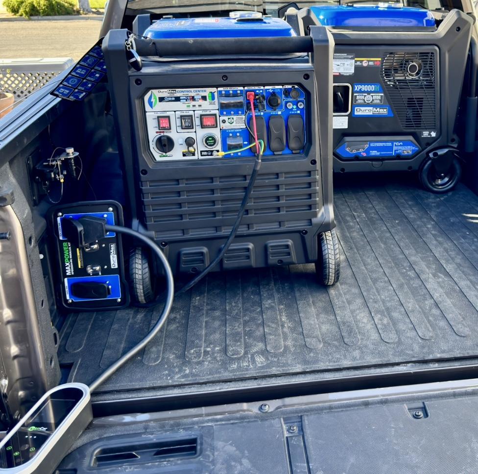

the best I found:
two in parallel Duromax ih9000.
they run on gasoline or propane and I moded them to also run on low pressure natural gas.

This is one of the few if not the only portable-sized and fully adjustable Level 2 charger.
This one lets you adjust the charge current from 6-40 amps in 1amp increments.
This is important so that you can match the impedance of your generator to an about 75% power load when charging the truck.
Ford F-150 Lightning Generator to charge truck 1704690659617

Thanks for the info, I was actually looking at those two model generators. I also need one that is dual fuel, so this is very helpful. I am curious though, why would you need to adjust the level 2 charger since the generator seems capable of providing full power to it? Does the Ford mobile charger pop the breaker on the Duromax 9000iH? Or are you just trying to tune the load to get to 75%?
F-150Evolved
C
Jan 20, 2023
US
F-150 Lightning
No issue pulling 40 amps running in parallel on gasoline.
Having the ability to de-rate your charge current is great because it gives you flexibility and redundancy. If for example, a generator goes down or you’re pulling power from a 50amp camp ground outlet backed by a 30 am breaker your not dead in the water.
Also, if you’re running the ih9000’s on propane, you might want to derate to 35 amps. This could also happen if it’s too cold and the propane tanks freeze.
