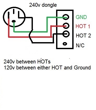

The Ford Mobile Power Cord does not need or use the neutral in the 240V mode with the 240V dongle. I tested the wiring on mine and drew the picture below:
Ford F-150 Lightning Great information regarding using a NEMA 6-50 for charging Mobile Power Cord-240v dongle-2
