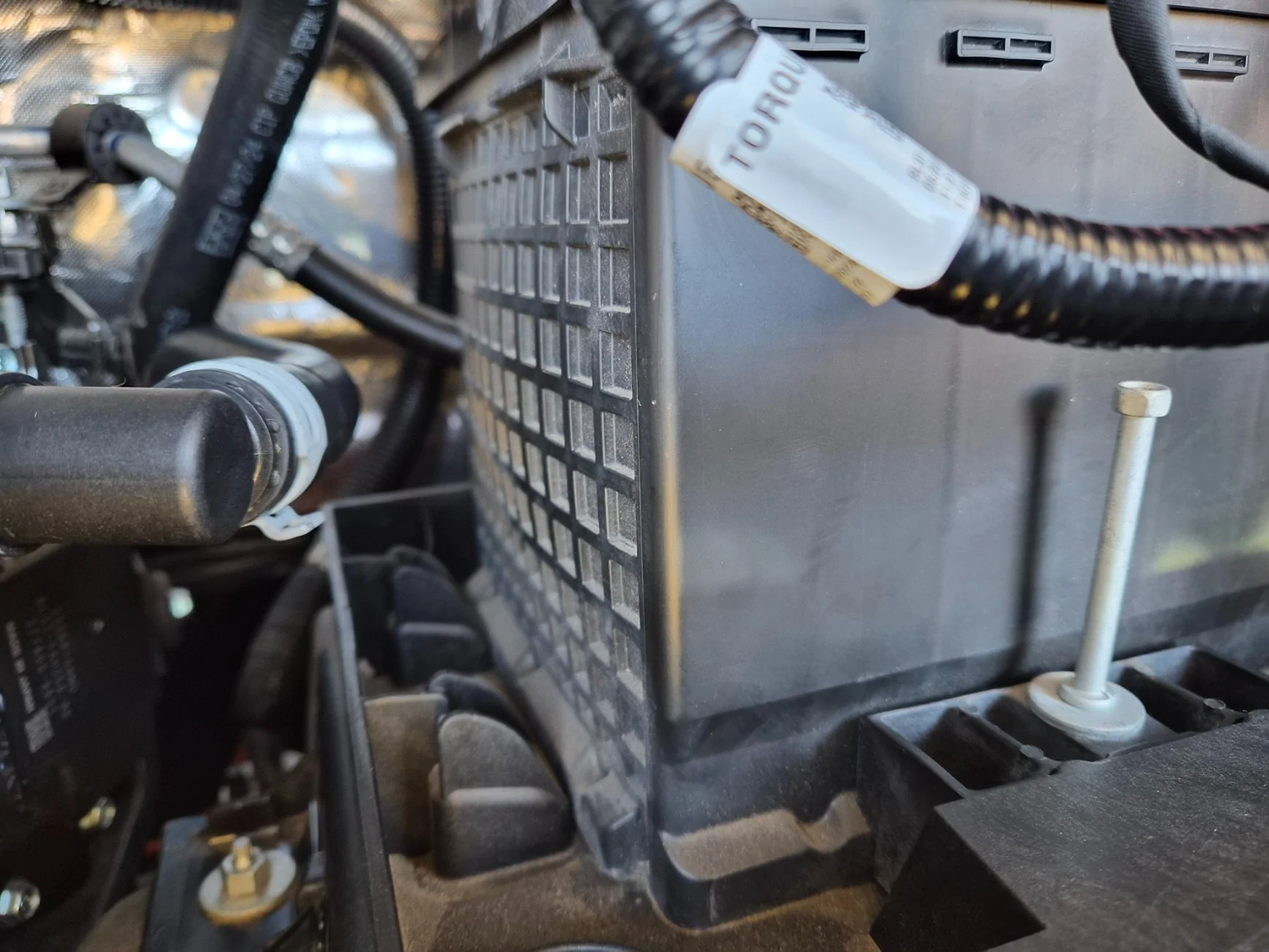

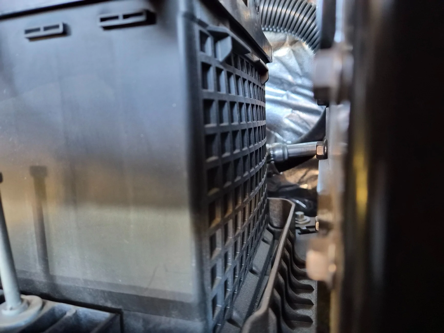

Here's a couple photos of my battery. It almost looks like the new one from Mike's photo.

It is strange that the batteries seem to have a curve to the case brand new...I should go crawl into my frunk and look at mine too....
Well mine has that slight bend in the case as well, I'll be!
Doesn't look to serious to me, barely noticeable really.

If it is just a slight bend like that, I guess it's the design and not a battery swelling issue.
If the battery isn't getting hot, or out-gassing rotten egg smells, then probably not a problem with the battery maintainer overcharging it.
Just look out for weird error messages from the truck that seem to accompany 12v battery failures and keep your fingers crossed.
