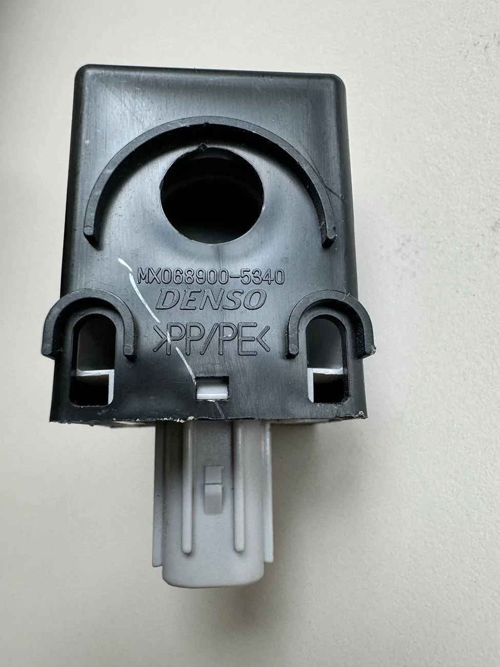

The sounder unit is made by Denso. Not sure what the Ford part number is.

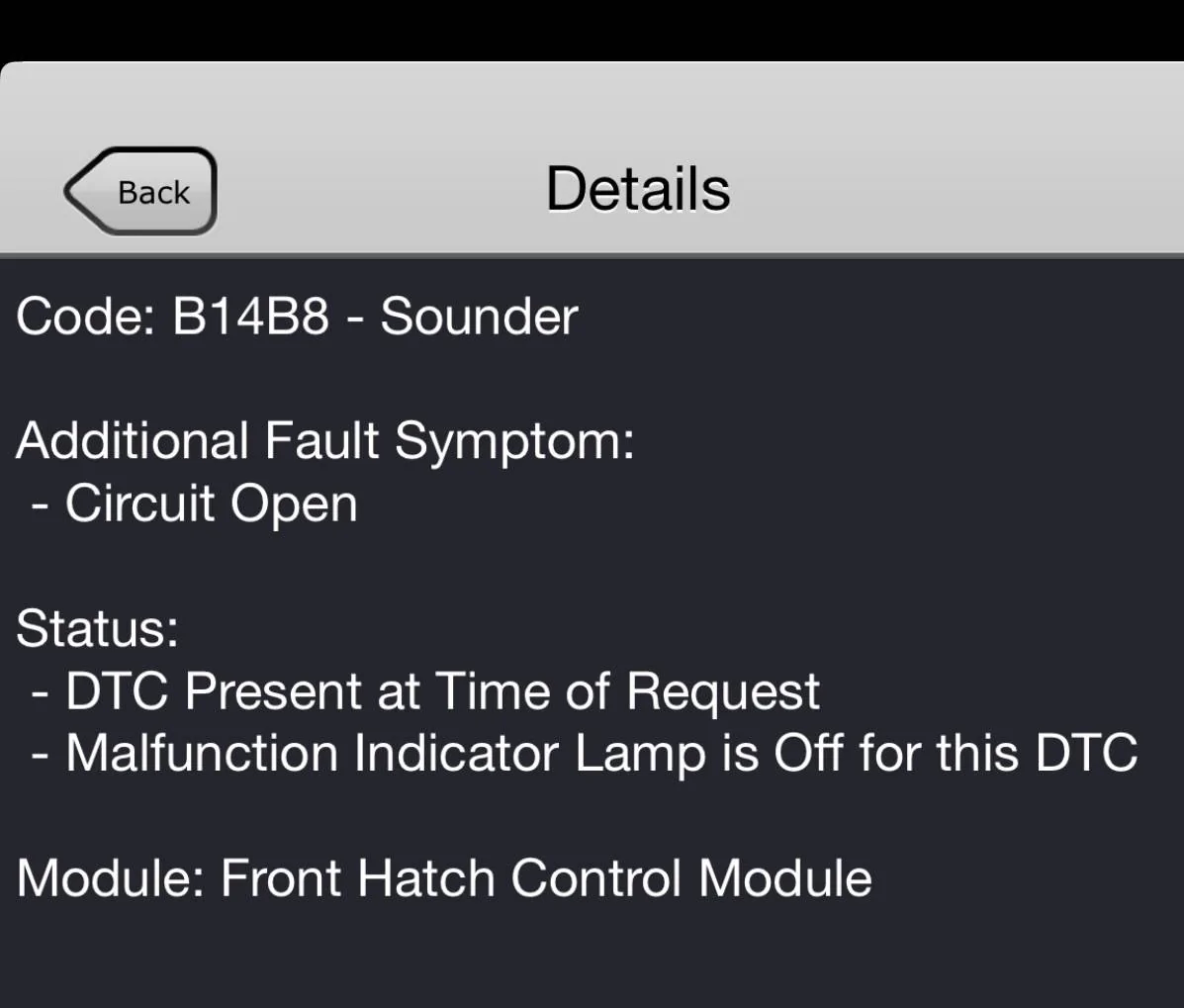

Also, if the frunk sounder is missing it should throw an error code. The Check engine light may not be lit.
Here is photo of a sounder unit after it is unplugged, and the code it would throw if not installed.

I removed my frunk beeper and haven't had any issues. It doesn't throw a dash light. The backup beeper does throw a code, you need to put a resister or megohm bypass kit in when you remove it.
