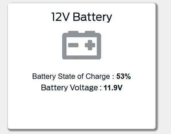

I tried with a jump start though and still no dice. That should have given me plenty of voltage to engage the HV battery.
Also, 4.5 hours now and still no tow....

Oh the 12v isn't the problem, it's a symptom.
And you can get reimbursed for a tow if you need to

Dealer has diagnosed it as a bad BECM. Good news is it is fully covered by warranty.

Alas - They replaced the BECM module, but that didn't fix the issue. Now they say it is a "fuse" in the high voltage battery - negative terminal - I read that as the HVBJB (maybe I am wrong), but I don't have an updated timeline yet.
